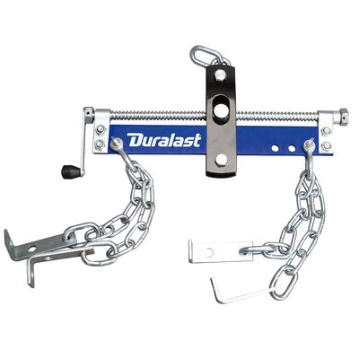

Do you have the engine attached to one of those levelling gizmos?
- Eric

Eric no I don't. Is it too late to? Are you referring to those bars that spread the chains?

Things like this:
http://www.harborfreight.com/3-4-qua...ler-67441.html
and this:
http://www.autozone.com/engine-and-v...?checkfit=true
- Eric

Do you think a 6x6 Wedged between the chains and adjusted up or down along the chain would work as a poor mans leveler? Thanks!
Chris
Old Sep 16, 2016 | 07:10 PM
MDchanic's Avatar
Connoisseur d'Junque
Joined: Sep 2010
Posts: 21,183
From: The Hudson Valley
You could try it, but I don't have a good feeling about it.
I think you'll be much happier with the right part, which you can adjust on the fly as you maneuver the engine...
... And walk away from it with all of your fingers.
- Eric
