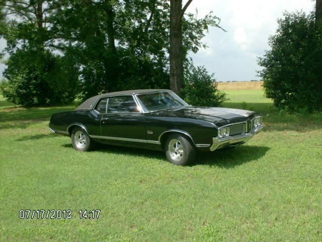

The car in question
Hope it's OK I moved my engine issues here from the newbie thread.
For those that may have not seen my intro here's what's happening. I got my '70 350 hot a couple summers ago (my fault) and since then the engine has pushed coolant out the overflow. When the engine is cold and running I can see a small stream of bubbles in the coolant. The cooling system will stabilize but maybe be 4" down from the filler neck. 16# cap, btw. Plugs look good. 100k on the engine (original). The car runs fine and drives great but I believe I compromised a head gasket.
Today, I got everything in place and took a compression test. Results: LB, 166,165,166,160. RB, 176,169,150,155. Leads me to believe blown head gasket in #5/6 cylinder area.
Current plan is to pull the top end, get the heads pressure checked for cracks and go from there. Anyone see anything I'm missing?
Thanks for looking.
