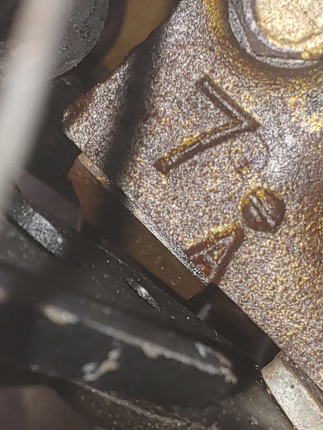

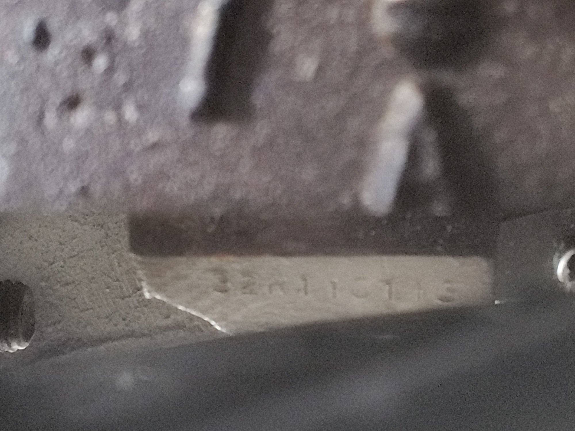

Post the number.cast next to the oil fill tube and the stamped number on the block below the #1 spark plug where the block meets the cylinder head.

The oil fill tube and heads can be swapped. The only foolproof way to know the year of the block is to look at the VIN derivative stamp. The second character of that stamp is the model year of the block. The "0" in this VIN derivative indicates the 1970 model year.

From what I gather I have a block from a 72...

Yup. 1972 motor from the Arlington, TX assembly plant.
