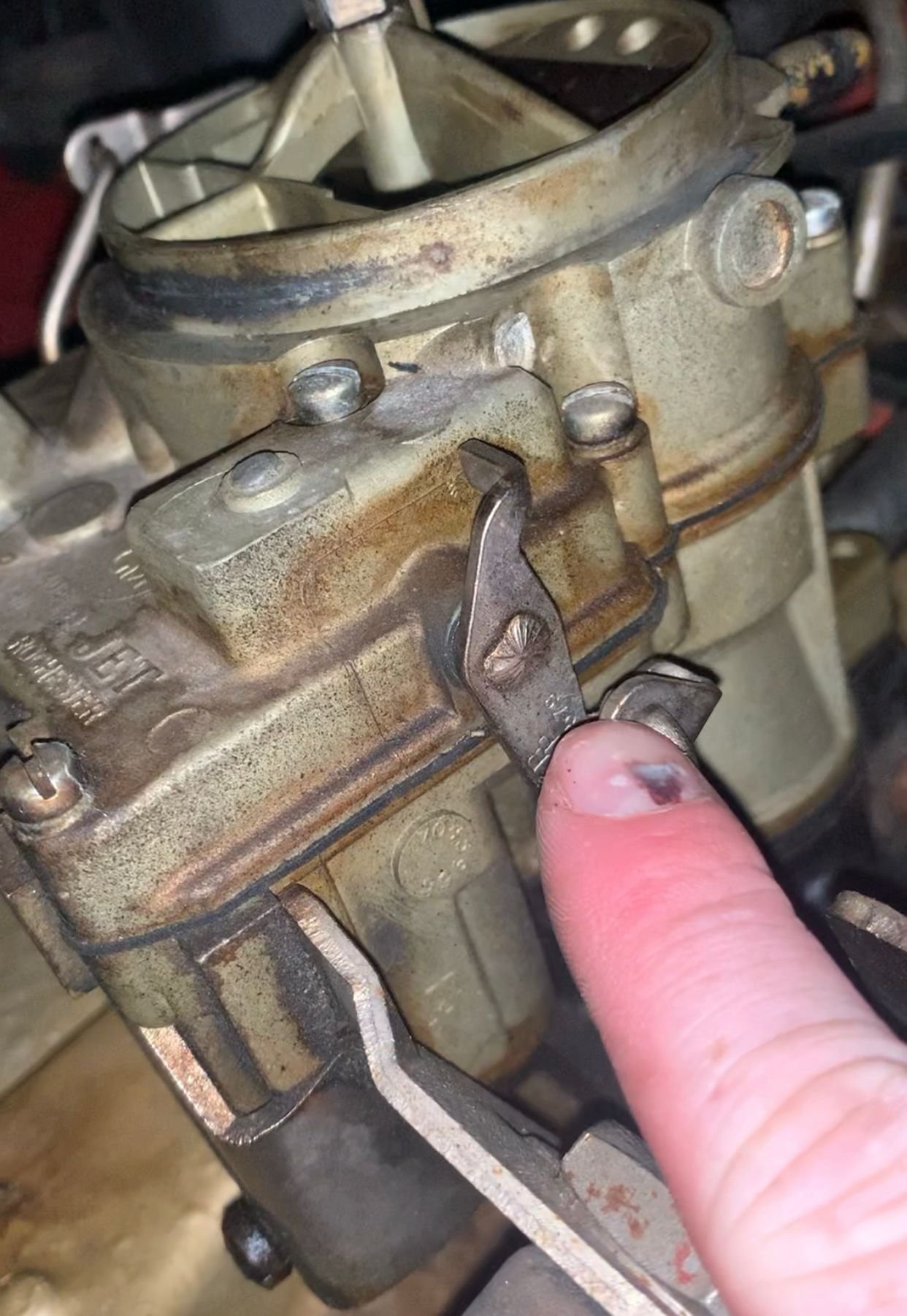

Also I’ll include a picture of said carb.

OK, so this was driving me up the wall so I went down to the garage to check everything out.
for throttle cable unhooked from the carburetor is smooth as can be. Forward and backward it operates fine.
The pivoting piece on the carburetor is also smooth and not binding.
what is binding and beyond belief is this pivot in the picture below. This one thing has all of the resistance.
Old May 17, 2021 | 07:58 PM
Posts: 42,505
That is the pump lever, I'm going to assume its the accelerator pump that's giving you your issue.

The accelerator pump cup may have inverted/sealing edged rolled over.

The good news is it sounds as if a simple carb rebuild will cure your issue.
Old May 18, 2021 | 04:05 AM
Posts: 50,815
Yup, that's the lever that operates the accelerator pump, so both your issues are tied to that one problem. Easy fix with a rebuild.
