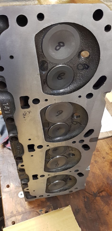

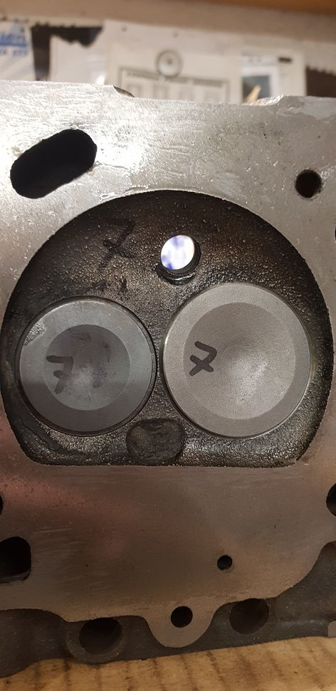

Today, i picked up the heads from the shop.
they have been surfaced, new cast iron valve guides have been installed and 2.000 intake valves have been installed. They said they had to surface just minimal, because the head have been nearly perfectly straight.
at first, i wanted not to touch the old valve guides, but the shop said for the machining of the valve seats, they had no guide for the machining tool which fits right in the valve guides, because they have been worn out too much for the guide.
here are some pictures:
I guess, now its time for a little bowl blending on the intake valves. My thinking is just to smooth the edge under the valves out a bit, since i dont want nothing too fancy (like other perfect hand ported bowls ive seen in this forum, which is always very impressive to see), because its just a nice weather street car.
Im just thinking about making a clip out of iron to "fill" the center exhaust port divider. No filling of the heat riser with molten aluminium, just because im afraid of cracks in the head casting and i like to drive the car on cold autumn days
thanks for some opinions!

Nice work. That lip near the fresh valve seat is why most guys get the machine shop to use a cutter under the valve to remove that lip. It means less hand blending, be careful near the valve seat. If the guides were worn as you stated, good idea to replace them. Were the exhaust guides done or just the intake side? Glad to see it going together.

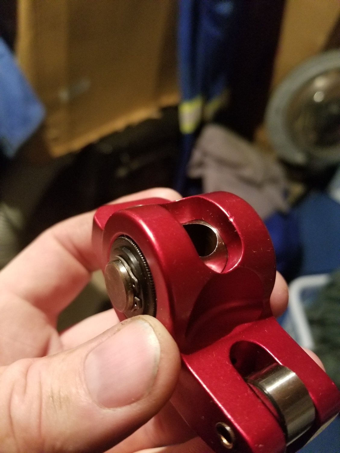

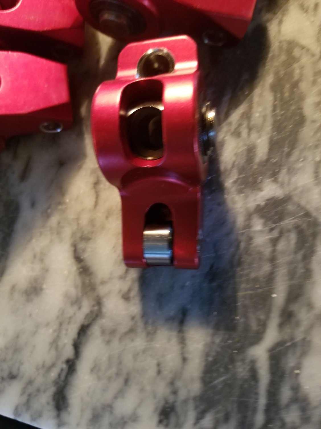

Yeah, i red about that its possible to open the bowls with a cutter. I decided to blend the bowls by myself and think it went well.
Now, i have a few questions about valve spring installed height. The springs im going to (re)use are Lunati 73126 (chart says103 lbs. Seat load @ 1.800 installed height).
These springs were installed in the heads as i purchased the engine.
I ran them with my Lunati cam (Advertised Duration (Int/Exh): 272/276 ;Duration @ .050 (Int/Exh): 217/221 ;Gross Valve Lift (Int/Exh): .485/.485 ;LSA/ICL: 10/104 ;Valve Lash (Int/Exh): Hyd/Hyd ;RPM Range: Idle-5500) the whole last year without problems. My cam card suggests different springs than these, but i have called lunati then, and they said that it will work fine.
these springs are listed with 1.800 installed height. before i had the new 2.000 intake valves and new exhaust valves installed, they were installed with 1.500 OD 0.030 shims under them.
now, with the new valves, i measured the distance between spring pocket and spring retainer for installed height with a digital caliper and a small straight edge as accurate i can, and i found that all the new exhaust valves measurings are approximately .010 over 1.800, and all of the new intake valves are slightly under 1.800.
I would like to have the intake valve measuring a bit over 1.800 too, because i want to install shims under them to save the heads from chewing of the damper spring and if i would install even a .015 shim on the intake valves, it would be out of the installed height tolerance of lunati claimed +/- 0.020.
i guess i will get the machine shop to work the intake valves slightly deeper in the seats to get closer to the exhaust valves installed height measurings to make shimming possible.
what i found too is, that 1.500 OD shims are slightly too wide for the (original) spring pockets of the 7a heads. It seems like they are lying on the corner chamfer of the spring pockets. The 1.500 OD springs are lying flat in there. Is it ok to use for example 1.480 OD shims with 1.500 OD springs?
Sorry for the long text, I hope I was able to explain my thoughts understandable😃
Thanks a lot for some expertise in this topic!

I would not have them sink the valves any more. Depending on what rockers you are using there are valve locks that will give you an additional .050 hgt and then you can shim accordingly. Personally I would not worry about it much. Those springs dont have a lot of pressure anyway and .020 or so less hgt wont hurt a thing.
Your method of checking hgt might not be that accurate either. Try the method in my picture below. Cut a piece of coat hanger wire a little long and then grind the end a bit at a time until you can just squeeze it under the retainer. Then measure your wire with the calipers. Make sure it is straight in line with the valve. This method works great on stock heads with small springs where you cannot get a hgt mike in to measure.
Make sure you pull up on the retainer to seat it real good on the keepers. Either that or what I usually do is let it drop down to the valve guide and smack it lightly with a small hammer. You will be amazed at how much hgt you will gain just seating the locks.

As far as the shims go the slightly smaller shims should be fine. If you look at most retainers they rarely go out to the edge of the spring.

#1: today i checked all springs on a drill press with a precicion parcel scale like ive seen in a youtube video. Adjusted 1.800 on a caliper and compressed the springs on the scale to that measurement. I got around 47 kg on every spring at 1.800, which is about 103.6 lbs., so i guess this is fine.
#2: yes, i thought about grinding a bit off the shims to fit them properly in the pockets.

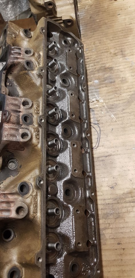

Here are a few pictures of the assembled heads:

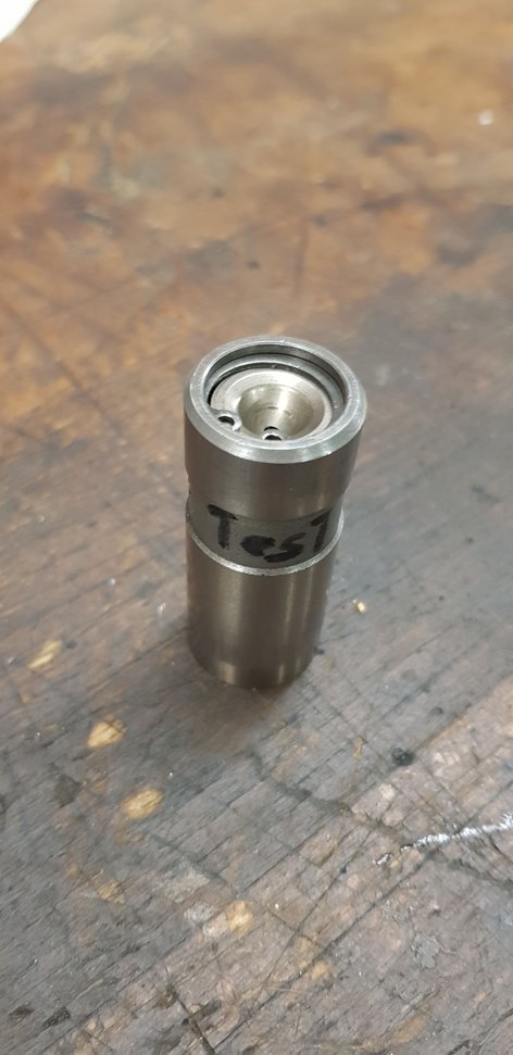

now, im getting closer to determine my pushrod lenght. This is the first time im doing this and unfortunately i have no test valve springs.
The rods which have been installed when i purchased the engine are measured from tip to tip a bit longer than 8.400, so i guess their scripted lenght is 8.400 (because of the radius of the ball tips).
I have my old lunati lifters here and im going to use these in the new build too, so i decided to stack one of them with washers till the plunger is touching the snap ring, like if the lifter has oil pressure to make some kind of solid test lifter:
Then, i tested #1 intake valve with a 8.400 pushrod. painted the valve stem tip with a marker, set poly lock to zero lash and turned the engine 3 times over, this was the result:
For me, this looks like those pushrods are too long. Maybe in the further engine theyre have been right, but i guess, since i had heads and deck surfaced theyre too long now.
Then, just for trying, i adjusted my trick-flow lenght checker a bit shorter and got this pattern (the lenght checker is strong enough to handle my valve springs):
i think this looks much better. I measured the lenght checker the same way as i got 8.400 on the old pushrods and got something like 8.260.
What worries me a bit is, that if i would like to go more shorter than that, my comp roller tip rockers would be close to interfering/grinding with the bottom of the rocker studs (ARP 7/16 to 3/8-24).
i apologie that my lenght measurements are a bit guess work, but this is the first time im doing this and i always have to calculate from metric to inches when i measure something and sometimes this is a bit confusing when growing up and working the whole life with the metric system .
thanks for any thoughts about this topic!
Edit:
My rocker pads arent milled and im using comp 4842 guide plates and the "tulip shaped" ARP 5/16 to 3/8-24 rocker studs. Depending from what i tried, i would need pushrods from around 8.250 to 8.300 for a good pattern, but its true, its not possible to go shorter than 8.350 without bottoming out the comp roller tip rocker arm on the tulip shape of the rocker stud due to its large body.
Are, for example harland sharp 5016 or equivalent rocker arms giving more room to the rocker arm stud? I wouldnt feel very comfortable to grind on the rocker arms for some clearance.
If its possible, i would like to avoid pulling the heads again to mill the rocke pads down.
Thanks for any advice!

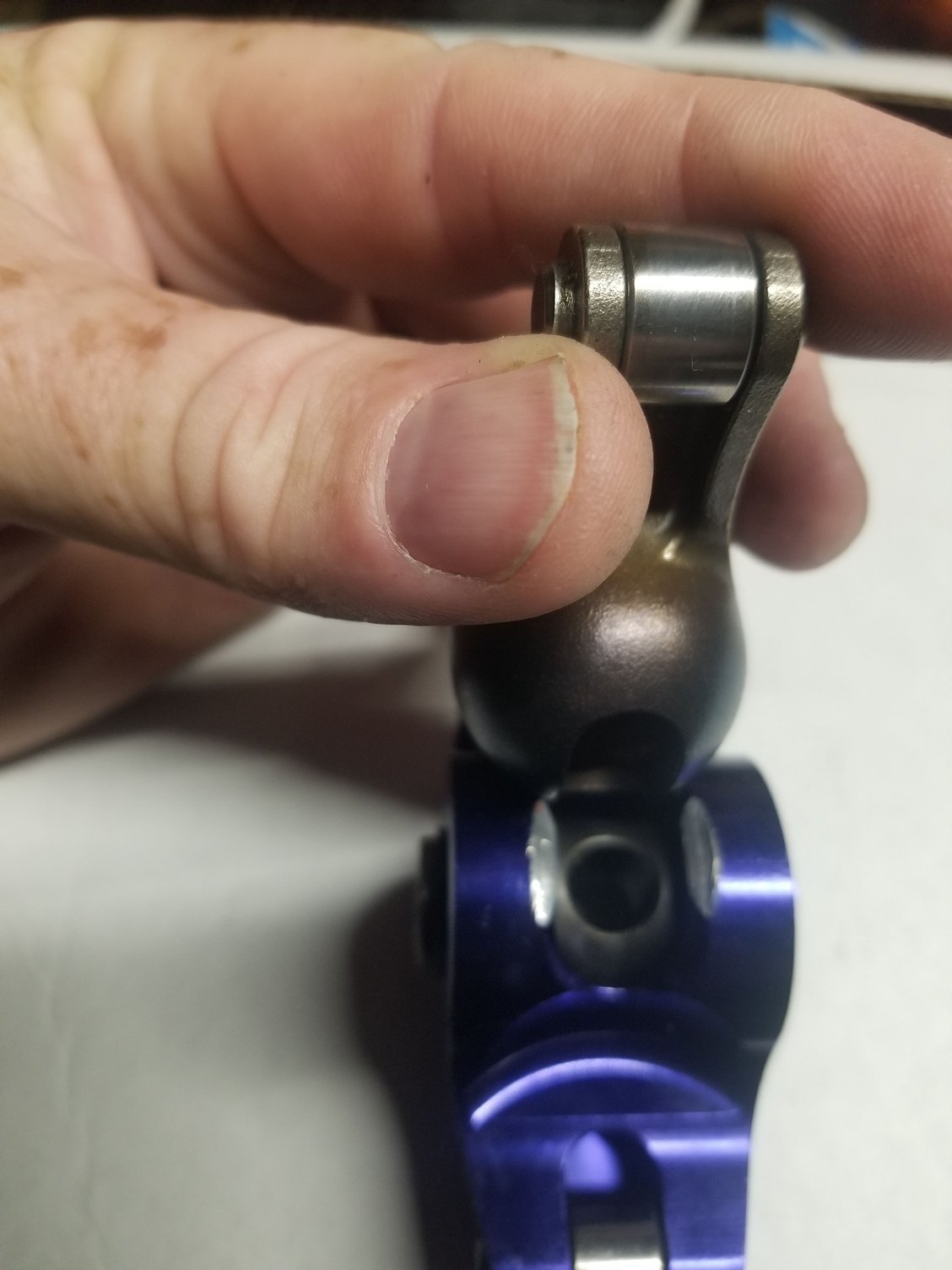

Here is the Harland Sharp and others true roller rocker base.
Old Apr 21, 2022 | 11:42 AM
  #155
71OldscutlassS's Avatar
Joined: May 2018
Posts: 430
Thanks for the picture, its just difficult to see from a picture if their body goes less far down than on the comp rockers. Maybe someone has both for comparison.

I have Harland Sharp and Comp roller tips like yours, along with Scorpion true roller rockers. I will get some pics.
That would be great! Thank you!

Top two use a 3/8" stud and the bottom is 7/16". The true roller rocker body is wider at the stud.

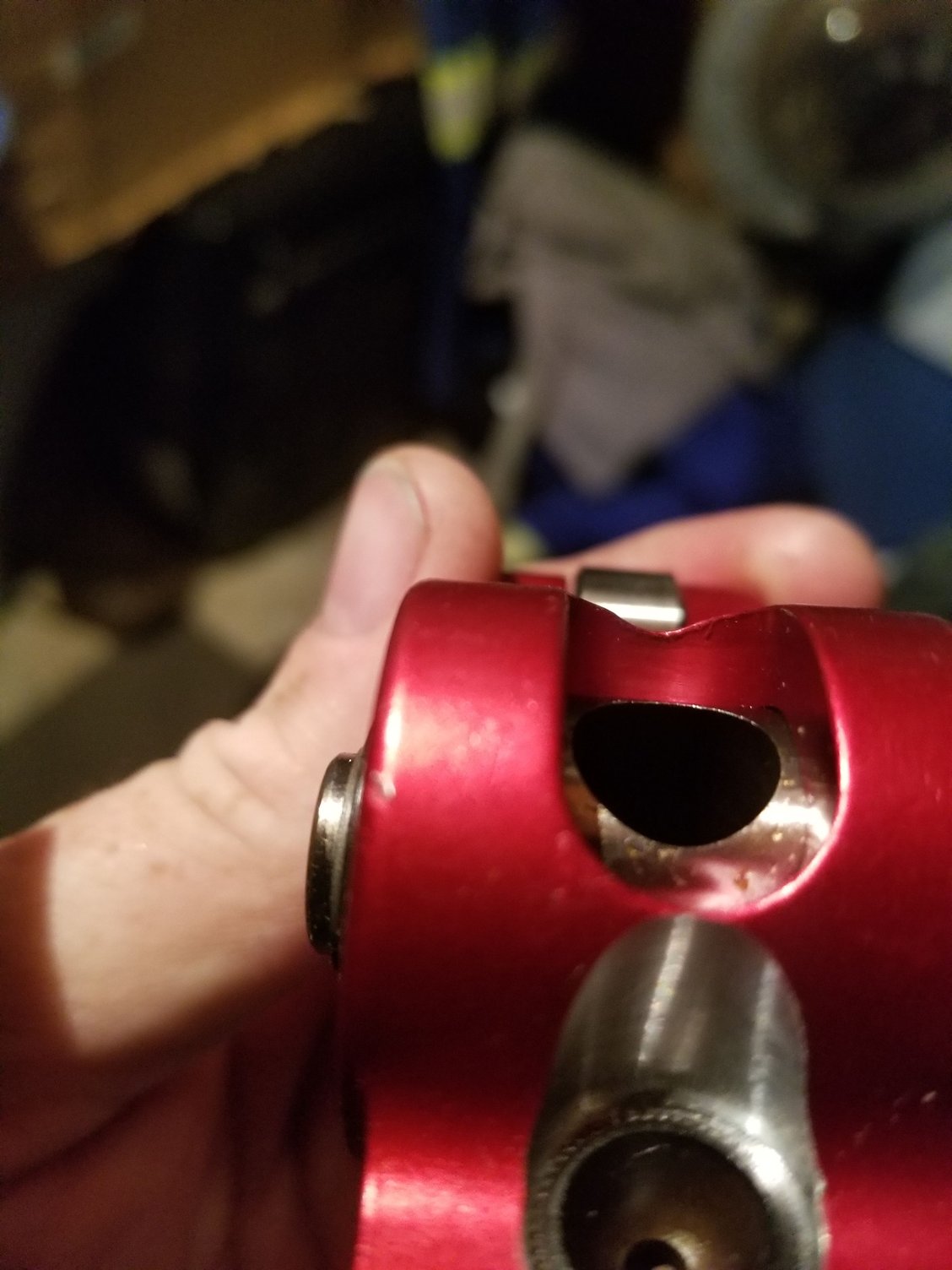

Thanks for the pictures! Have you had the same problem like me with the blue rockers? (grinded some material off?) But, if the body is wider at the stud, it could work for me.
My plan was to keep the comp guide plates and the arp 5/16 to 3/8 studs for maybe using with true roller rockers. I already have the short poly locks. Im not sure what to do now. If i would know that its no problem, i think i would just grind/file away the interfering edge on my comp rockers. Definitely the cheapest solution.
Are the scorpion true rollers a good choice?

The Scorpion are a quality US made rocker arm. No, it was the rocker arms bottoming out on the stud nut. You could try slightly clearancing your roller tip rocker arms.
