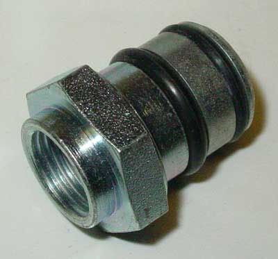

This place has inlet repair fittings:
http://quadrajetparts.com/quadrajet-...-c-128_27.html
edit: I just saw this page where they do Heli-coil repairs as well:
http://quadrajetparts.com/service-fu...ors-p-355.html

You can buy the HeliCoil kit for that repair and do it yourself.
It'll probably cost the same as having someone else fix it, but you'll know it was done right, and the next inlet thread repair you do will be free.

Might want to take a look at this thread. There are a variety of different repair fittings for this problem.
http://quadrajetparts.com/ring-inlet...ng-p-1951.html
