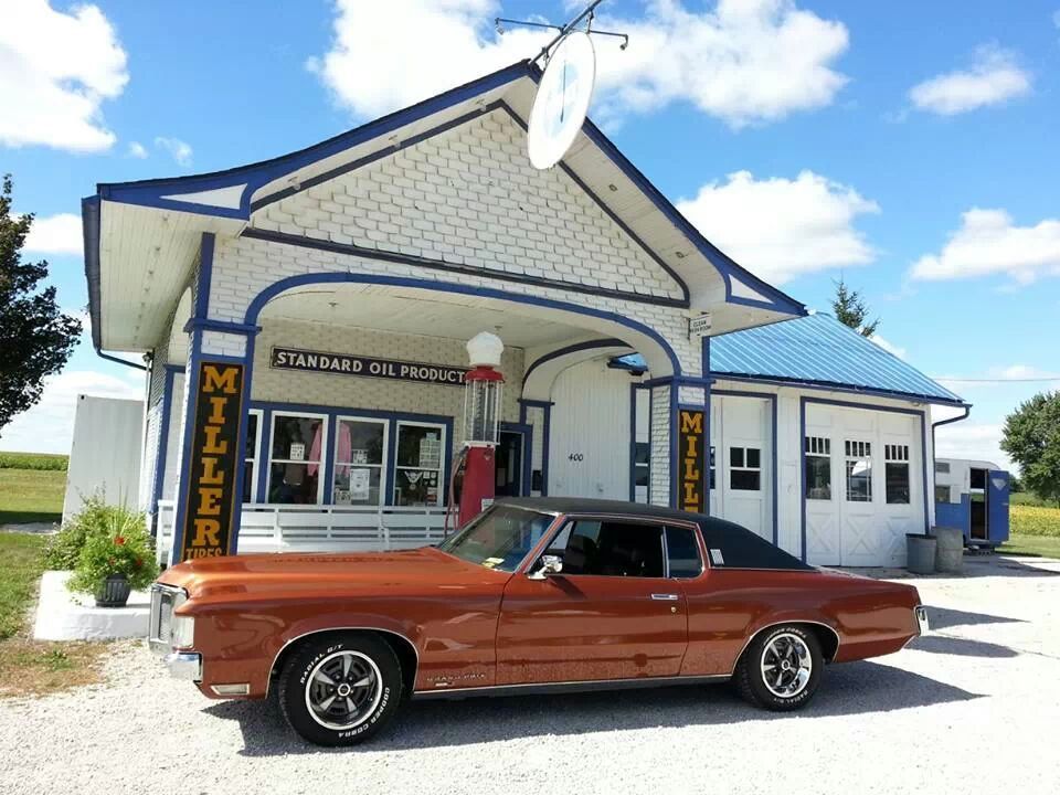

Yeah, the hood and fenders are a mile long. This is my 69 428 HO. One of if not the best riding and handling old school cars I have ever owned... and I'm A Junkie....ask my wife LOL

The Grand Prix was a factory 4-speed, A/C, leather interior, and 428 HO car. It had the build sheet and PHS document showing all were installed at the factory. The collector bought the low mileage and unrestored car unseen and had it shipped to Texas.
Your Grand Prix looks great.
