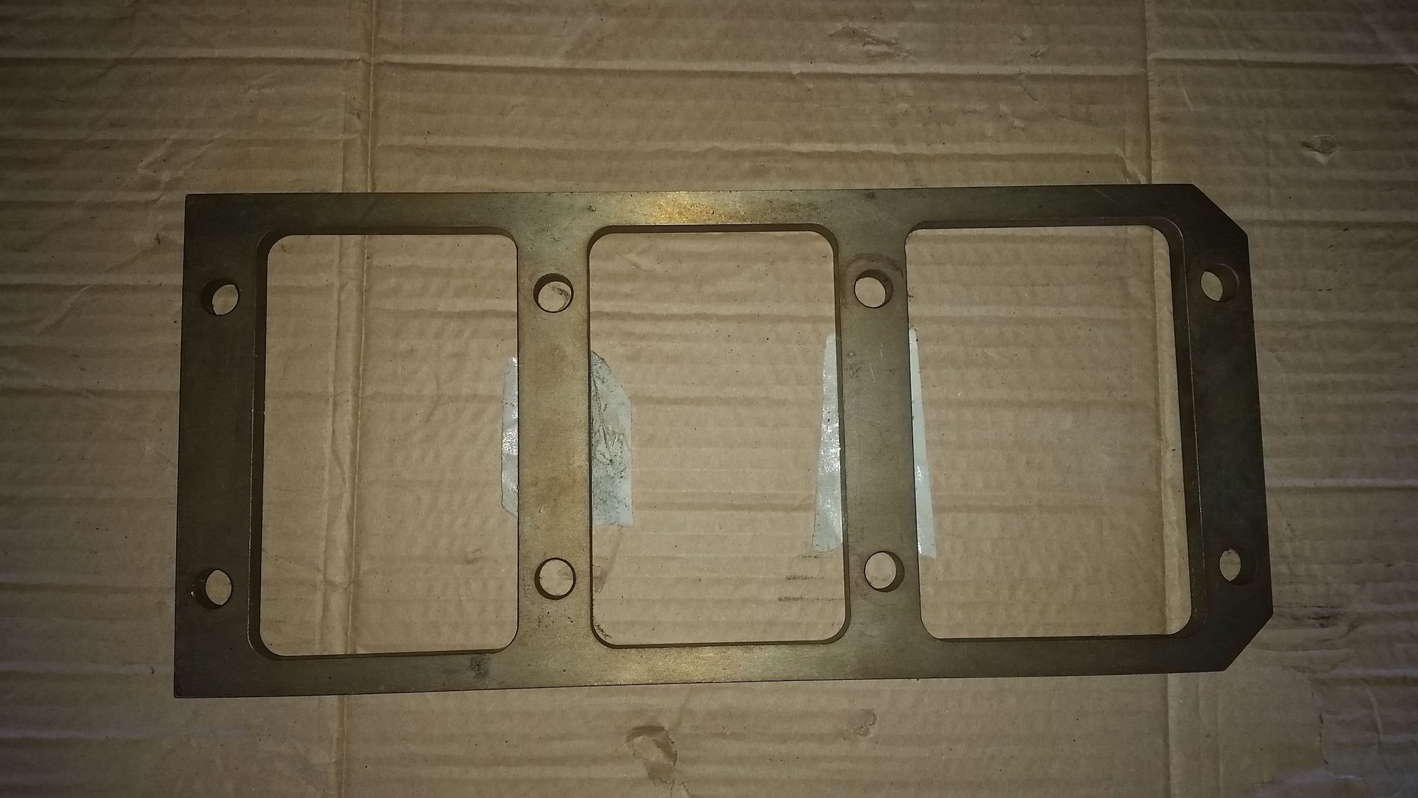

I have one you might be interested in. I bought one from Jim at J&S about 15 years ago. Seeing as my Nephew is a tool and die guy, I had him make a copy only it's CNC'd not like J&S. I know, me bad. I never used it. No studs, and you would need to machine your caps. If interested pm me and I'll give you pictures/info yada yada. I'm in Ohio 44481. Thanks, Ken

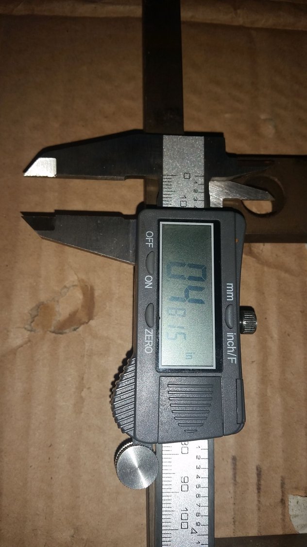

The thread starter pm'd me and I've replied. My CNC'd one is 0.4815" thick. Demensions exact duplicate of the one I bought except thickness. I couldn't put pictures in pm.
Old Dec 4, 2017 | 10:30 AM
olds 307 and 403's Avatar
Out of Line, Everytime😉
Posts: 10,110
From: Melville, Saskatchewan
Looks very nice.
