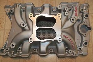

Well, without knowing what type of pistons were used in the rebuild it is impossible to determine much. #8 heads with flat top pistons would yield a decent compression ratio for a performance platform, but #8 heads with "factory replacement" large dish pistons would be a disaster.
You should be able to determine which intake it is just by reading the molded in name off of it.
Note this one has Performer RPM on the #2 intake runner:
And this one has Performer 350 Olds in front of the carb flange:
