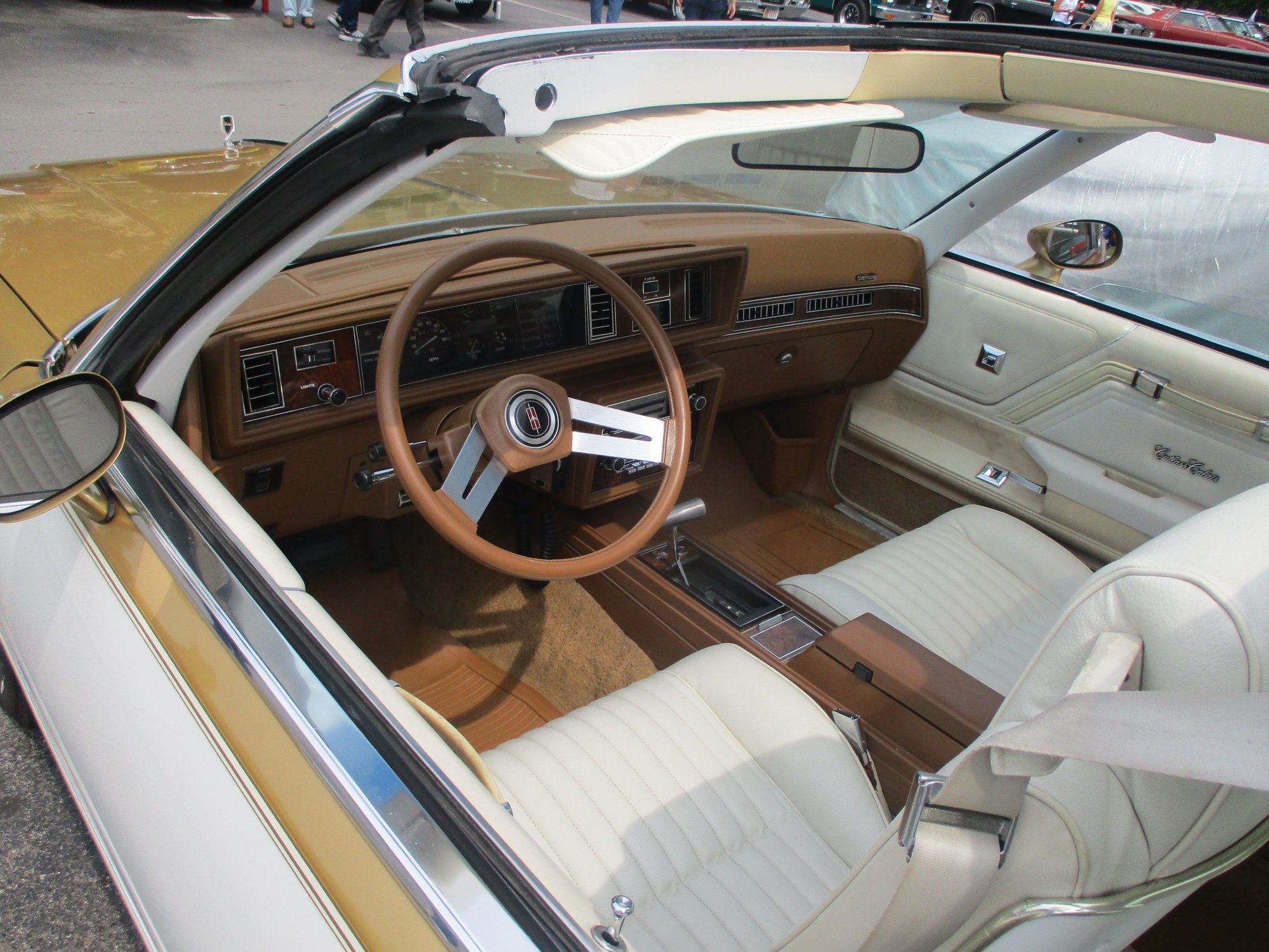

Thanks for all of the comments. Great looking car, is that oyster interior?

You nailed it, this one has the Oyster White interior. One of my winter projects (which may even be done today since it's going to be a bit warmer) is to dye my interior parts from the B-Pillar on back and also install the just arrived headliner. You can tell by the photo the b-pillar piece is in bad shape.
