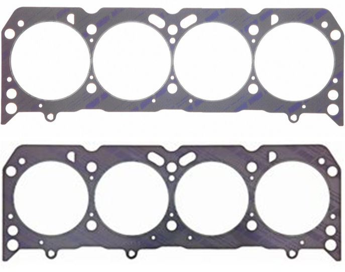

Does is matter that the middle bolt hole is not on there for the 403(top one)? I noticed the one I took off has three holes.
Old Mar 11, 2024 | 12:35 PM
Posts: 50,815
Those aren't bolt holes. Those are for the dowel pins that locate the heads. The 403 block doesn't have a dowel pin at that middle location.
my bad, trying to learn too much at once lol. thanks for the info
