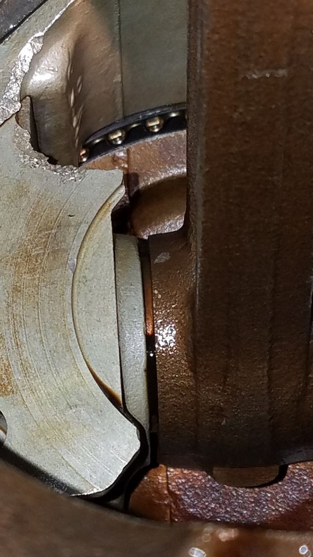

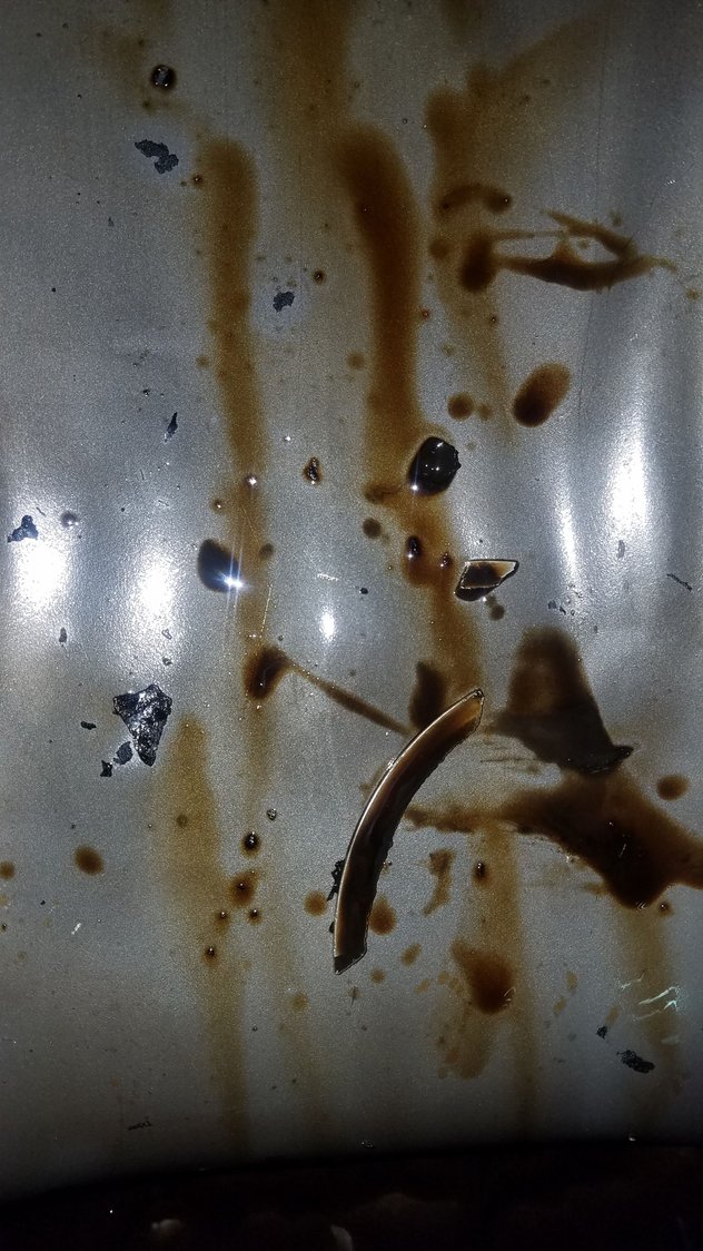

So I finally got around to pulling the oil pan on my father's 70' cutlass and here's what I found:
Peices of a ring and i believe peices of the pistons, probly more in the oil (nothing was magnetic)
1 skirt broken off
Another skirt broken off
I dont think you are supposed to see the oil ring are you?The cylinder walls looked pretty good from what I can see from the bottom.
anyone have any idea what might have caused this? Also can anyone help identify the pistons? 398665 cast into the inside of the skirt. Appear to have a very small dish thru the spark plug hole.
It was supposedly rebuilt about 10k miles ago, was running with some smoke coming out the breathers, 185-195 on all cylinders except #5 had 50.

Detonation would be my first guess. Stock camshaft? What other build specs? What octane was used for gas?
I agree. Those pics look a lot like what happened to my '70 Supreme 350 back in the early '80s. One day I tanked up with cheap gas (poor college kid), then a couple days later was WOT sideways @5800 RPM and smoke started pouring out of the left side tail pipe. After tearing down the engine, I found a piston with broken top ring, ring land, and piston skirt, just like your pics.

398665 is a standard bore GM piston. Looks like the "rebuild" was a clean it up, hone it and put it back together type deal.
The broken ring was probably from detonation like the others said. The broken skirt is probably because the piston is way too loose in the bore.
