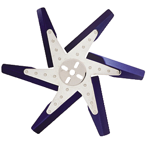

If it's this fan:
Throw it in the trash as they don't work very well. It should have enough room to run a stock clutch fan setup.
I use these, Derale Flex fan spaced 3/4 in from radiator:

If it's this fan:
