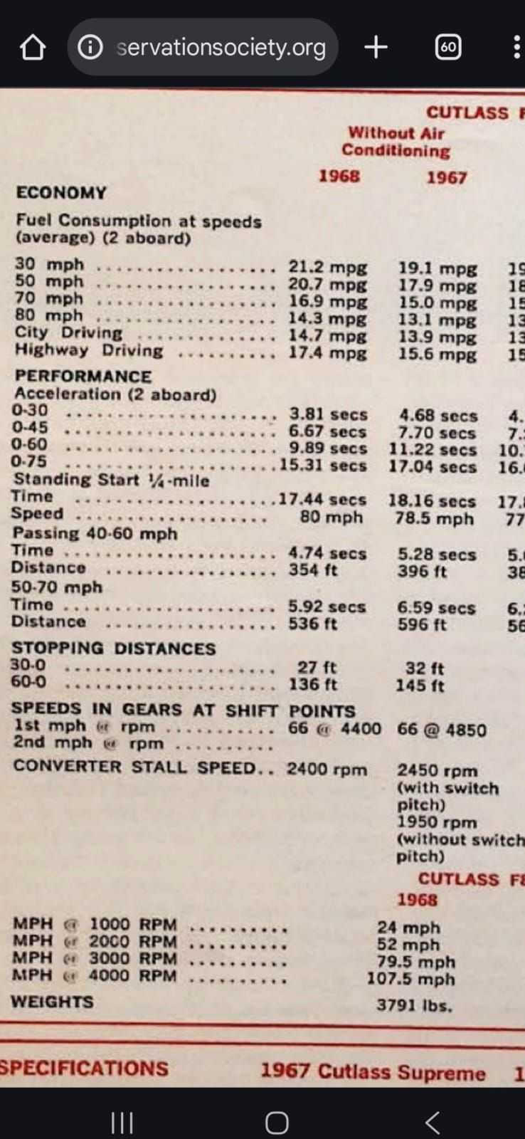

Old Dec 14, 2025 | 01:45 PM
69CSHC's Avatar
Posts: 2,092
Originally Posted by Cutlass Fan
I don't understand everyone's hate for the Jetaway.
I wouldn't call it hate, it's just the TH350 and TH400 are far more superior in accessing an engines power production.
Original road tests do not tell the whole story clearly upon initial viewing...
You need to dig a little to see the truth.
The 1965 A2 442 seems close in performance to the 1967 A3 442. Till you factor in weight and traction issues.
Both A2 and A3 ran a 15.5 et . But the 67 weighed 400 lbs more . The 67 hit 91 mph to the 65s 89 mph. That's a 38 hp difference in performance. Meanwhile the cars were rated 345 hp for the 65 and 350 hp for the 67. Now match the 67s weight to the 65. The 65 gets destroyed.
Swapping a 3 speed auto into the 65 makes it much quicker, it's not close.
All the SP does is maximize a 2 speeds capability, in effect turning it into a 2.5 gear.
But it's still missing the effect of the other half of a gear. And the performance says as much. And once you compensate true stall for the switch pitches effective stall it's a wrap. By 1968 it served no purpose on stock Oldsmobile's.
Motor Trend June 1968.
Switch Pitch vs non switch pitch.
320hp vs 310hp. Pic has all the details and it's not close. The 320hp SP loses across the board. The non switch pitch Jetaway shows a 15 net hp improvement in performance.
Both weights on bottom of next pic.
Pages 94-97 here. https://autohistorypreservationsocie...Full-Issue.pdf
continued
