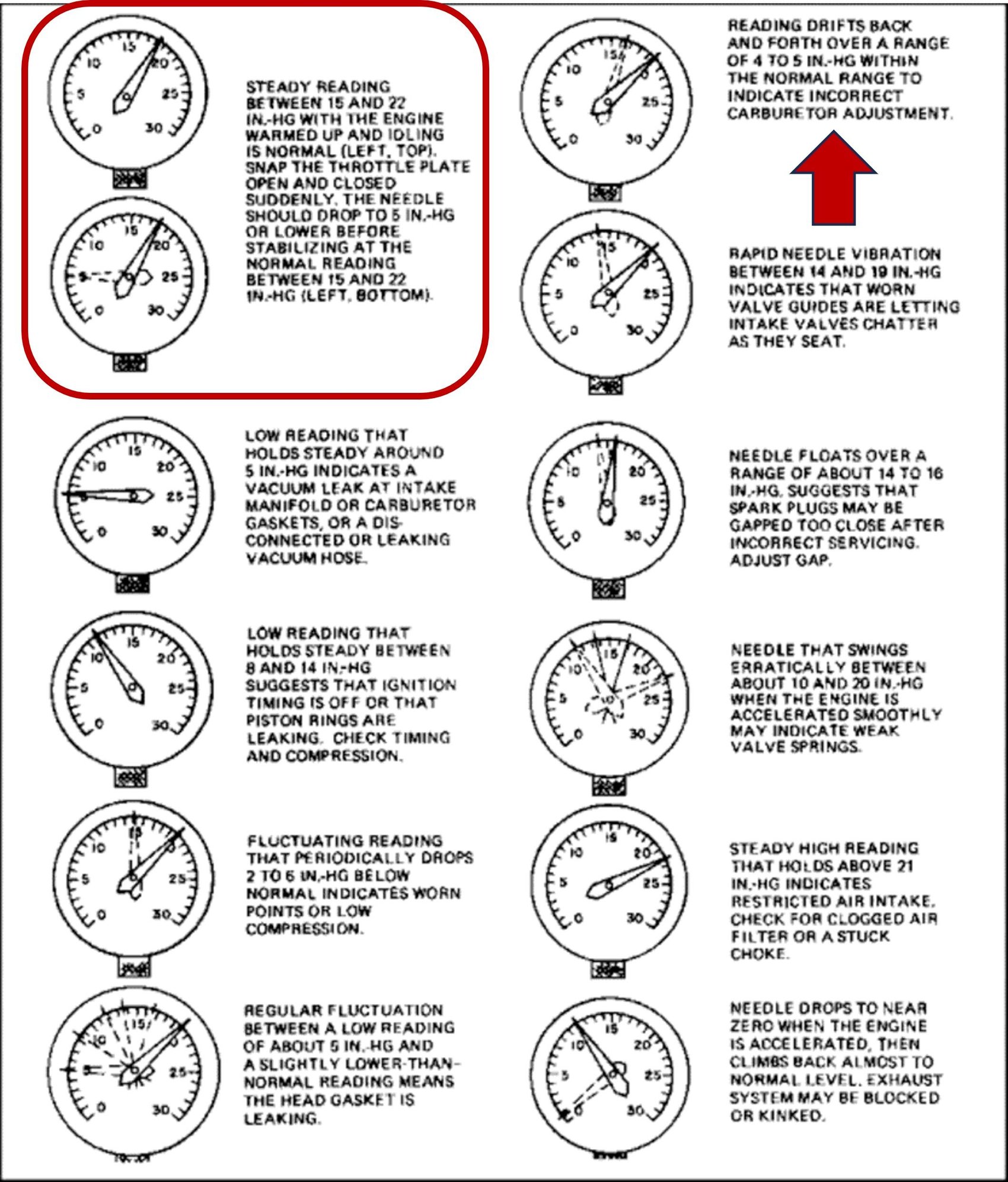

The best thing to do is measure the vacuum w/ a vacuum gauge & evaluate the results. A properly tuned stock engine should achieve a STEADY vacuum of ~17"Hg - 21"Hg.

Where should I connect the gauge? Will any vacuum point work?

Connect the gauge to any intake manifold vacuum port. You can insert a plastic "T" in-line to a existing intake manifold vacuum port or remove a existing vacuum line and connect directly to an intake manifold vacuum port (cap the line you removed).
