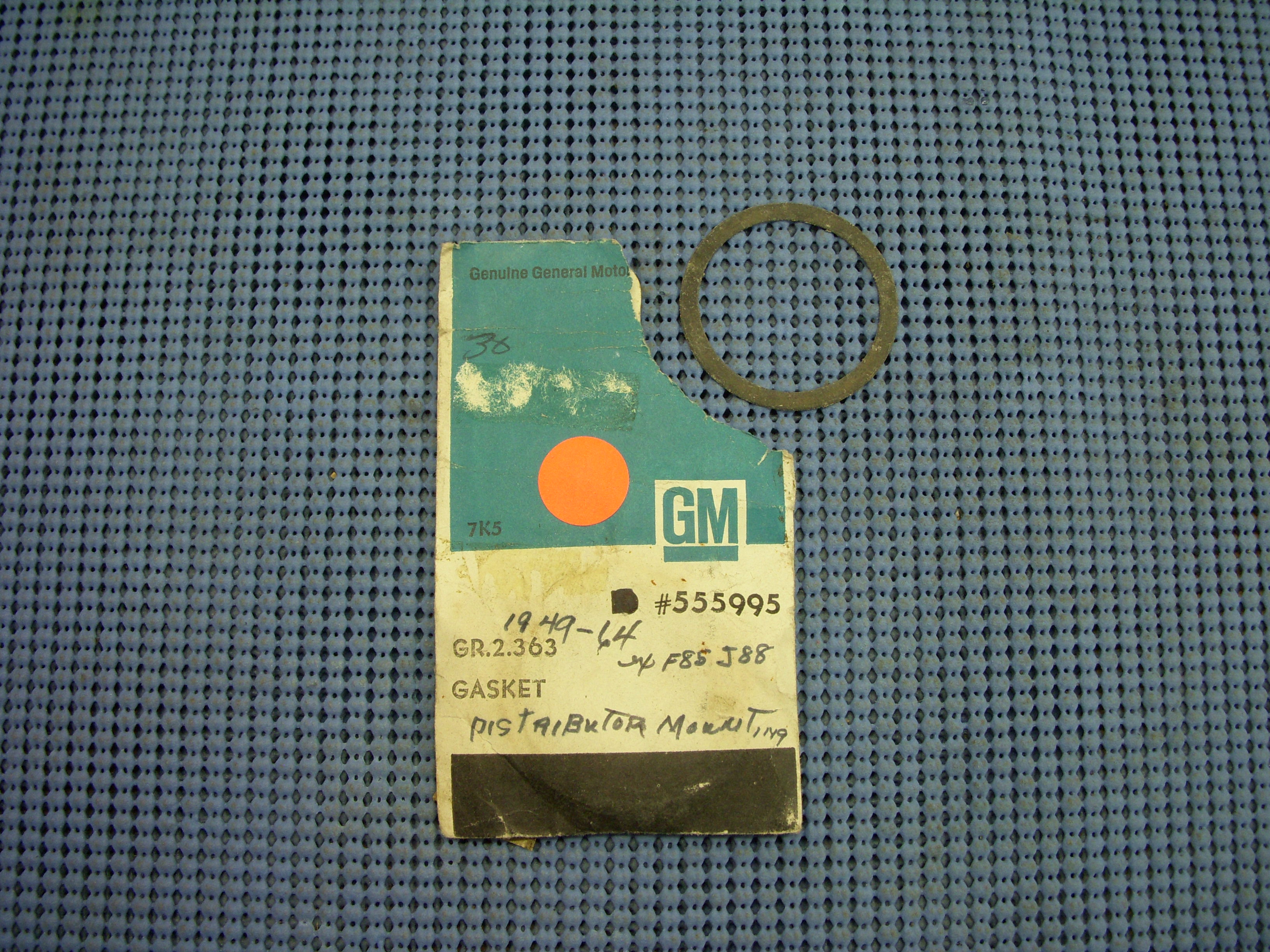

I consulted the paper copy of the 1972 issue PN manual to find the following surprise:
Group 2.363
555995
"GASKET, dist. mtg."
49-64 exc. F85, J88
Indicating that perhaps no O-ring is used on pre-'65 Big Car V8's

Well, I knew that I didn't imagine that distributor mounting gasket being there -- what was left of it, anyway. It was obviously put there by someone a long long time ago, and ignored or not even noticed by everyone whose been there recently (for the last 20-30 years or so). I only found it when cleaning the gunk off of the top of the manifold, and there wasn't much left of it. I guess I'll go ahead and make a little gasket out of gasket material. Can't hurt.

Wow. Do you actually have that gasket, or did you just locate an image somewhere?

Yes, there is supposed to be an O ring . Check out #34 in the following illustration;
But if you look at the Parts Manual, you will see that O-rings are listed only for V6s and '64 and later V8s:
And, no, sorry, I don't have a gasket - that was just to show you what it looks like.
