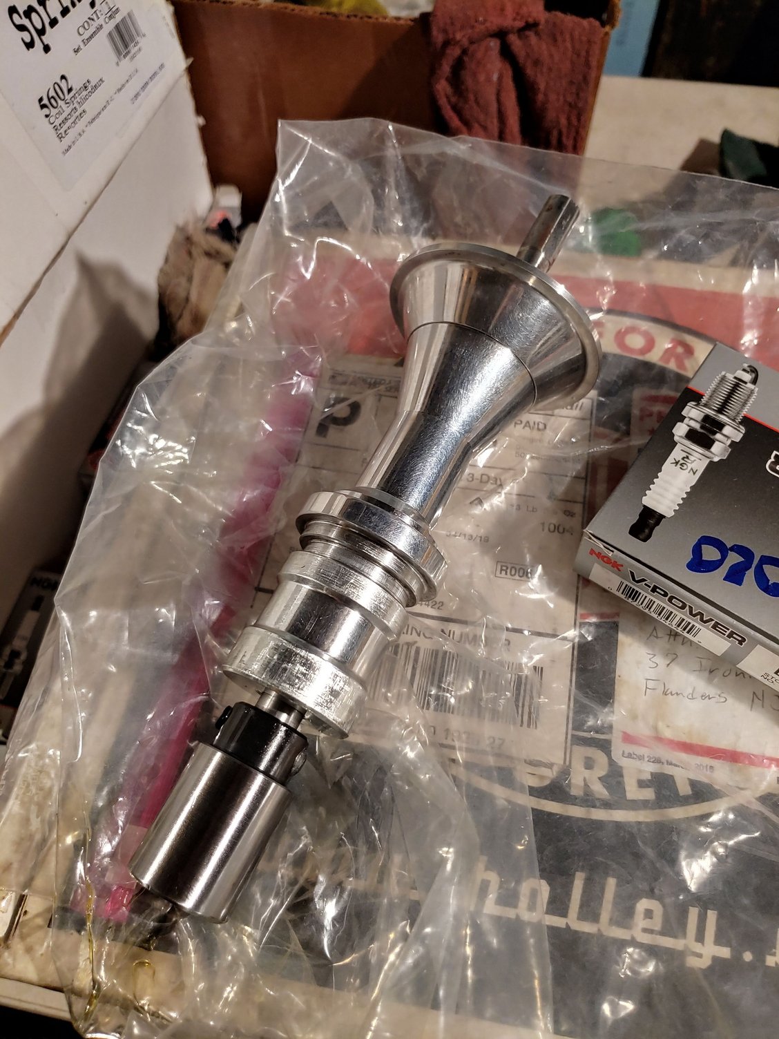

Ok, I will play
I would assume I am 1 of 1 on my system…
468 Oldsmobile with Batten iron heads
distributor:
Holley Dual Sync
ignition system:
Motec single channel CDI
coil:
Mercury marine CDI single coil
spark plug wires:
Taylor 409 pro wires 10.4mm custom fit
How does it work? Good so far!

Would you mind sharing why you went with Motec ignition system V others?

Sure thing.
Several reasons.
One, I had a Motec M8 ecu/efi system that I was going to run and thought it good to match systems.
Two, the Motec stuff is usually head and shoulders above other brands for quality and reliability. This Motec CDI ignition system was actually made by M&W ignitions, and Motec required a very high standard to put their name on these boxes and sell them as their own.
Third, I liked that the Motec has a single bosch-tyco weatherproof connector for reliability and weather resistance.
Fourth, it can do multi-strike pulses at less than 3,000rpm if I program the ecu to tell it to do so.
Fifth, I only paid ~$125 for it, brand new in the box off of eBay.
Last, I used to work at a old hot rod parts shop, and I took on a ton of MSD systems for warranty even 25 years ago. Not saying I don’t like them, but I would certainly carry a spare box with me if I was running an MSD.

Of course!
No personal experience with ICE systems, but I have heard very good things.
I honestly don’t know if an ICE system would show much benefit on a naturally aspirated engine making less than 700hp on the street, or how the reliability would be, but I would think it is good.
If money was no object, I would likely run a crank trigger, a Motec CDI-8 box, an 8 channel M&W, or an ICE system with eight separate coils.
I would really like to have my ATI damper setup with magnet pickups for a crank trigger and configure a cam position sensor off the cam gear of the timing set for the most accuracy, and just have a dummy drive and gear for the oil pump in the distributor. I might even eliminate that completely and go dry sump.
For me, for now, the simple Mercury Marine CDI coil I run is supposed to have excellent reliability and very strong spark, capable of 9,000rpm + and 800hp+ even with nitrous or boost.
The distributor gear shows less than 1 degree of slop, so not bad at all for accuracy for our setup. The dual sync distributor shows good sync overall for the cam and crank positions, so we will be running it for now.

Don’t worry about accuracy on the cam sync. It’s only purpose is to tell the ECU where number 1cyl is. Even if it’s off 10* you can still figure out optimum injector timing.
And virtually ALL multi strike systems quit above 3000rpm.
What’s really more beneficial is to be able to alter the coil dwell time for inductive type coils. That’s the best bang for the buck imo.
