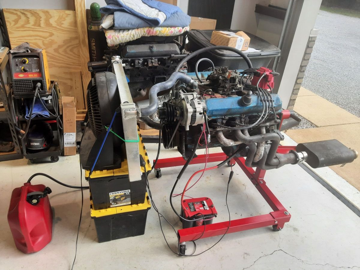

Unhappy Just my luck...
My wonderful recent '72 Toronado 455 score (engine 3 in my current collection). I got it up on the test stand, then I oiled the cylinders, changed the oil and filter, cranked the engine over quite a few times with the drill motor building good oil pressure on a manual gauge installed, installed an HEI distributor in place of the points dizzy, installed a replacement carb, fresh set of plugs, some old headers with 40 series Flowmasters on the ends, then I powered up the ignition and it barked to life immediately! I could tell this thing was as virgin as the day it rolled off the assembly line, as everything was dead stock and untouched except for the valve cover gaskets. The micro thin head gaskets, factory intake manifold, timing cover, and oil pan gaskets. So virgin, that I actually felt some remorse that I was violating it (!).
Well... after it got over its crabby first 1/2 hour of idling at various slow speeds (valves sticking, lifters occasionally clattering), coming up to full temperature, I carefully stethoscoped every possible point not hearing any evil noises anymore. I then started throttling it some, with it responding well, oil pressure doing very well, engine sounding great with headers and Flowmasters sounding strong! I let it run for an hour at various speeds ranging from 600 RPM to 2500 RPM on some fresh 93 octane out of a 5 gallon gas can. After that, I shut it down, let everything cool down overnight. The next day, it started up like a new car - wonderful response, no noises - we have a winner! Or so I thought...
I fired it up the next day, let it fully warm up, then I nailed it a few times, wailing the secondaries open vigorously a few times. It was the equivalent of tipping over a barbeque. So much crap came dumping out of the exhaust of every color you could imagine. I actually had to break out the leaf blower to get all of the shmutz blown off of the cement apron! This beast was running good now - VERY good! There was some blue smoke out of both sides whenever I nailed it, so I thought that I may as well go through it and give it a fresh set of bearings, hone the cylinders, install some fresh rings, new oil pump, large 8 quart RWD oil pan - just a light overhaul to freshen this 50 year old virgin up. The idea here was to install a nice Crane hydraulic flat tappet I have had in stock, then "top end it" with some 69cc Speedmaster heads to offset the lowest compression very deep dished pistons, a very nice vintage Edelbrock 04B intake I have on hand, along with a nice adjustable roller rocker valve train with 3/8 pushrods so that I could have a good runner to at least roll my 442 around this summer.
(Notice the ultra greasy '79 Trans Am 403 sitting against the wall - haven't fired that one in a few years, supposing I should light it off now too)
To my complete dismay, cylinder 3 was not looking good when I pulled the heads. I was very surprised that I wasn't going to need a ridge reamer at the tops of the cylinder bores! I continued to pull everything apart, amazed at how virgin everything was. I found a nice "N" crank, the usual front wheel drive windage plates - good stuff. Never mind the ten pounds of solid chunky deposits found under the intake manifold and under the turkey tray that would have certainly inevitably killed the engine in short order by plugging up the oil pump pickup screen once the new modern oil started breaking it up...
Summary? Cylinder 3 apparently had an intake valve open and must have taken some rain water in at some point with the piston all the way down in its bore. I found enough corrosion damage, cylinder scoring, and a broken top piston ring to really break my heart. I ran a conventional 3 stone hone through the cylinder finding it was cleaning up a little, but then when I hit it with the cherry ball hone it dug up all of the corrosion pitted surfaces. Boy I threw every cuss word I could muster at the situation, as the other 7 cylinders still had factory cross hatch in their perfect bores. !@#$%^&*()_
Soooo.... I dropped it off at my favorite machine shop this afternoon, with all of us in agreement that even an .020 would clean it up, so targeting a .030 across the board - the boring bar will be the ultimate determining factor. The block is going to be VERY thoroughly cleaned and prepared, so now is the time to do the Hard Block or Embecco 885. While my machinist is a LONG time highly regarded race machinist, he and I both stared at each other when I brought up whether we should fill the block or not. This will work out to be about 10.5:1 - 11:1, being fed mostly E85, ARP main and rod bolts, but not going to be wailed on more than 5500 - 5800 RPM. It is going to be extremely well balanced, as this is Reeds specialty. He and I like the idea of beefing up the block with the filler from a strength perspective, but both of us are scratching our heads as to how it will behave stuck in traffic on a hot summer day with the A/C on. Yeah, BIG aluminum radiator, 12 quart oiling system with a good sized oil cooler, but we want to hear from someone that has "been there / done that" before we pour any goo down in there.

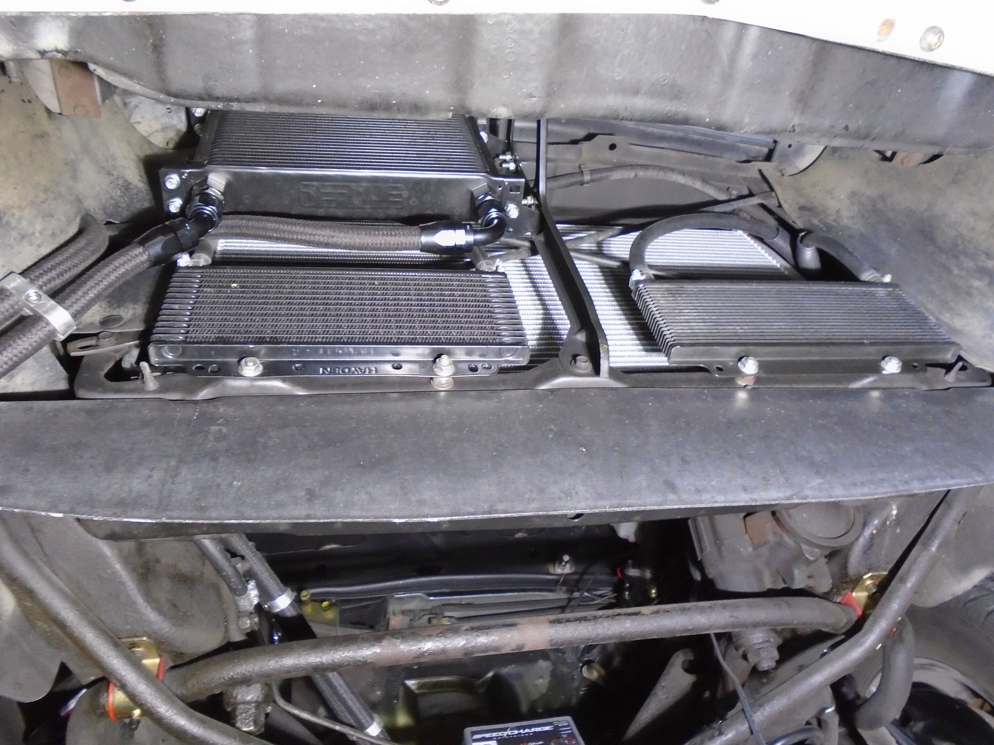

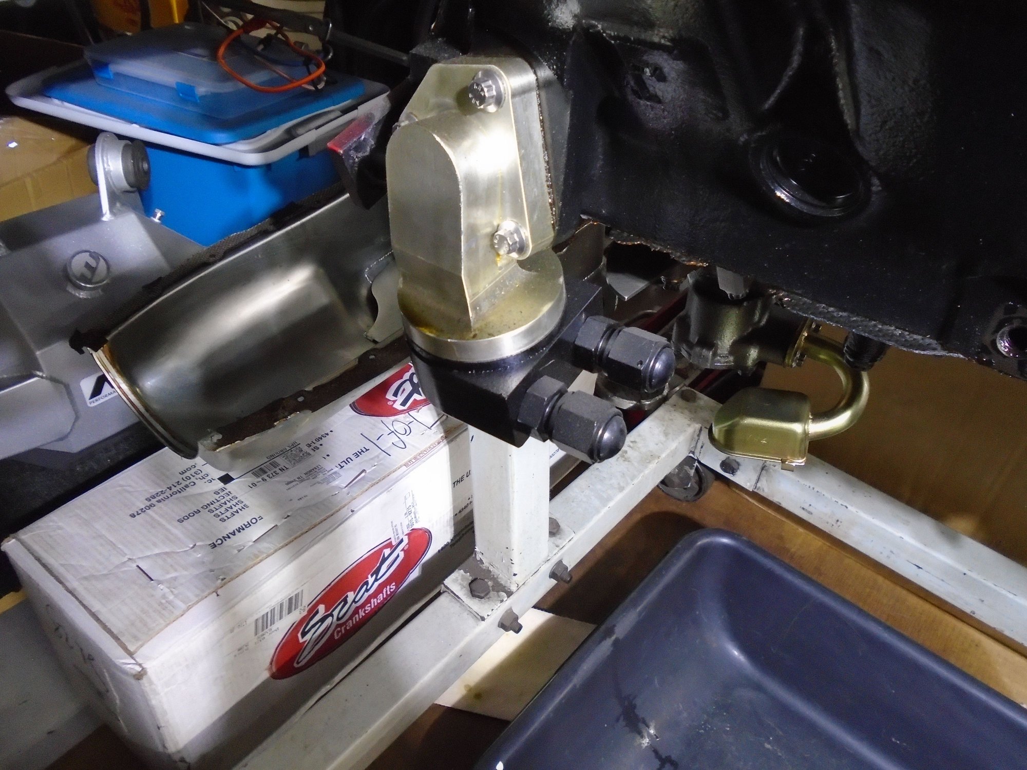

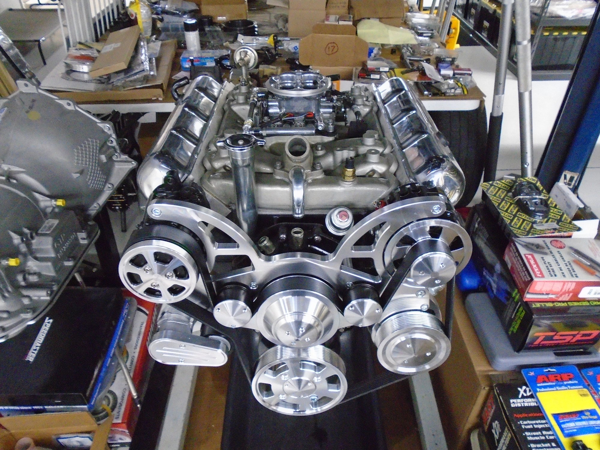

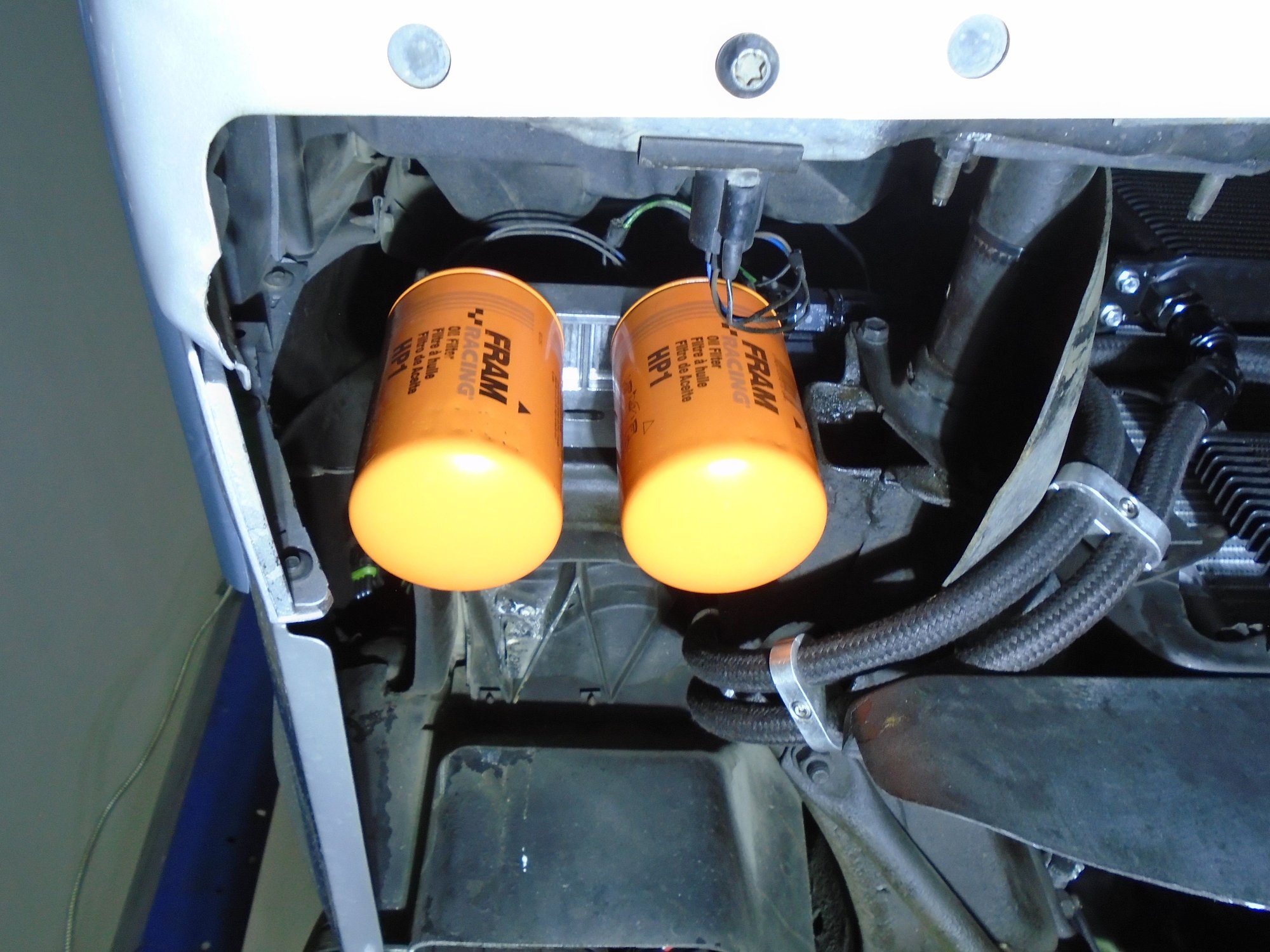

Arrow Some oil system images
Block remote adapter
The topmost cooler is the engine oil cooler - right in the direct airstream. The cooler on the passenger bottom is the auxiliary trans cooler (getting upgraded with a beefier one shortly), the cooler on the driver's side is the power steering / hydroboost cooler.
Twin HP1's tucked right up out of sight / harms way.
Here is the 488 waiting its turn to go back under the knife. I am REALLY liking CVF's new serp belt system! All of the other systems I have seen without an automatic tensioner have been decidedly BS despite their good looks... The heads are coming off shortly and shipping out to CutlassEFI for him to CNC port them up - THAT is going to make some serious power.
Meanwhile, I hope to get one of the other two 455's I have in motion installed so that I can at least run it down the road for the first time in 3 years this summer - sigh...

Yeah, riding a little bit of a high :)
Yeah man, I'm riding a little bit of that classic Olds high right now, even putting the picture set of the Rocket block up as my PC desktop wallpaper for now.
I went conservative on the bore, only 4.200" which takes it just shy of 500 cubes. That leaves plenty of cylinder wall in the highly unlikely event of a spirolock / wrist pin / piston failure at any point, leaving it rebuildable all the way up to their max of a 4.400" bore. They are setting the pistons and ring end gaps a tad loose upon my request, as now I am tempted to spray it pretty strong - thinking about a big fat 200-250 plate system somewhere on down the line for the occasional wobbly knees and shaking hands effect.
Meanwhile, it is being set up for 11.5:1, going to Holley Dominator MPFI, and flex fuel so that I can treat the E85 as race gas. E85 blends vary, but most come in at 99 to a 110 octane, so it's going to be like the good ol' days where you could go fill up with a tank full of Torco or Turbo Blue (man I miss the smell of that stuff!). So, the high compression combined with the big time cooling effects of atomizing alcohol, along with the fact that alcohol also has a higher oxygen content in it, will allow me to feed it plenty of fuel, cam, and timing to achieve some strong performance out of it. I love the fact that I can put a valet tune in the car before I hand the keys to my daughter, otherwise she'd kill herself with a quickness. Taking it in for an alignment, setting the rev limiter at 2k - just enough so it can be driven into the shop and then road tested - gotta love technology combined with a 50+ year old engine design.
Now the looooong term dream is to drop the compression way down the opposite direction and then install a couple of whistlers (twin turbo it). With the 4L85E, Bowler triple disc anti balloon plate 1000+ horse rated converter, carbon fiber driveshaft, and the Moser Fab9 rear end, I know it would be able to take the power without grenading, BUT I only have the frame rails narrowed with the UMI kit, limiting me to a 295mm tire right now. Being a 68k original virgin car, I don't want to cut it up... well, at least not yet (lol) to be able to put any serious rubber back there. As it stood with the previous 488 stroker, it would blow the tires off at a 30 roll, so it's going to be even more of a handful now. 3600 lbs with my butt in the seat, full tank of gas. You also start to really bend and tweak these G bodies when you get too much power into them, which I don't want to do - 1/4 panels popping, A pillar cracks, all that bad stuff. I did put urethane frame bushings in it which really stiffened it up nicely, but after not having driven the car for three years because of troubles with my 488 "Project Cabrone", I'll be tickled just to feel some damn torque again hopefully before the summer is out.
Paul
