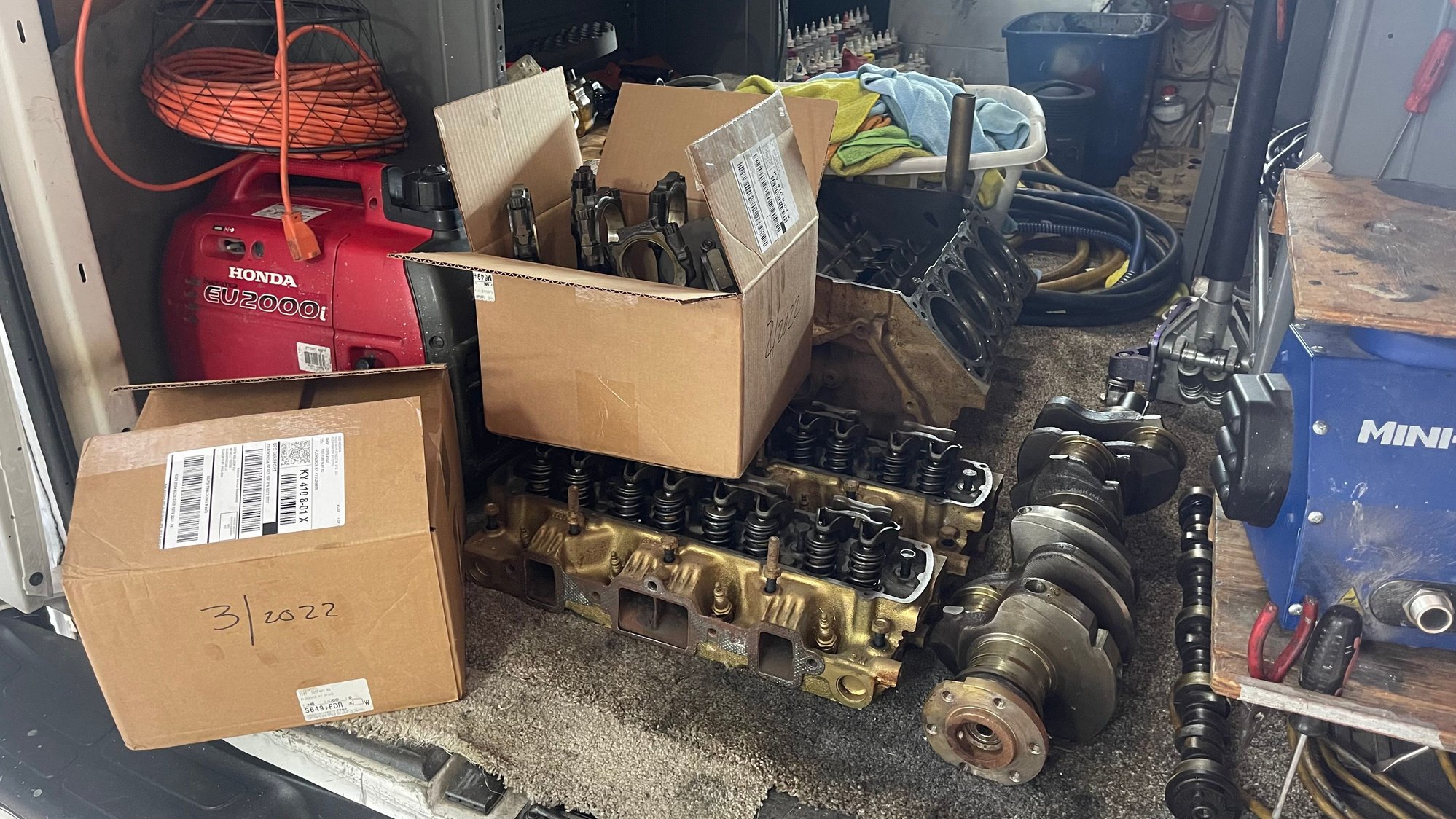

I have my original 65 400B block, A heads all apart and off to the machine shop to be cleaned and checked. The engine was rebuilt but never fired and has been sitting for over 25 years. I’m am looking for some suggestions from the pros(I’m no rookie, but far from a pro) and how I should go about this build. I’m not wanting a radical racer, but I want a nice street machine that can run on 93 octane. Thanks in advance for any and all advice.
