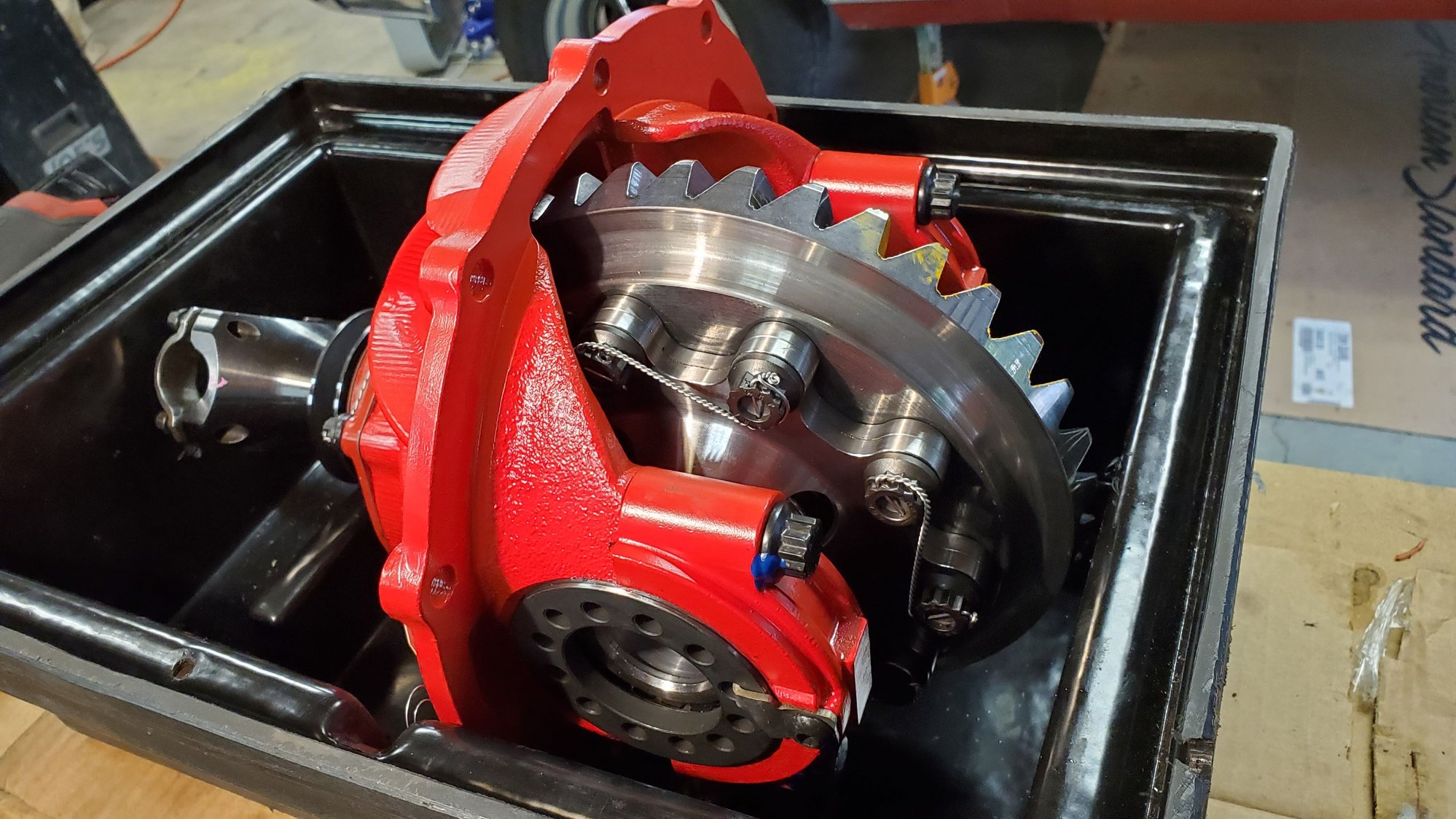

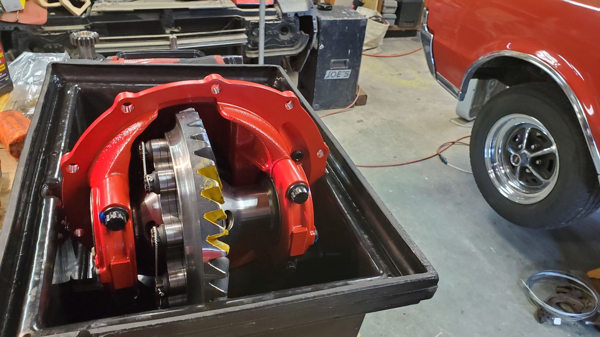

I got my stock car center today. Check out Lakeside Race Parts in NC if you're interested in one. Same gear I had, 3.70, this one is rebuilt with new Timken bearings, rebuilt billet G Force locker, polished gears, and a billet yoke for 1350s. Need to order up some 31 spline axles. And, safety wire because safety wire!

That’s perty, almost a shame to install it!

Posts: 6,657
yeah that looks real stout

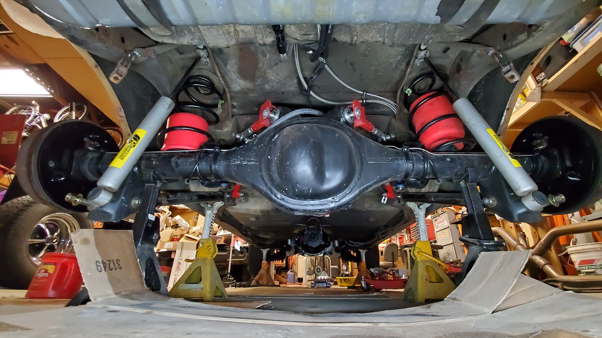

Got it installed with new brake lines and my budget ARB
What sway bar are you using? I've never seen one like this on an Oldsmobile.
Old Oct 21, 2021 | 07:16 AM
fleming442's Avatar
Posts: 3,797
From: Mt.Ary, MD
I made it. Here's the how-to

Wow! Gorgeous unit. What happened to the original one?
-peter
I still have the Strange/Truetrac center. It started making a weird clicking noise on tight turns and had excessive backlash in the ring and pinion. Changing the fluid never helped. The clicking (and high speed vibration) are probably the pinion yoke. I had cap girdles on it, and they weren't seating fully over the caps. I don't know if the yoke wore out, if the caps are just junk, or need machined to fit correctly. I also need to investigate the backlash cause. The gears may just be wore out, dunno yet.
