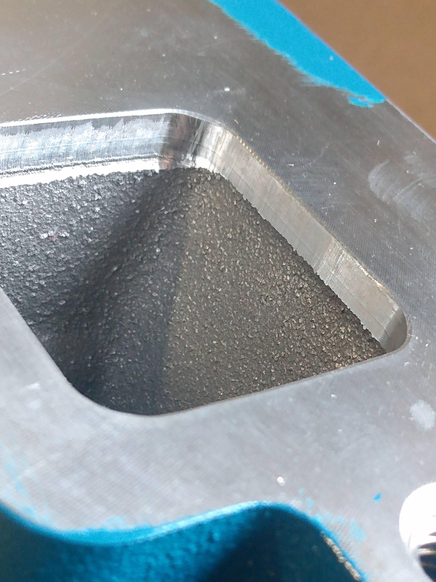

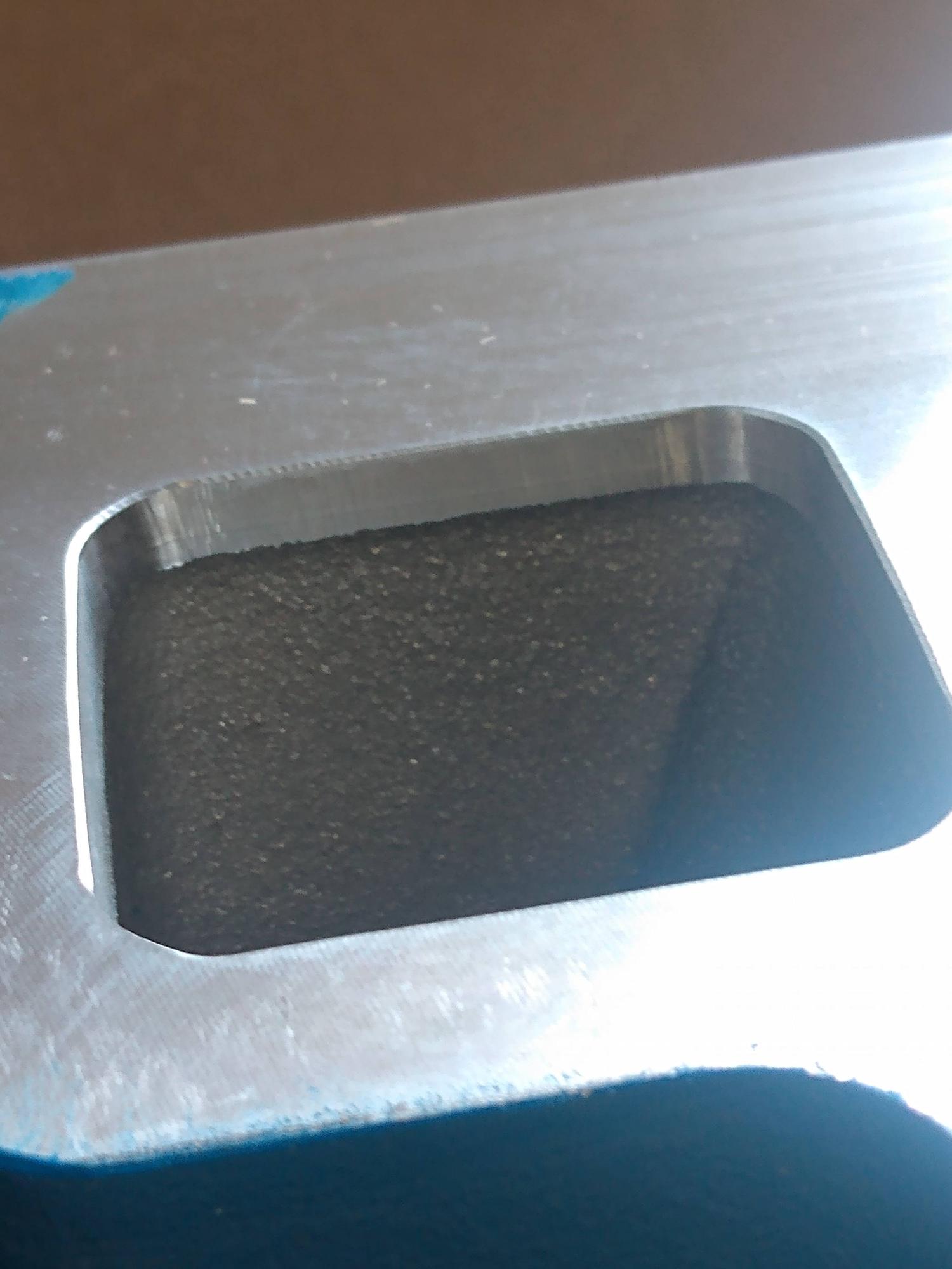

I do not doubt Bill testing. But the closes up pictures. Look like edelbrock did not clean up ports openings correctly.
