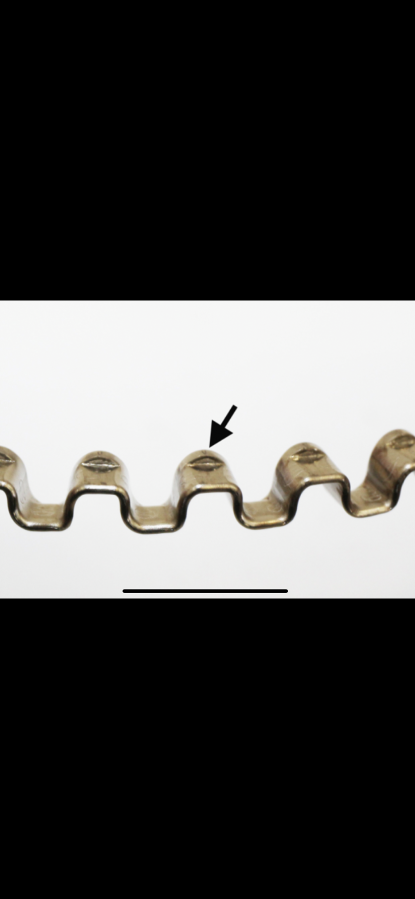

the overall vertical dimension of the pack and or the vertical thickness of the rails, is not what controls the tension.
it’s the combination of the expander tab contact spot (where the inner part of the rail touches it) and it’s design , and the radial depth of the rails …is what controls the final tension …you never once mention the expander?
the expander contact spot can be adjusted (during manufacturing)to provide more or less tension on the rails..
you need to go back to oil ring school because you totally forgot how important the expander is. Here’s the critical tab that controls the tension of the rails.

I’m well aware of what the expander does, but as usual you missed my point.
And yes you can get different expanders. That could influence the pressure the ring exerts on the wall. Duh.

I’m pretty sure anyone that’s been following this knows the expander is just that, it greatly influences the pressure of the oil rails against the wall.

no, not everyone knows the expander IS what dictates the tension. you also completely failed to mention that because you think you know what you’re talking about because you spent countless hours on the phone.
