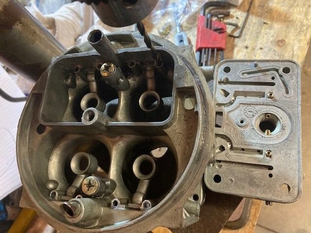

Old Jul 4, 2022 | 05:40 PM
w30442's Avatar
Joined: Oct 2007
Posts: 80
From: New Brunswick Canada
Drilling out the idle air bleed
Not alot of meat around these - I went with 8-32 on the HS bleeds and 10-32 for the Idle Air Bleeds
PVRC and Idle jet are 6-32
All are brass set screws with a 3/16 length
Back together
but jets and PV's not as marked
No real trick stuff here just the heavy holley.
