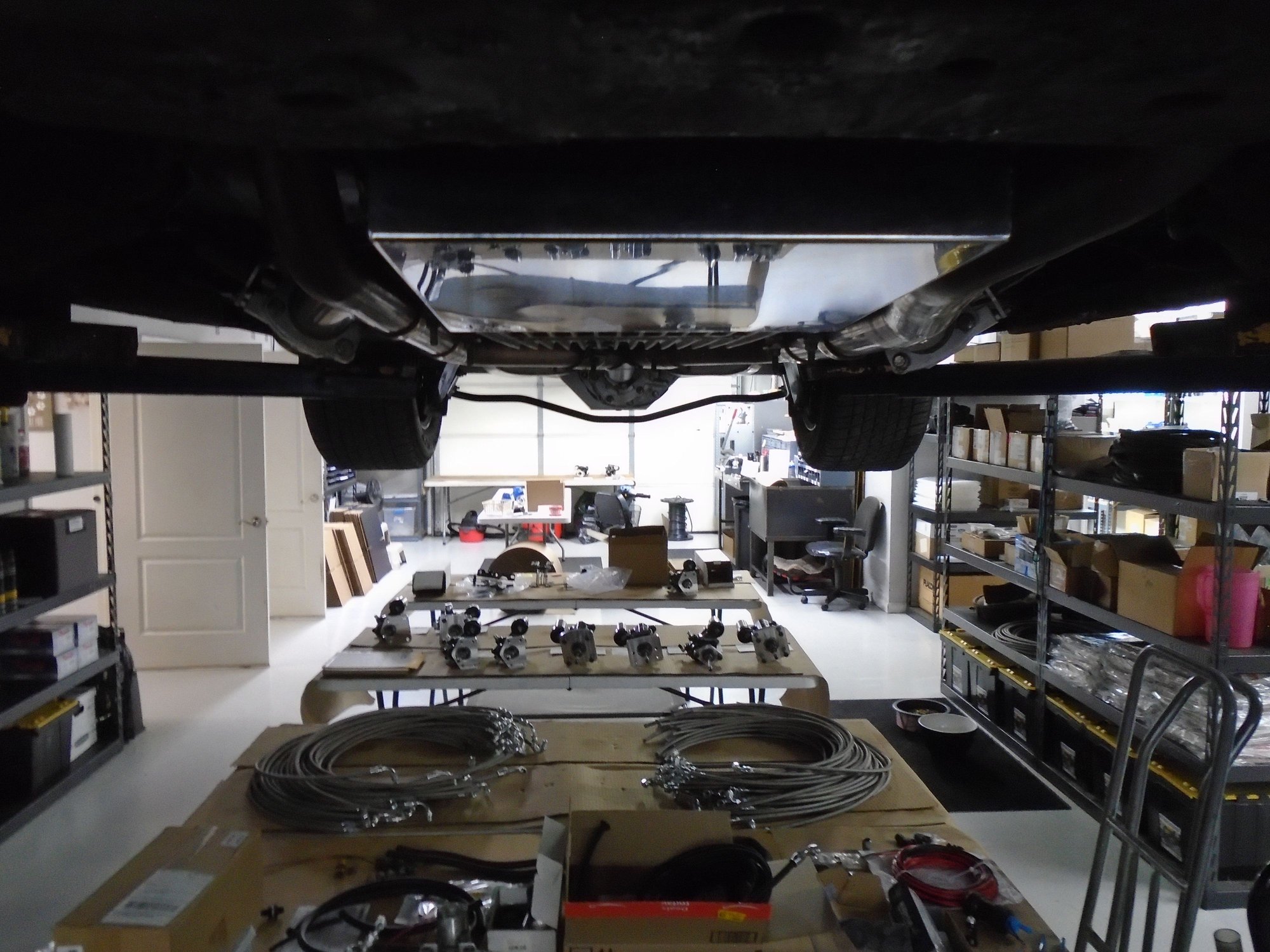

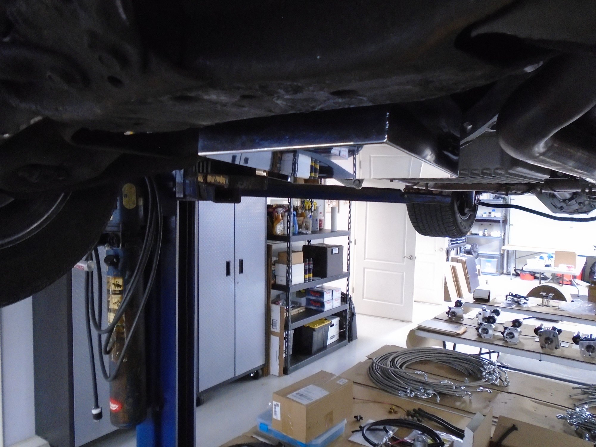

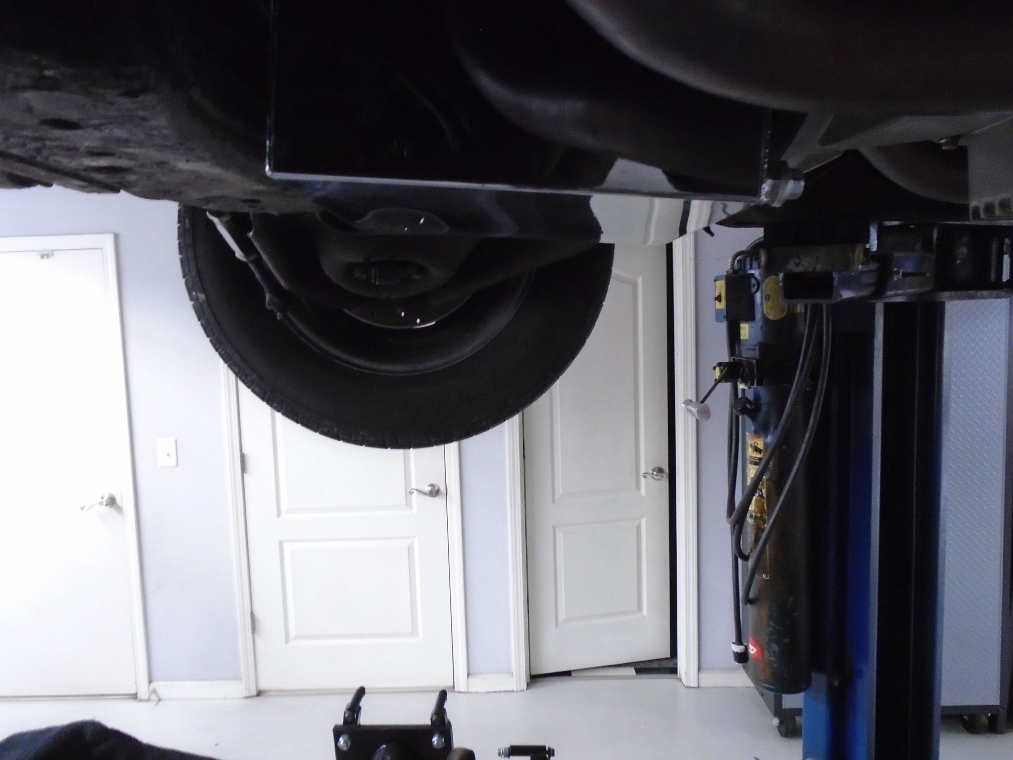

Post Some decent pics
Here are three decent pics to go by. The lighting isn't the best but it gives you a general idea of what the clearances are:
The sump does have somewhat of a rearward angled designed to it. The bottom rearmost point to the pan is actually right on the same plane / depth as the finned standard depth cast aluminum 4L85E trans pan, finding that was about the same with a Turbo 400 with a cast aluminum standard depth finned pan on another previous build.
Paul

Arrow These pans are everywhere
Go to Ebay and you will find them from $107 - $112 with free / included shipping
Enter this into the Ebay search bar: HZ-9398 oil pan
The chrome one is showing at $107.80 or best offer, and the black one is showing $112.45 or best offer. You will see MotorEmpire on the image at the top, but lo and behold you also see CFR Performance in the lower part of the image (and also listed in the details section lower below as the brand), so maybe it IS CFR producing these? Free shipping - same parts (same part numbers, just different outlets distributing them). Some are actually distributing below cost in efforts to "get their numbers / volumes up" to get into the next better pricing tier - that's how it works. Yes, Ebay will have to hit you with sales tax, but on just over a hundred bucks, tax won't be too bad. WAAAAAAAAAAAAAAAAAAAAAAY more economical than any other performance pan + the extra quart of capacity the others do not have...
The installed pics I provided are in my 1986 G-body, so certified clearance from me on that aspect.

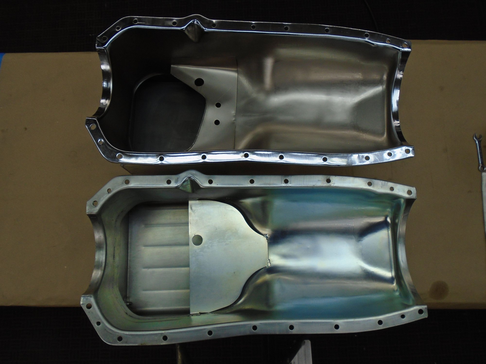

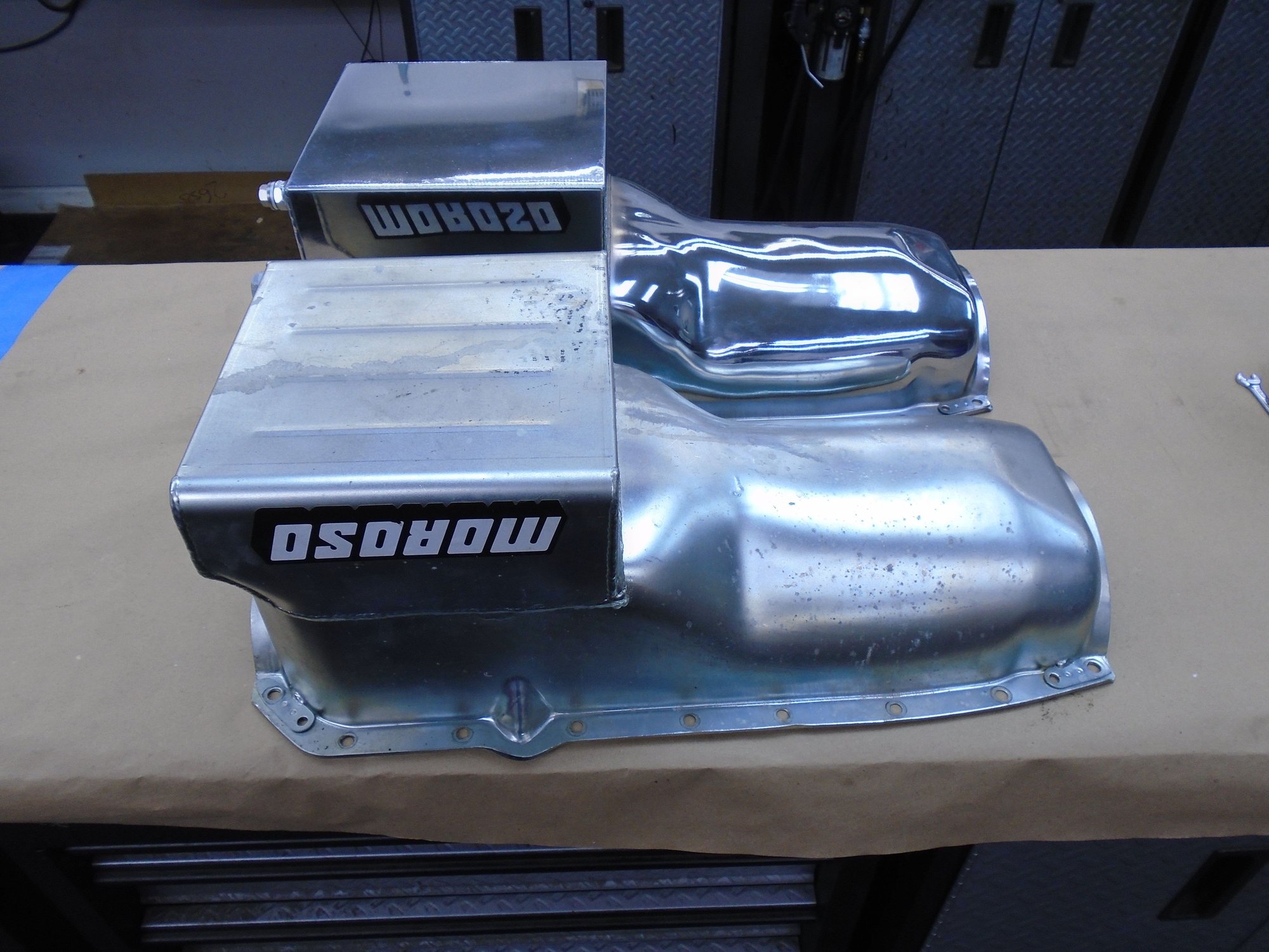

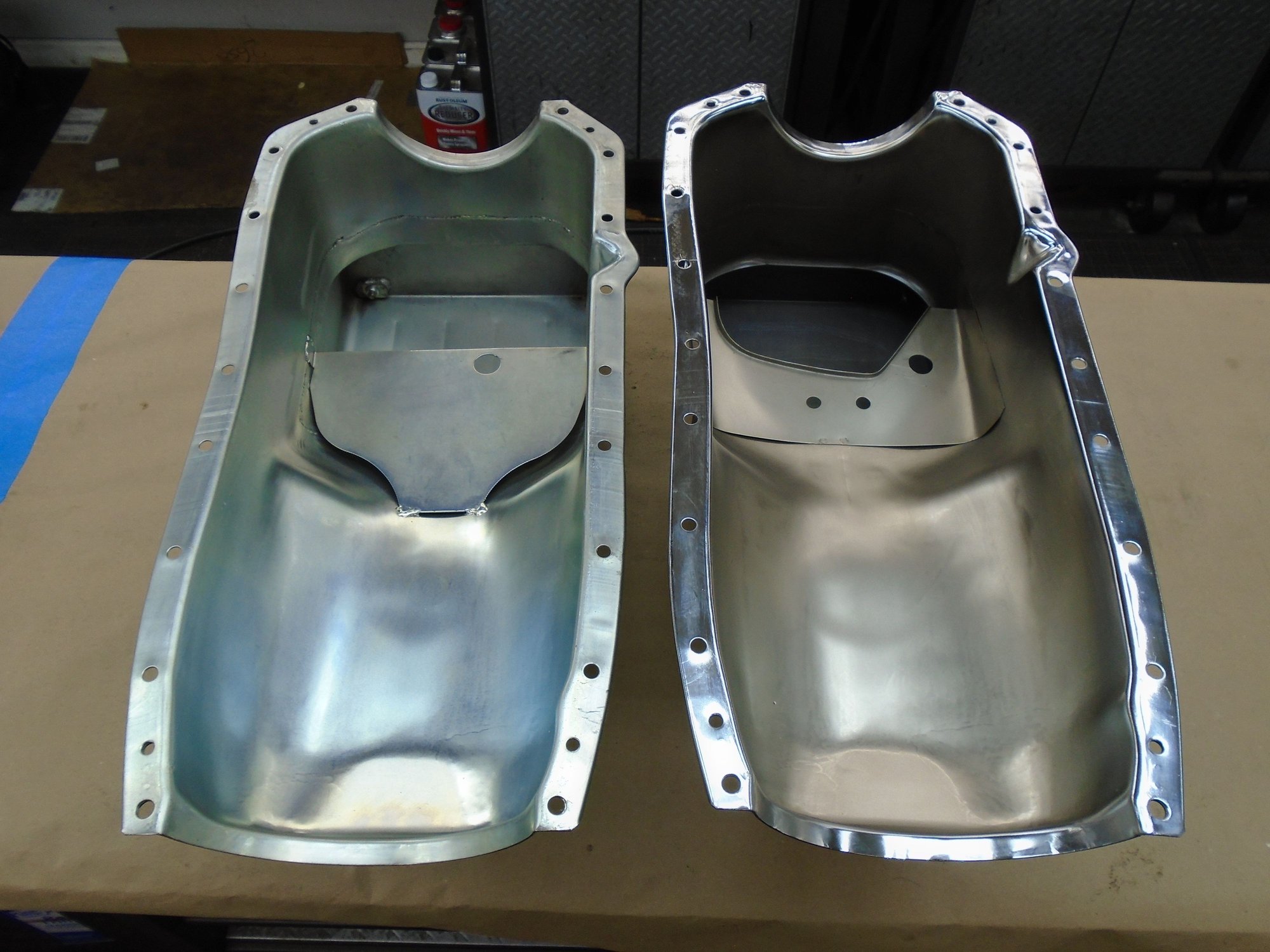

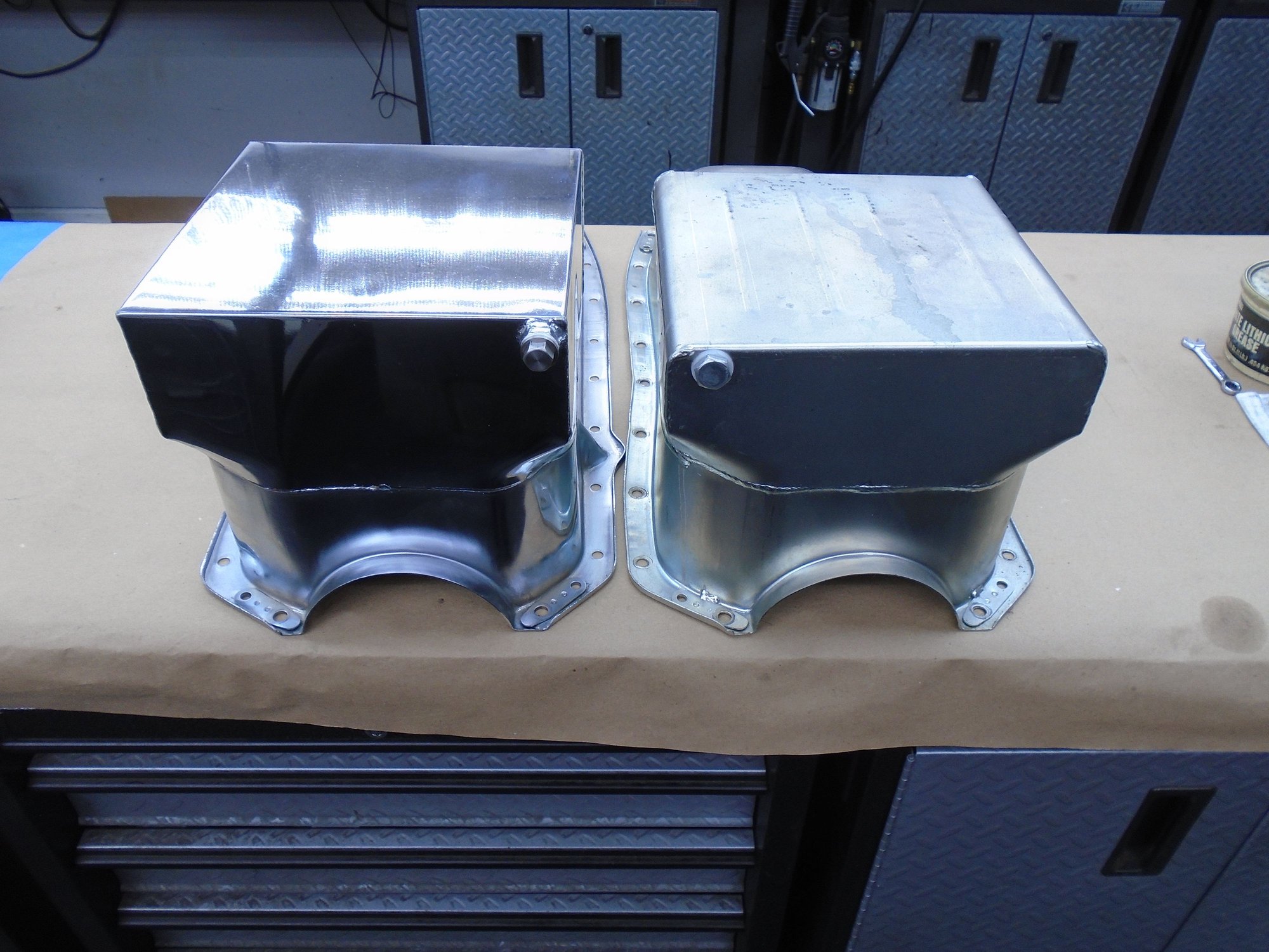

Here is a zinc plated Moroso shown next to the HZ-9398-C chrome:
I always fill them with mineral spirits using a quart by quart exacting fill to see where the real time oil level is going to be, which also double checks them for leaks. Never a problem out of 10, maybe 12 of these lower costs pans despite what conventional wisdoms would have you think. Never any problems with the end seals or gaskets installed either.
