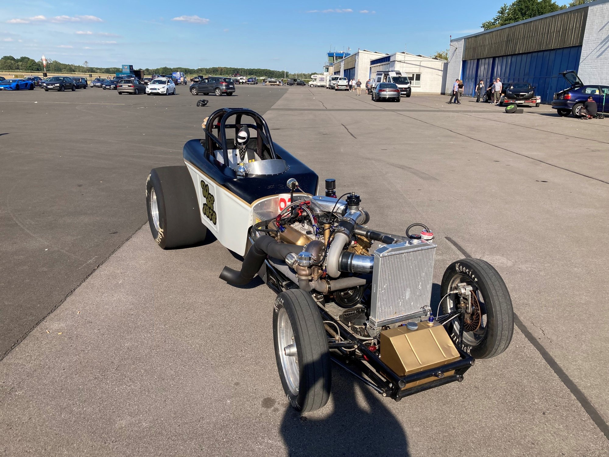

I currently run a 76 SBO with .055 milled #8 heads (heat risers poured with aluminium), stock internals (rings filed open), upgraded with a mild XE262H comp cam, stiffer valve springs and an Edelbrock performer dual plane intake.
Fueling is done by a 600hp poweradder FiTech unit that is blown through by a "GT45" ebay turbo via a Pro Charger carb hat (picture still shows the Spectre hat).
The engine is backed by a Powerglide with a 3000 Stall B&M holeshot and this is used to power a 1750lb Altered with me in it. Sofar good for an 10.6 on a non prep track with 8psi of boost.
The car will get an intercooler over the winter as the intake temperature are getting way to high, found this issue thanks to the datalogging function of the FiTech.

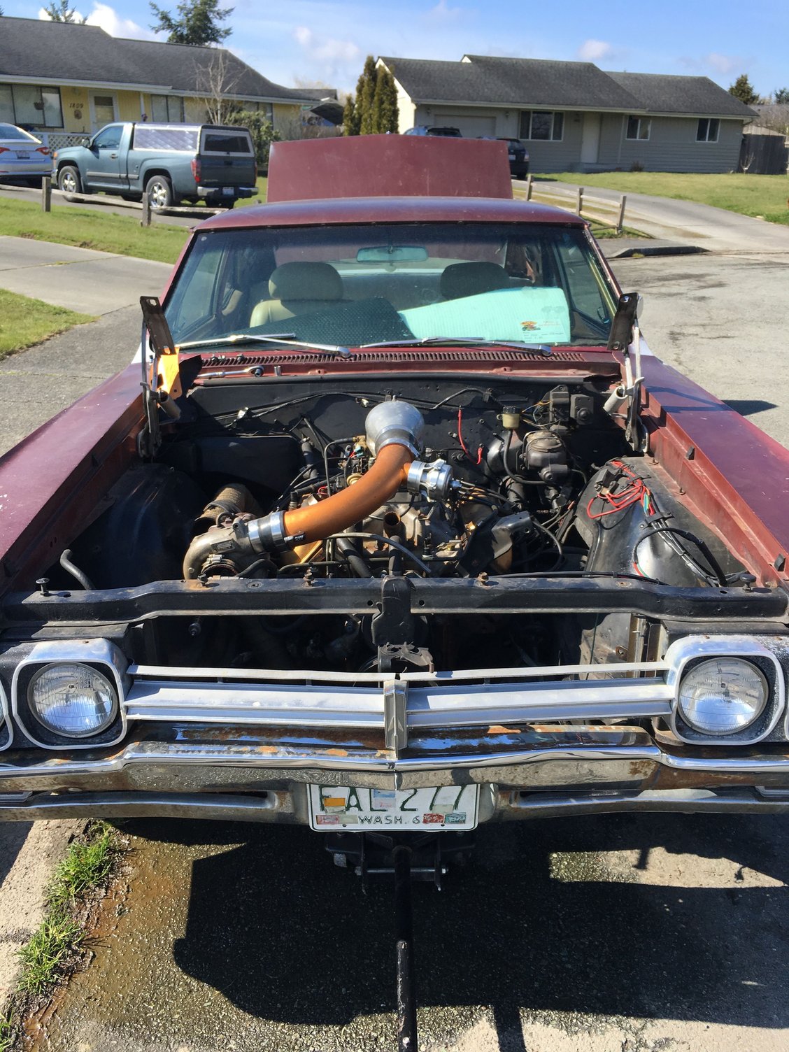

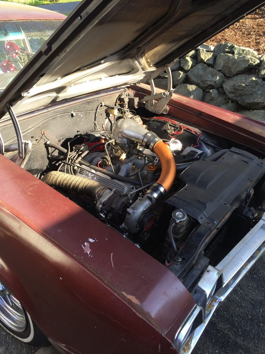

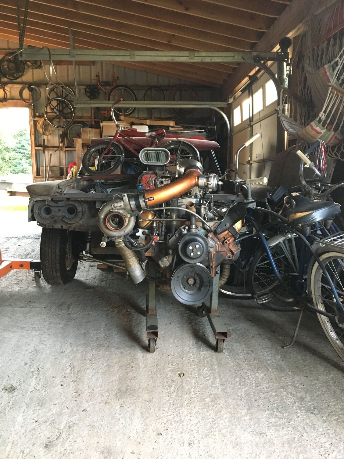

I ran a blow through set up on a 350 with the holley intake and liked it. I’ve always read that using a dual plane in a blow through set up gives poor fuel distribution, how has it worked for you?

Post no. 18 has the build specs https://classicoldsmobile.com/forums...k-olds-157413/

A Victor Intake is impossible to find here in Germany, Chevy is what everybody uses, getting across this Holley is already like winning the lottery. The Edelbrock 3711 is the one everybody uses, the 7111 or 2711 are nearly impossible to find. You can get them new but not for a reasonable price.
At all the races I have been nobody races with an Oldsmobile engine, mostly Chevy some Fords, all others are domestic brands (European like VW, Audi, BMW, Fiat, Opel etc.) and some japanese like Honda or Toyota.
I looked at both cam cards and the specs seemed the same to me, I will check if I will install the cam this winter or save it for a next engine (more projects are awaiting)
Getting off the line is going quite ok sofar, I start with a 2500-to-3000rpm on the 2 step/transbrake, depending on the track, then the boost is also not so high (2-3 psi) and then let her ripp.
The 14x31 Hoosiers are doing a fine job sofar, some wheelspin is there and the car is fishtailing a bit but it's steadily moving forward and not going up in smoke.
Just for the information, these tracks are small airfields that are bare virgin tarmac, no rubber, no glue and traction compound is not allowed to be used. Only a small rolling burn out.
Future plans are a progressive boost controller and a programmable timing control (both time based).
