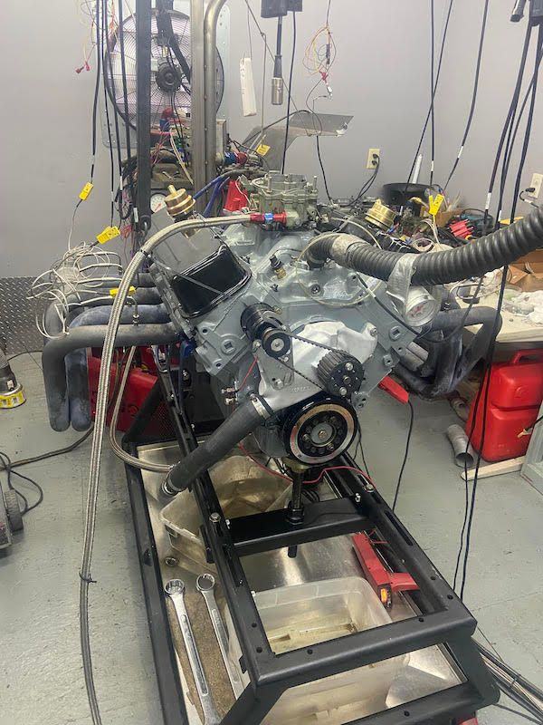

Dyno Testing Part 7
I'm not sure if this is the correct location for this post, but if not move it an please let me know.
I have finished the testing for what will be Part 6. I'm in the planning/thinking about when and what testing will happen for Part 7.
I want to invite anyone to come to Livernois Motorsports and come watch, help out, keep me company, whatever. None of the testing I do is secret by any means and I really enjoy having people come and visit. There have been two people that have came and visited, Dave and Lloyd, and I'm pretty sure both have enjoyed it very much. Here are my current thoughts about what will be tested, along with the probability it will be tested.
1. Next time I arrive in MI for testing the engine will be configured exactly as a 1970 W-30. F heads, aluminum manifold, Q-Jet carb, W/Z manifolds, etc. We will test this in stock configuration (big thanks to Joe Padavano to letting us borrow the heads and intake to make this happen) and we will do some basic, "period correct' bolts on's like headers, O4B intake, maybe Air Gap intake, 800 CFM Holley spread bore, maybe things like the 850 double pumper, Torker or Victor intake, 1.7 rockers. Not sure about the maybe things, we will see where the initial testing takes us and call audibles after the basic bolts ons. Change of doing all this, 100% unless Livernois needs the dyno (this has happened once in the last year) or something catastrophic happens to the engine.
2. Finally have sucess at running the Batten heads on the engine. I have acquired a cast Batten big block intake (long story but these details will be discussed in part 6). I checked geometry this morning to run studs/guideplates, etc. This looks good. So all I need to do is put the sleeves in the pushrod holes with some epoxy and then assemble the heads. This will be tested with a few cams I suspect, but again, we will call an audible. Probably of this happening, I'd say 75% or greater.
3. Peyton Hunt of PDD has very generously agreed to port our Gen3 Edelbrocks for testing. Those heads will leave MI this week for Peyton. He will perform his best porting on those heads and send them back to us. If these heads are back in time, they will get bolted onto the engine and tested with various cams and intakes. Probably of this happening, I'd say close to 100%. If the heads come back from Peyton this will happen. We have not asked for special "cut to the front of the line", I wouldn't do that. So it's all up to Peyton. He's excited for us to test them and we are excited to test them.
4. Camshaft testing. I am having a special camshaft madey by a very good local company, LSM. They have made about 170 Olds custom cams in the last 10 years. Not a lot but this isn't a popular engine outside of our groups. This cam will be designed to optimize our current set up but not exceed 6500 RPM and not need more than about 10.5:1 compression ratio (I don't want to buy new pistons just a test). Probability of doing this, I'd say greater than 80%. We should have a design settled on this week and it will take Steve a few weeks to make the cam. That easily fits in our part 7 testing.
5. Building the stroker short block. The engine block has been honed. I have main studs coming for this engine so the block can be align honed and decked. Once this is done the rotating assembly needs to be balanced and then we can assemble it. This will entail polishing the crank, checking all the bearing clearances, ring gap and more. If we have proper bearing clearance we will assemble. Probably of this happening, I'd say 50%. I think we will be ready, but it's a matter of how much time we have to do it. I will order some 0.001 under bearings just in case we need them.
That is a pretty big agenda for a week to 10 days of testing. Dave, from MN, got to witness about 65 dyno pulls. There is a lot of head swapping and cam swapping that I detailed above, but I bet all of the above is close to 100 pulls if we get it all done.
The final question is when will we test? Good question. When this started a year ago, since it's funded by me, I told my wife I wouldn't make any special trips up to MI just for this testing. I am just finished up my second trip just for dyno testing (the others I piggy backed off other reasons to come here). So, to not break my promise anymore, I will be up in MI on 9/1 for Labor Day. I will probably come up mid to early the week before and stay until several days after Labor Day, depending on how testing goes. August 31st and September 1st we will not be working on the engine. I may make a quick trip up, tied to other things, but I would only work on the Batten heads and get my nephew to do some welding for me on some things we need welded. In full disclosure if I'm there and the engine is a full W-30, I'll have to make a pull or two...
Much of the work for the above session I will be preforming solo as my normal helpers probably won't make it, at least some days. So, any help is appreciated, even if you just sit there and talk to me while I'm changing parts. My sister and I own a very small house up in MI and one person can stay there with me to prevent the cost of a hotel and rental car. However, I do leave the house by 6:00am and typically don't return until 8:00-9:00pm. I work a LOT when I'm doing this. So if you stay with me, keep this in mind.
My e-mail address is in all of the write ups, so I'll post it here. If you are interested send me an e-mail at jerry@tandjw.com.
jerry
