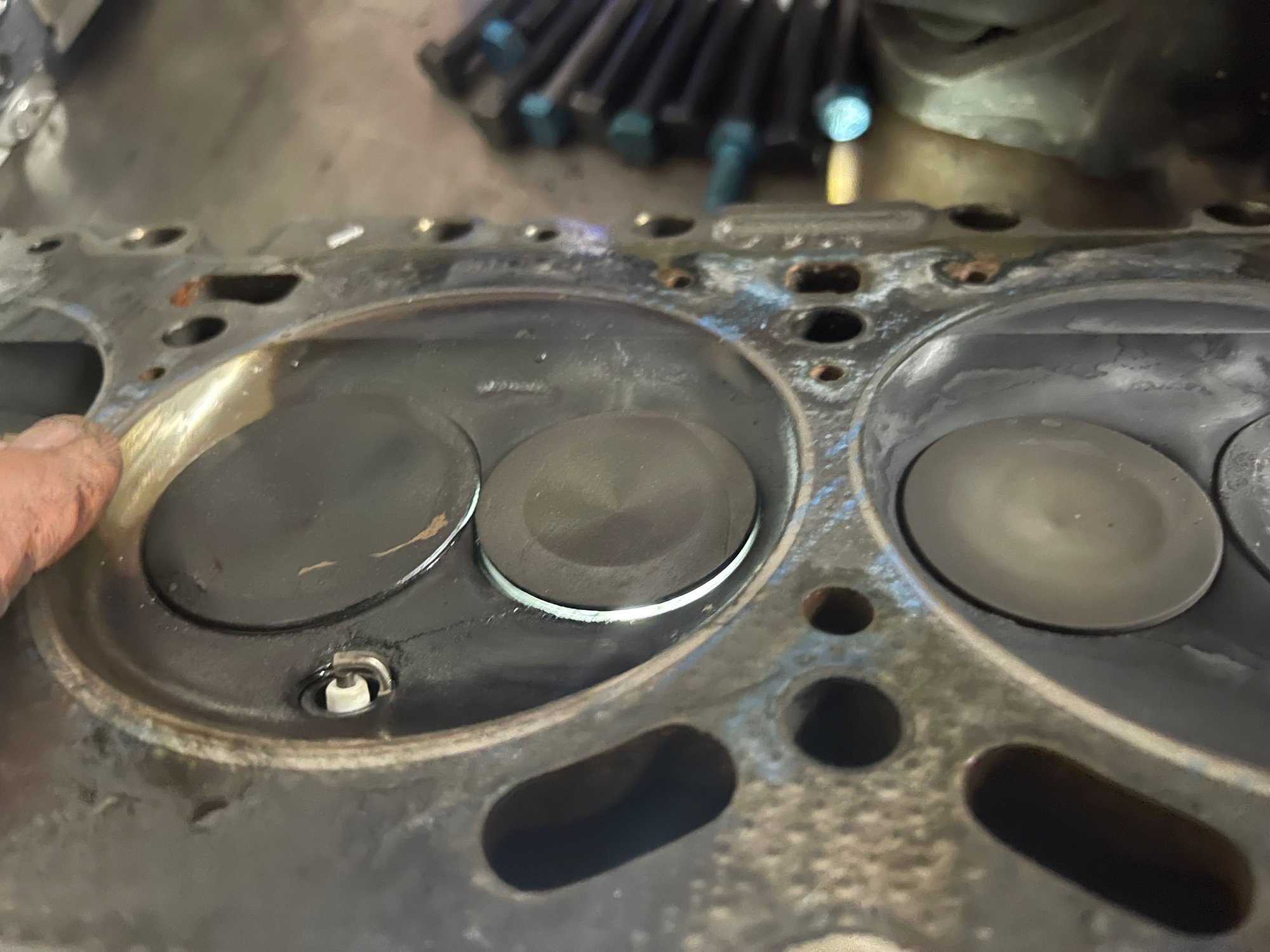

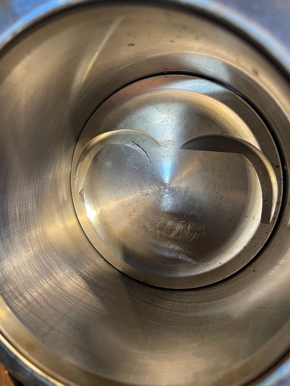

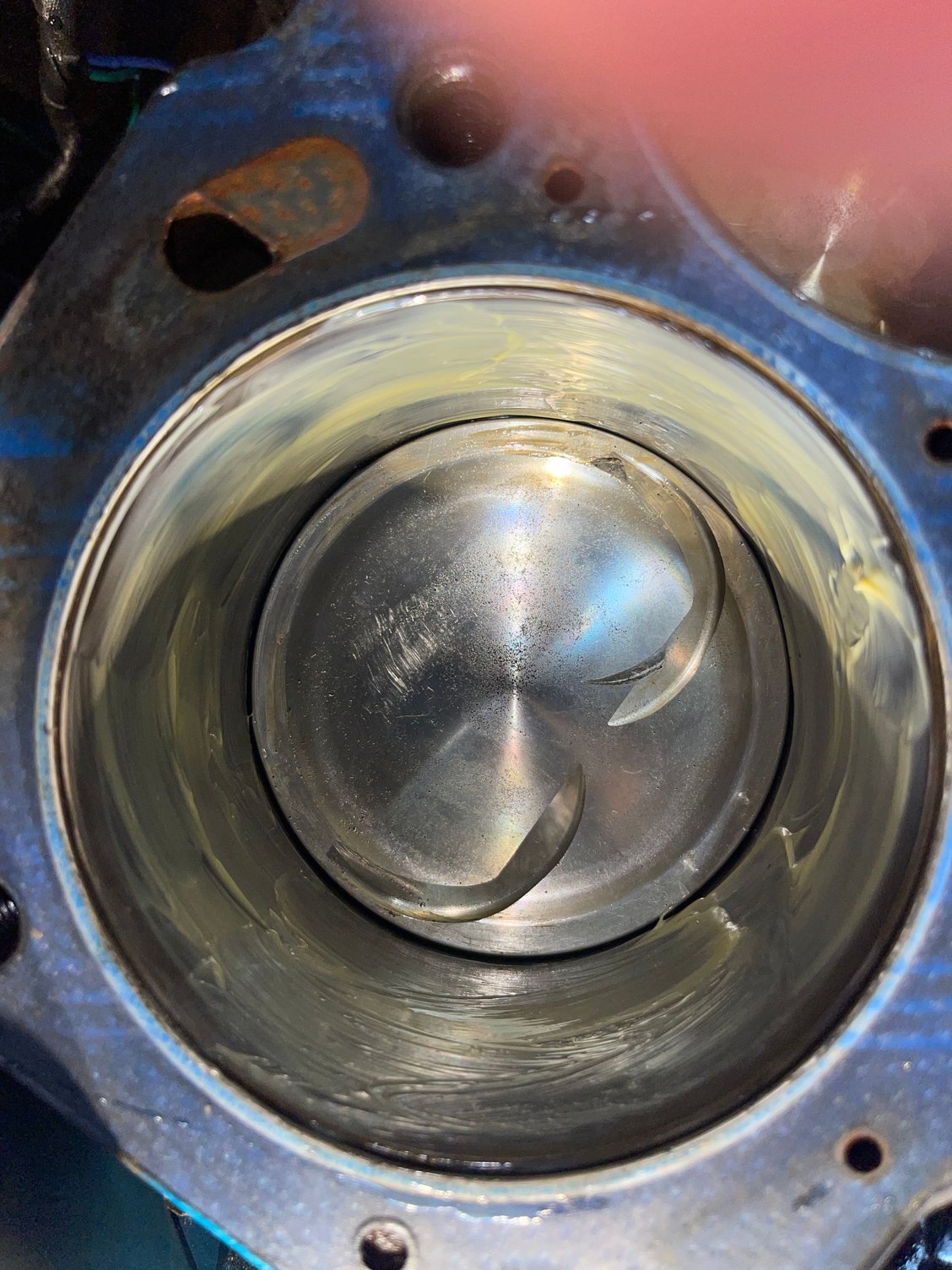

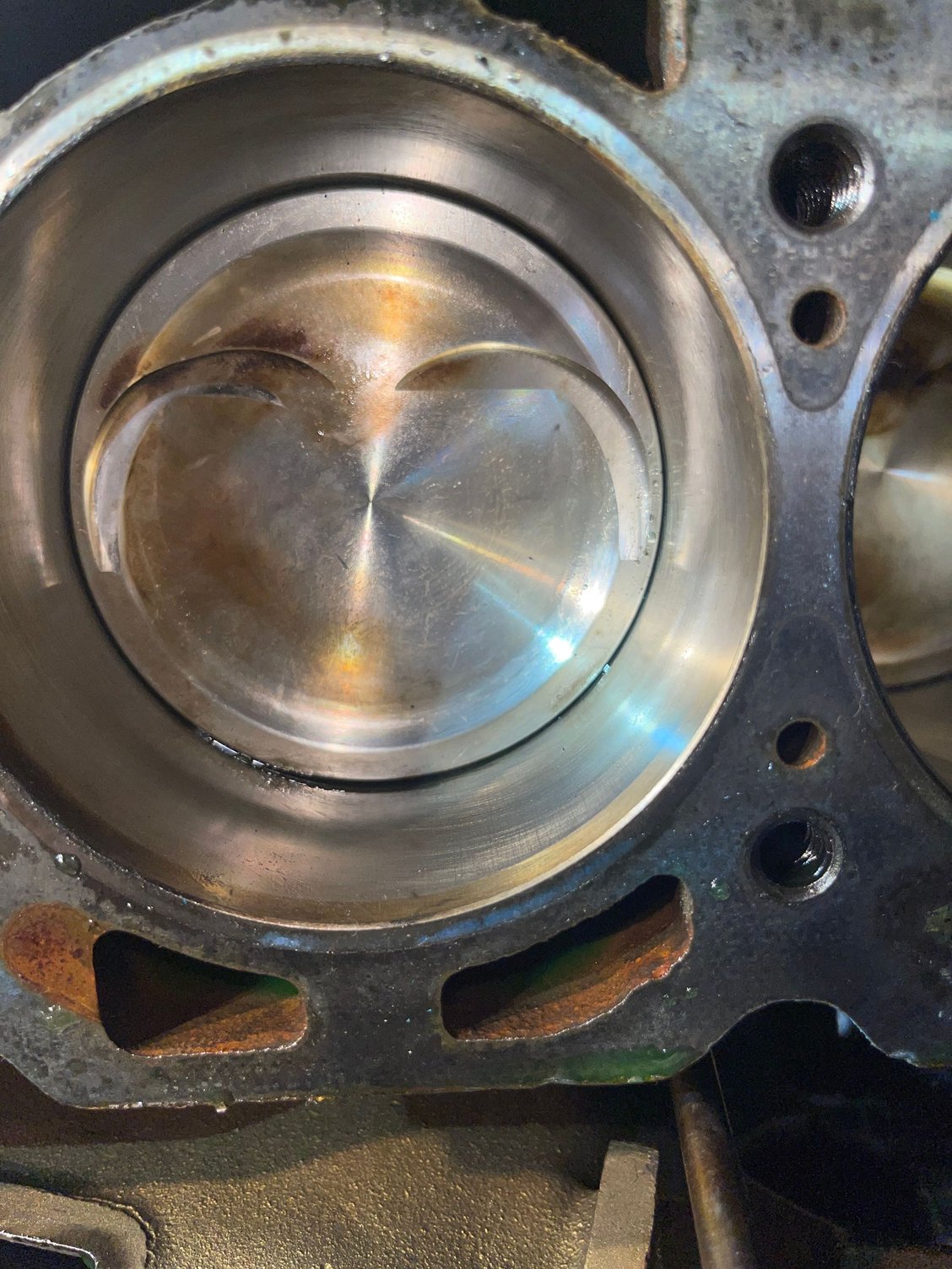

I believe the "filler" is the zinc or whatever Mark uses to block off the heat cross over in the middle exhaust ports. It appears to have melted and ran out the seat of the exhaust valve.(depending on the material used, this would require extreme heat to melt this material).
The valve has somehow struck the piston and bent, Causing a dead cylinder.
I would like to see a good picture thru the exhaust port to the back of the valve, plus a picture of the seat with the exhaust valve removed.
Id also like to see the same from the other head that didnt have a failure.
And I would like to know what material Mark used for the fill.(Thermal properties).
The improperly operating carburetor is of definite concern in this instance.

Exactly. Here are the FACTS;
The shop that filled the heads is Champion Race heads. A first rate shop that’s a major player in the Buick V6 arena. In fact they cast their own heads as well as modify OE ones as well.
Once I got the engine on my Dyno, the carb supplied by Steve, the op, was bad. I had to abort multiple Dyno pulls because it would go dead lean, to the tune of 17.1. I tried adding jet, and reducing rod sizes repeatedly and significantly, with little to no difference. I concluded there was an obvious obstruction in the carb somewhere. I called Steve and told him what was going on. After a little while he called me back to tell me he’s going to overnight a friends carb to me. I said fine I’ll give it a shot.
That carb was much better, and responded to further changes as expected. I later found out it was originally done by Cliff Ruggles some 5 years earlier. The build made 430hp with manifolds, 467 with headers. I supplied Steve with all the Dyno sheets he wanted. At that time he even contemplated putting on headers due to the increase in HP. I told him let me know as the jetting would have to be adjusted for that as well. I made approx 12-15 pulls, no further issues.
Once installed in the car, it had developed a cyl head freeze plug leak which is hard to duplicate on the dyno, as it doesn’t pressurize the cooling system. I paid for the ENTIRE repair.
He also informed me that he had sent his old carb to Phil at Custom carbs in NJ. I told him at the very least they need to duplicate what was in the carb I used on the dyno. I gave him all that info. HOWEVER in speaking with Joe at Custom carbs it seems Steve only provided cam info. Custom carbs just added a couple of jet sizes and sent it back.
Steve put it on his car and immediately told me it didn’t run the same as his friends carb. Steve Minore, a friend of his, then “adjusted” it so the secondary’s would open correctly. So it was running on the primary circuit only. Hmmm, another concern. Again not the carb it was Dyno’d with.
Later he described a driving session as “I stabbed the throttle it took off then sputtered and died”.
Here are the facts. I have the Dyno sheets and phone records of the many conversations he and I had describing EVERY aspect of this build, and the problems I encountered. That carb simply ran lean, as it did before, heated the filler beyond its original size. It then shrunk, rattled and pieces came off. Again the shop that did his heads has done literally thousands with the same filler, using the same process, even on boosted applications. No issues.
Bottom line is, his heads are fixable, and I offered to help with that, even though I truly believe this was his doing, installing a carb that had documented issues, without any type of further testing.
Now he wants me to pay for a set of Edelbrocks. Really?
In addition he keeps texting me telling me that he knows I’m a “good guy”. Yet he posts this. Confusing, very confusing.
Hope this helps clear thing up.
