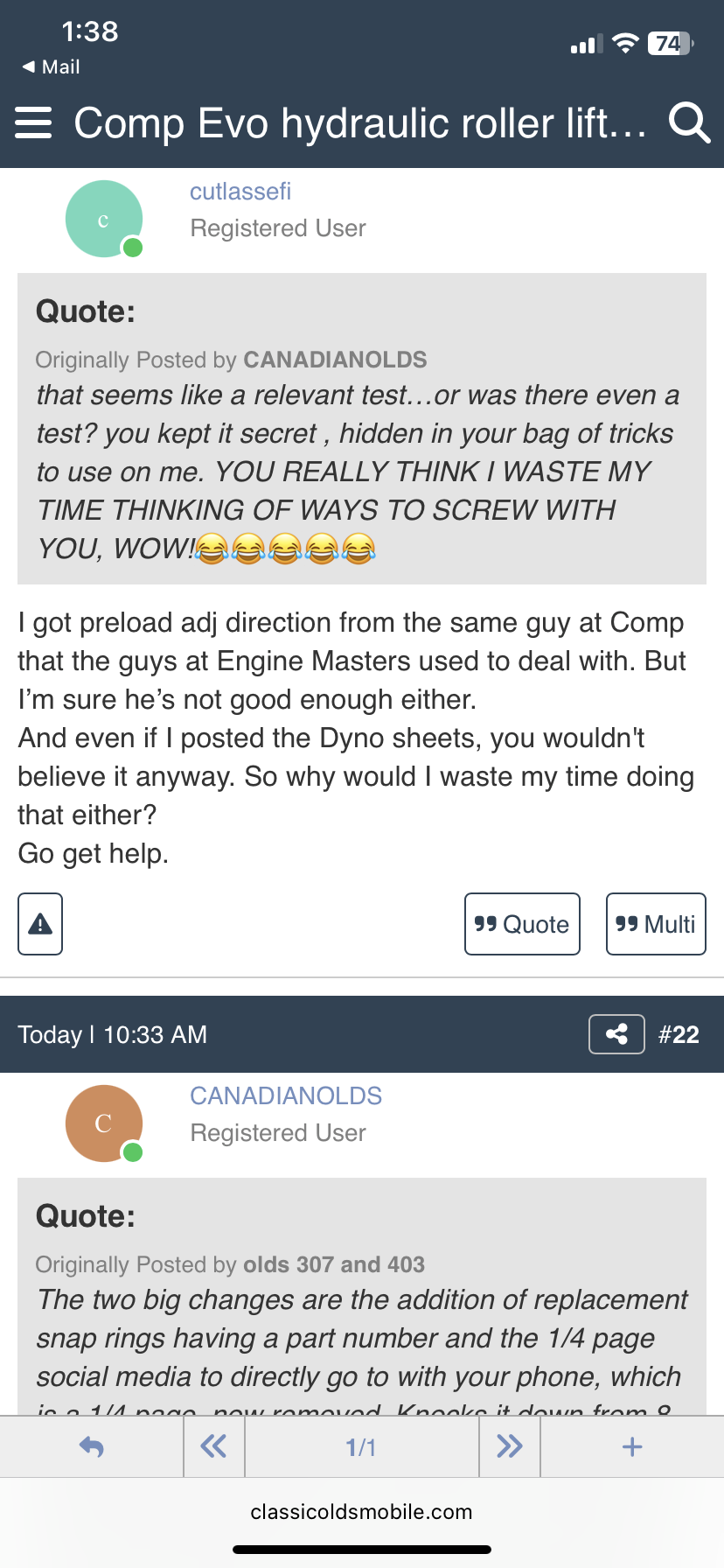

that seems like a relevant test…or was there even a test? you kept it secret , hidden in your bag of tricks to use on me. YOU REALLY THINK I WASTE MY TIME THINKING OF WAYS TO SCREW WITH YOU, WOW!😂😂😂😂😂
I got preload adj direction from the same guy at Comp that the guys at Engine Masters used to deal with. But I’m sure he’s not good enough either.
And even if I posted the Dyno sheets, you wouldn't believe it anyway. So why would I waste my time doing that either?
Go get help.

The two big changes are the addition of replacement snap rings having a part number and the 1/4 page social media to directly go to with your phone, which is a 1/4 page, now removed. Knocks it down from 8 to 7 pages. It mentions cleaning and then soaking the lifters, will soak them in new VR1, can't even get Comp Cams break in oil, as far as I know around here. I will also prime it with a drill, probably happen or multiple weekends. It will get fresh conventional VR1 10W30, once completely together at start up. I will shop vac the motor before disassembly.
they should also never be run at zero lash..they are very specific about the preload range, .040” is ideal
do the preload by using a dial indicator at the tip of the rocker on the pushrod side in-line with the pushrod. figure out how much rotation of the adjuster is need to compress the lifter .040” from zero lash. then do all the others by the same rotation of the adjust after zero lash at TDC firing. you only have to use the dial indicator on one to figure out the turn/depression set up for yours
there are way to many rocker ratios and stud thread combinations to get the .040” preload by using the common turns past lash set up….even though in the latest instructions they tell you to go 3/4 turn for 7/16 20 and 1 turn for 3/8 24 studs.
