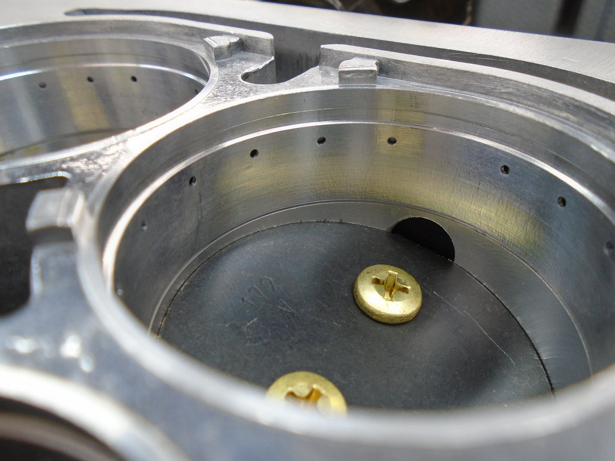

On E85, I expect it to get COLD - REAL COLD at the bases of the throttle bodies, possibly even frosting up some until the engine warms up. The particular NASCAR design based throttle bodies I am using have a number of laser drilled fuel output jets right below the throttle butterflies that are fed by high pressure injectors (not anything like the low pressure designs of years prior) - see images below. This is going to create a very cold dense fog of highly cooled atomized E85. One problem is that E85 isn't readily available everywhere, even in this area, so I have to set it up for flex fuel (with a sensor in the fuel line that sniffs out how much alcohol is in the fuel) and carefully tune it to handle E85 AND premium gasoline (and any variation of mixture in between). A lot of E85 in this area has been busted as being closer to E65 which makes no sense. I do intend to initially run without the methanol injection to see how it will behave, though suspect a hot day running with the A/C on and "only" gasoline in the fuel tank will need to spray (essentially windshield washer fluid) into the mouths of the superchargers (instead of between the superchargers and the engine). This will also further atomize the mixture of methanol being injected by the vanes inside of the superchargers at high speeds (without dragging them down), also helping to keep the impellers and the insides of the housings cool and clean (as air filters do not catch everything no matter how good they are).
See all of the laser drilled fuel output holes that exist right below the throttle butterflies?
Until the engine warms up, I expect some frosting to occur with the E85 being finely atomized, spraying out of these annular fuel discharge holes fed by high pressure MPFI type fuel injectors.

Arrow Combustion Chambers
Yes, Mark did charge me some hefty extra coin to open up the combustion chambers, contrary to what most people are doing in attempts to increase compression as I am needing to lower the compression to my target of 9:1 optimized for supercharged use. The enlargement of the combustion chambers wasn't so much as to increase their depth, instead increasing their perimeter, especially on the sides closest to the valves. Anything near the valves such as a combustion chamber wall, or in the case of a 455 with its smallish 4.125" cylinder bores, will impeded valve flow at the sides of the valves. With the widened combustion chambers running on the larger 4.350" bores, there will be an increase in flow.
HERE IS AN OUT OF THE BOX SPEEDMASTER OLDS COMBUSTION CHAMBER:
Out of the box Speedmaster Olds chamber with the 2.072" intake valve / 1.680" exhaust valve
HERE IS THE ENLARGED CHAMBER:
Enlarged / widened chamber with the 2.125" intake valve / 1.680" exhaust valve
If I understand correctly, this widening of the chambers added a $1000 +/- to the bill. What still has me flummoxed is the walls of the chamber have been moved away from the exhaust valves, the bowls and ports have been worked, yet still only flowing 180 CFM according to the data Mark provided. It won't be long before I see what Reed (Grant Racing) has to say after examining the exhaust ports. He said "bring them to me and I will tell you what's wrong", so fingers crossed that he points out what the deficiencies are in these ports and can mod one and flow it. Once it's determined as to what they will respond to on one port, I'll spank them apart and get busy on the rest of them as Reed is busy as busy gets, backlogged well beyond my target timeframes. I know my way around cylinder head porting very well, have all of the extended reach various carbide bits, and will let the aluminum fly. With a little bit of luck x experience, I will run them back over for Reed to review when I am done, and he will either say "that's it, let's flow them" or send me back to the drawing board with further instructions. I sure wish I had a flow bench!
