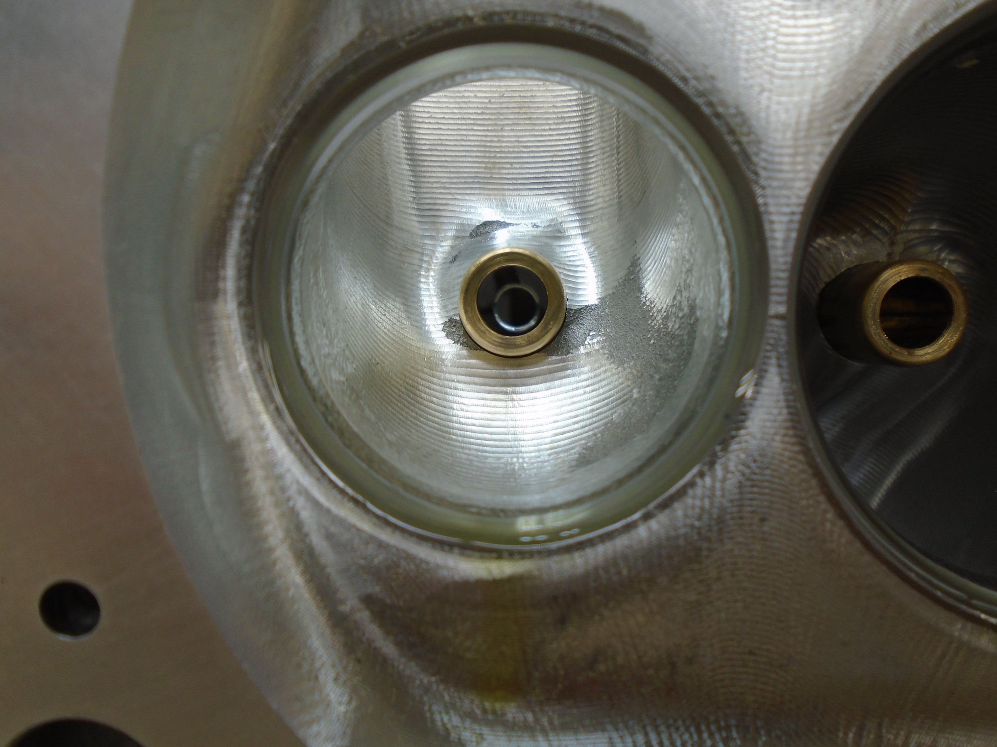

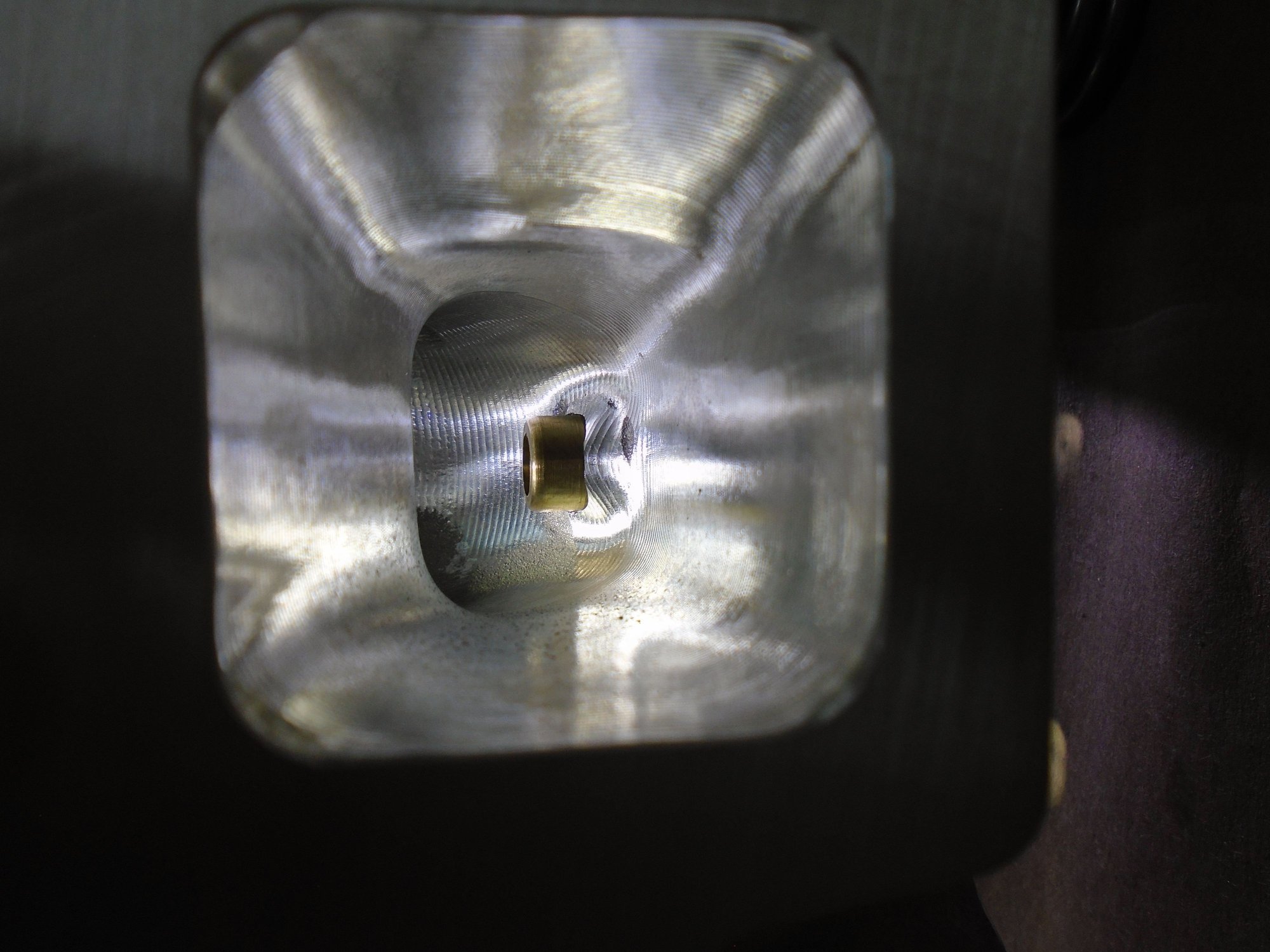

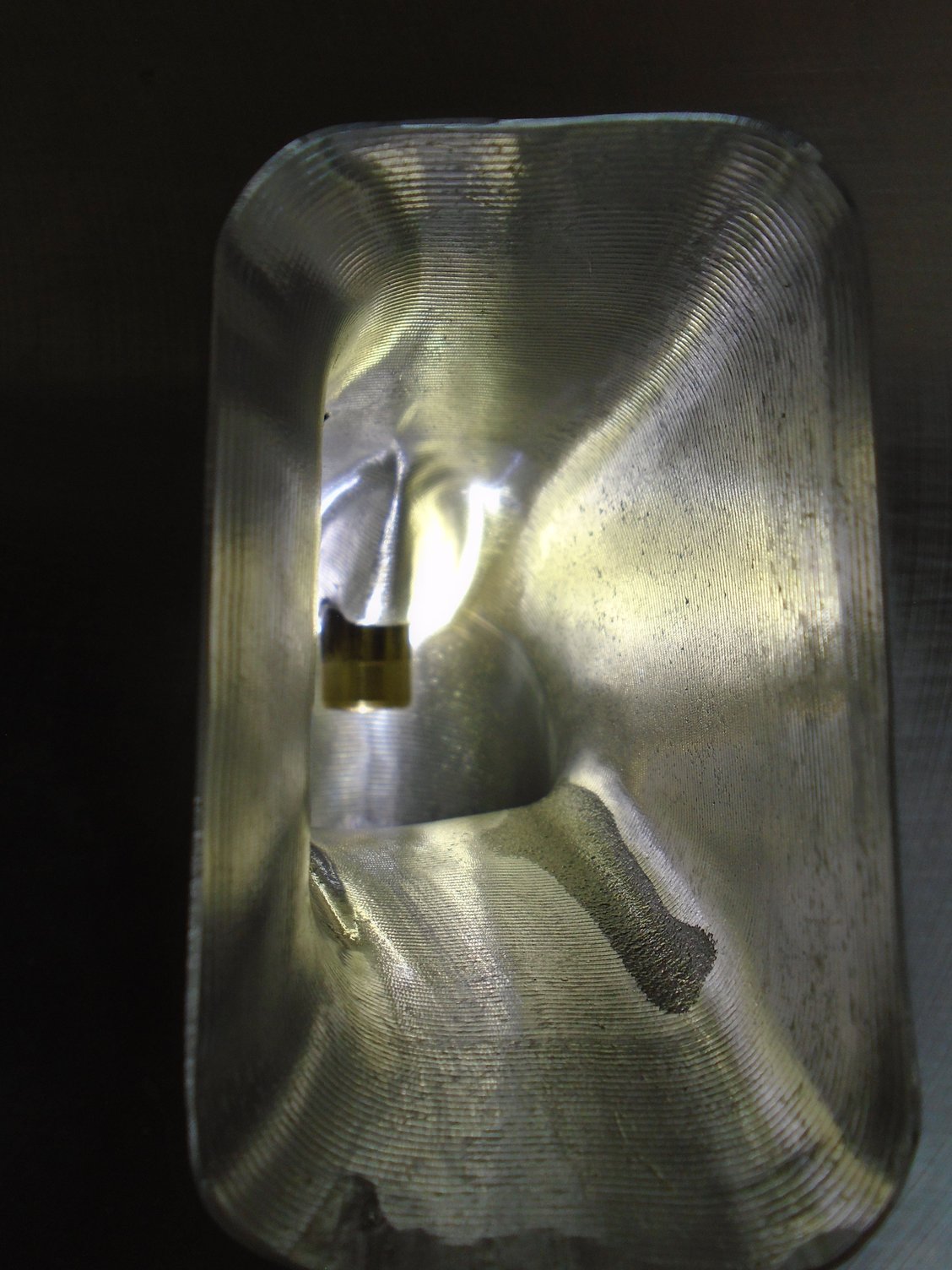

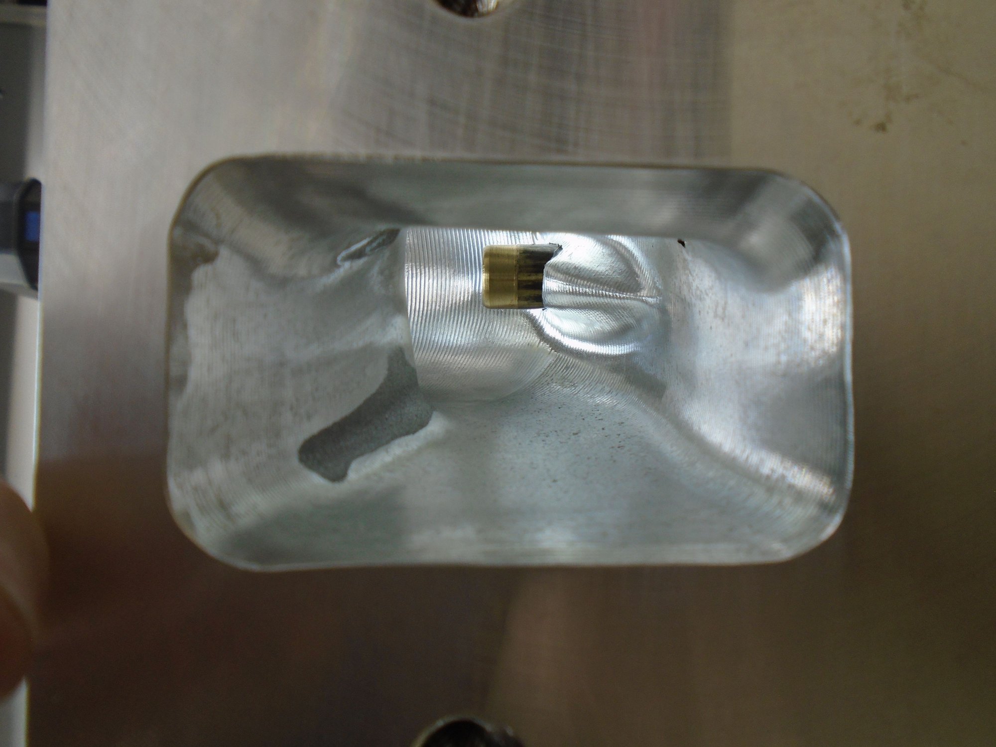

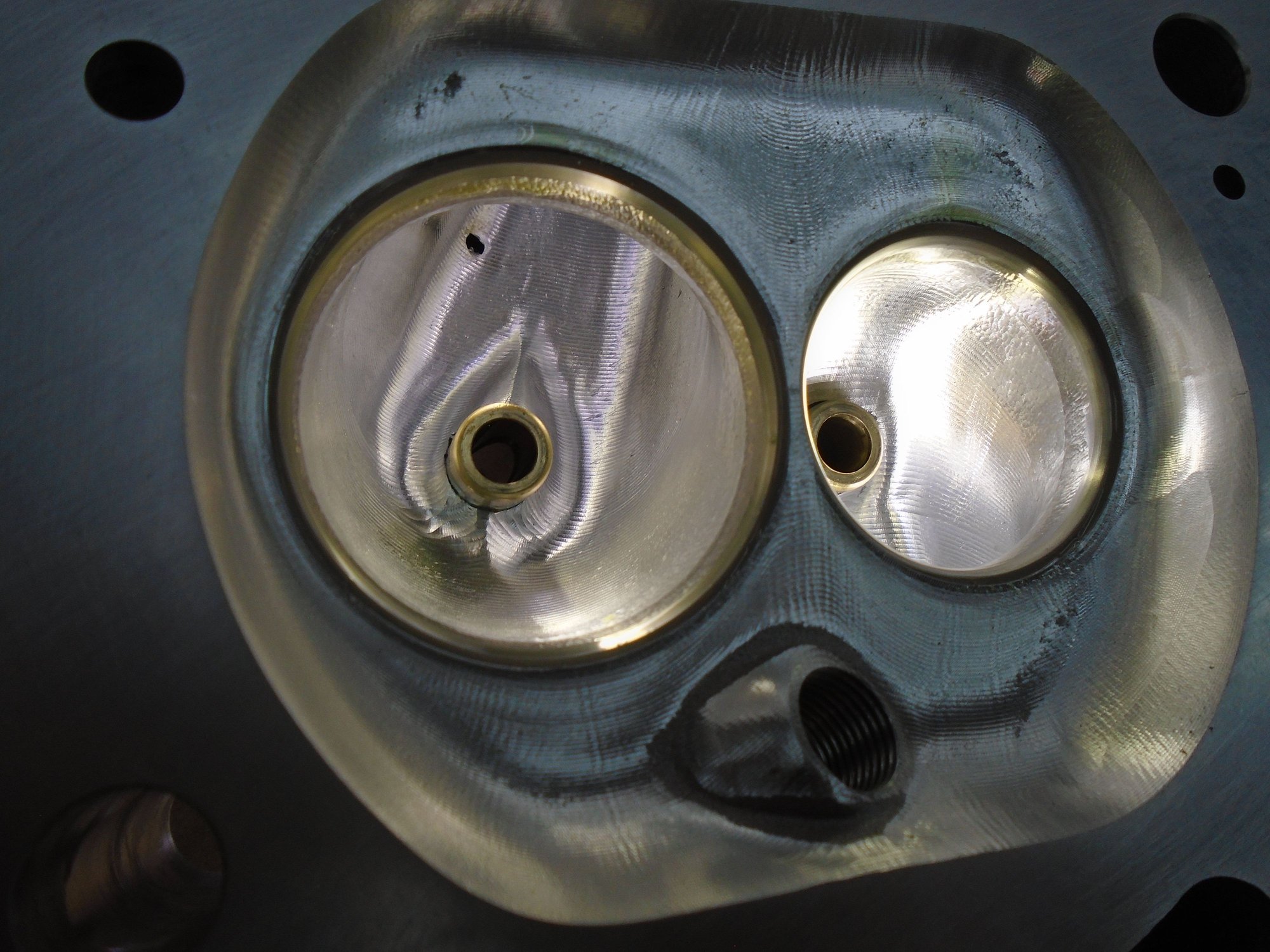

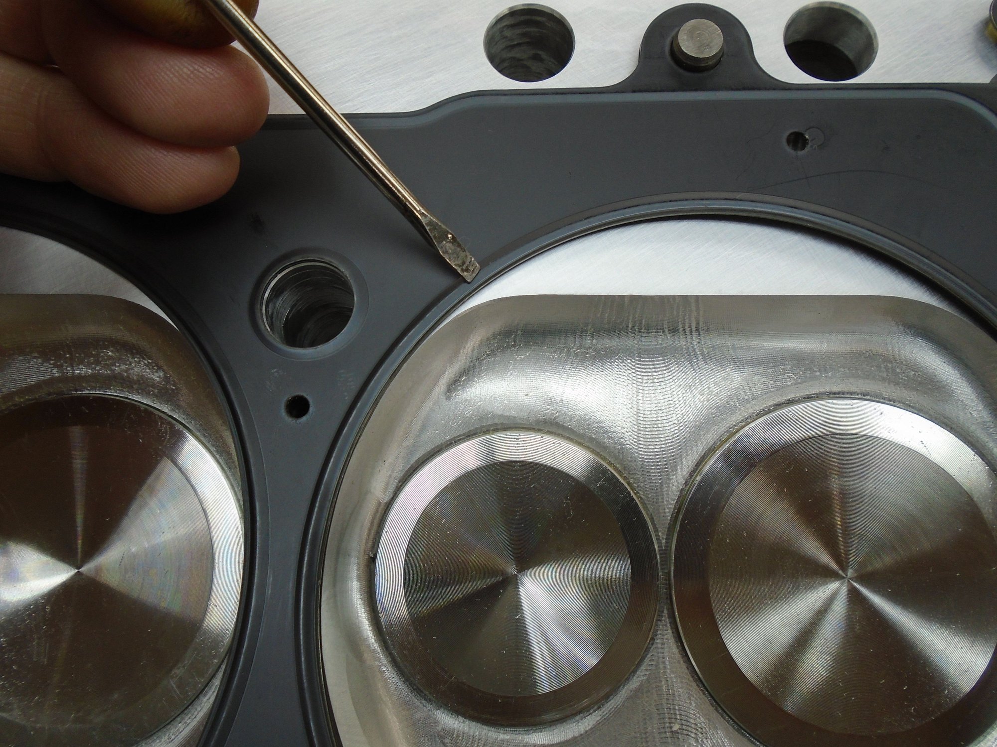

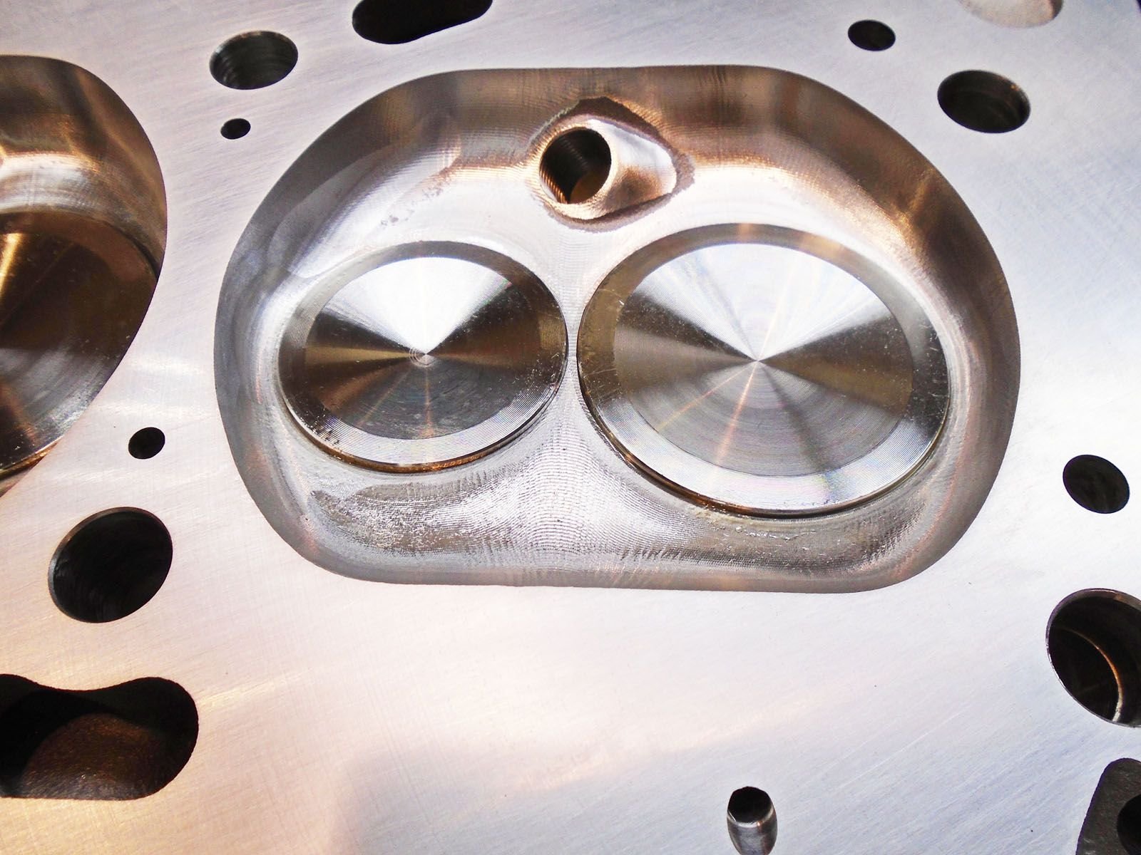

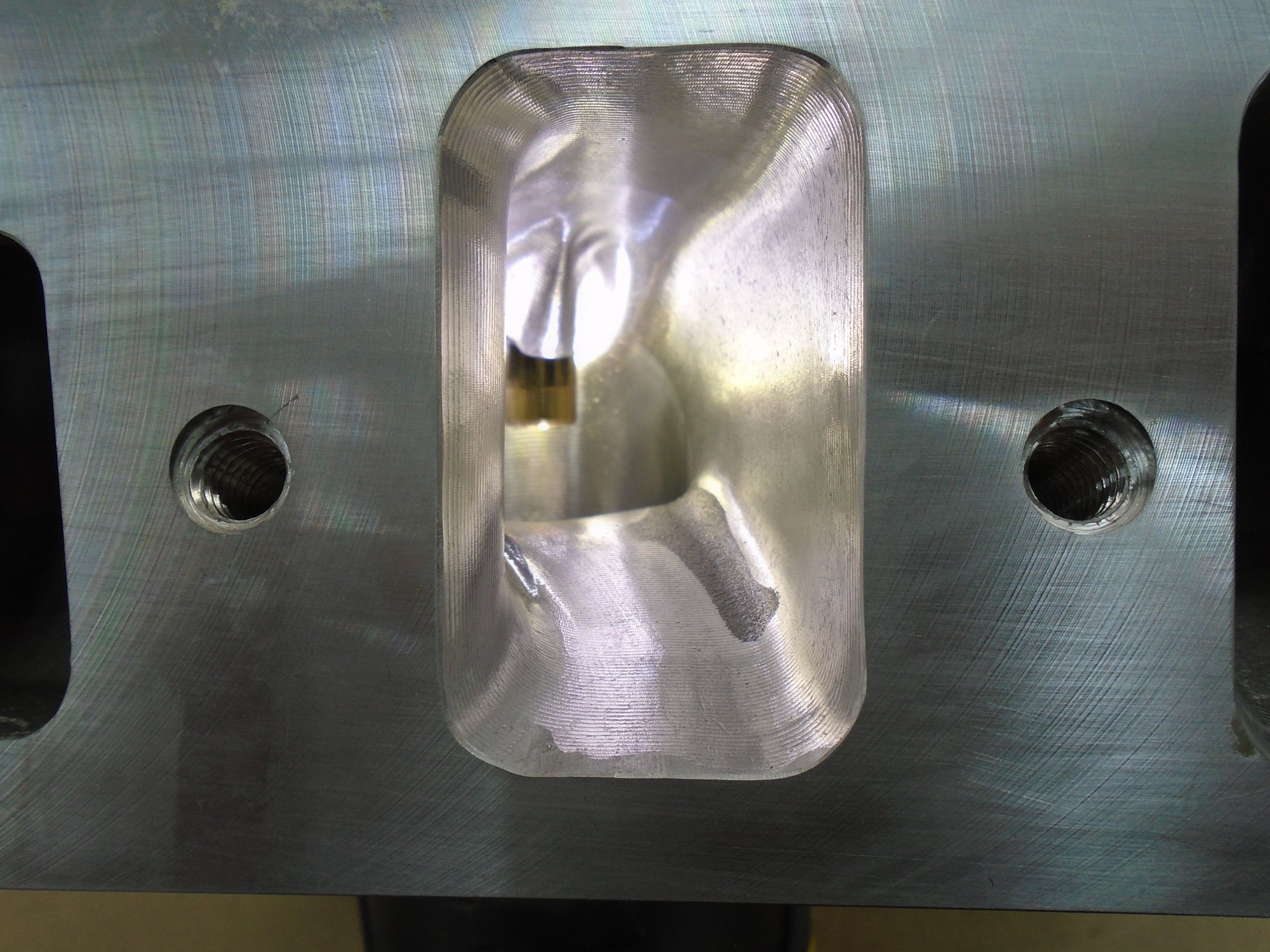

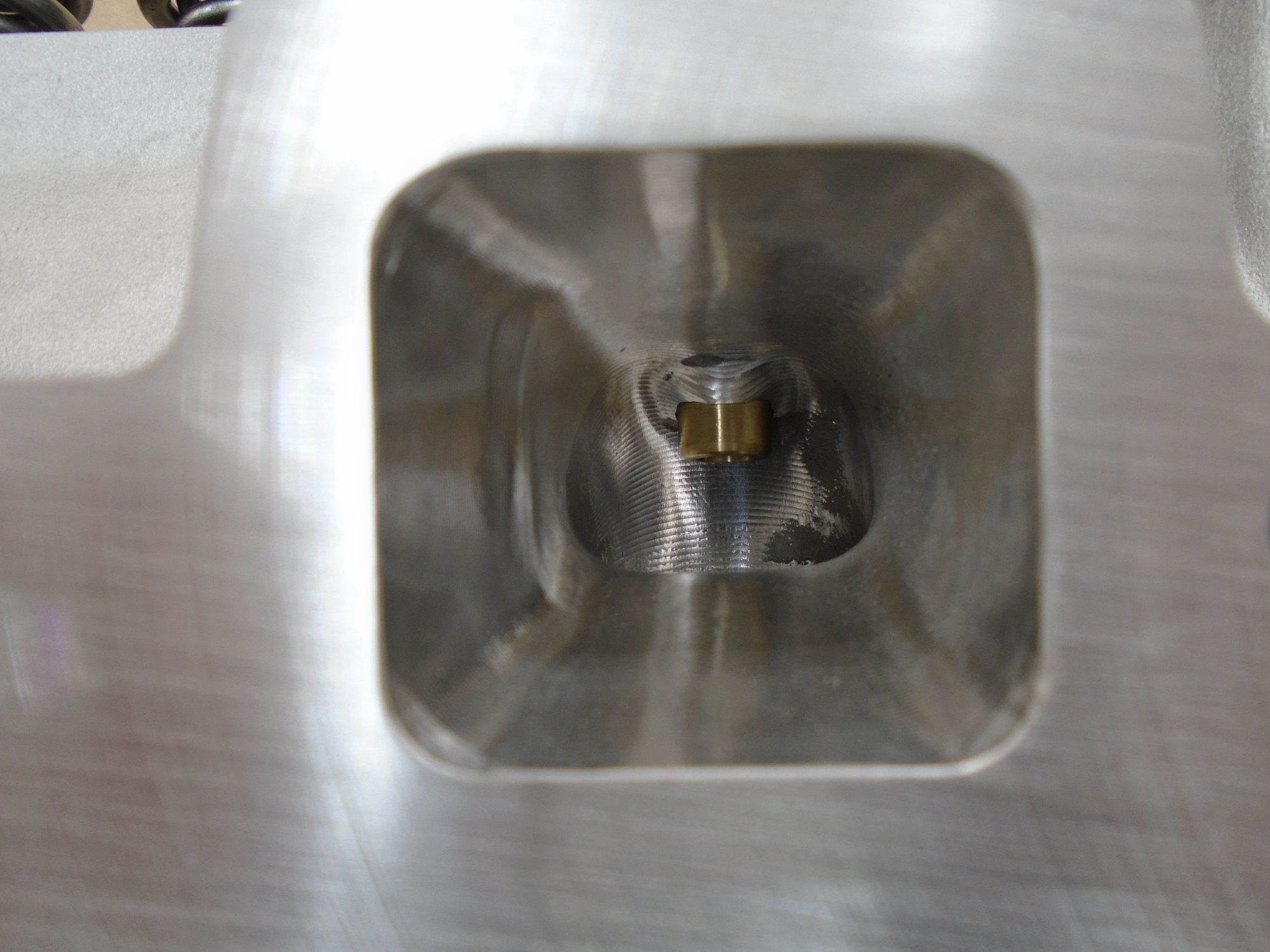

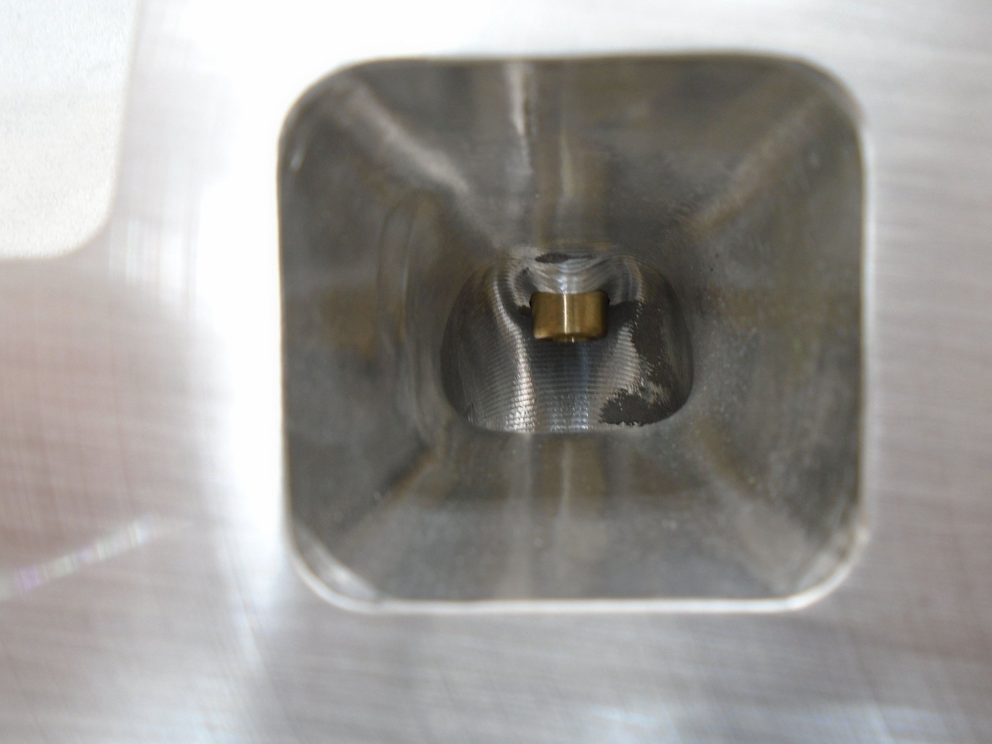

Question CNC Ported Edelbrock Heads

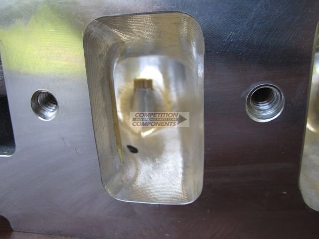

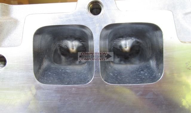

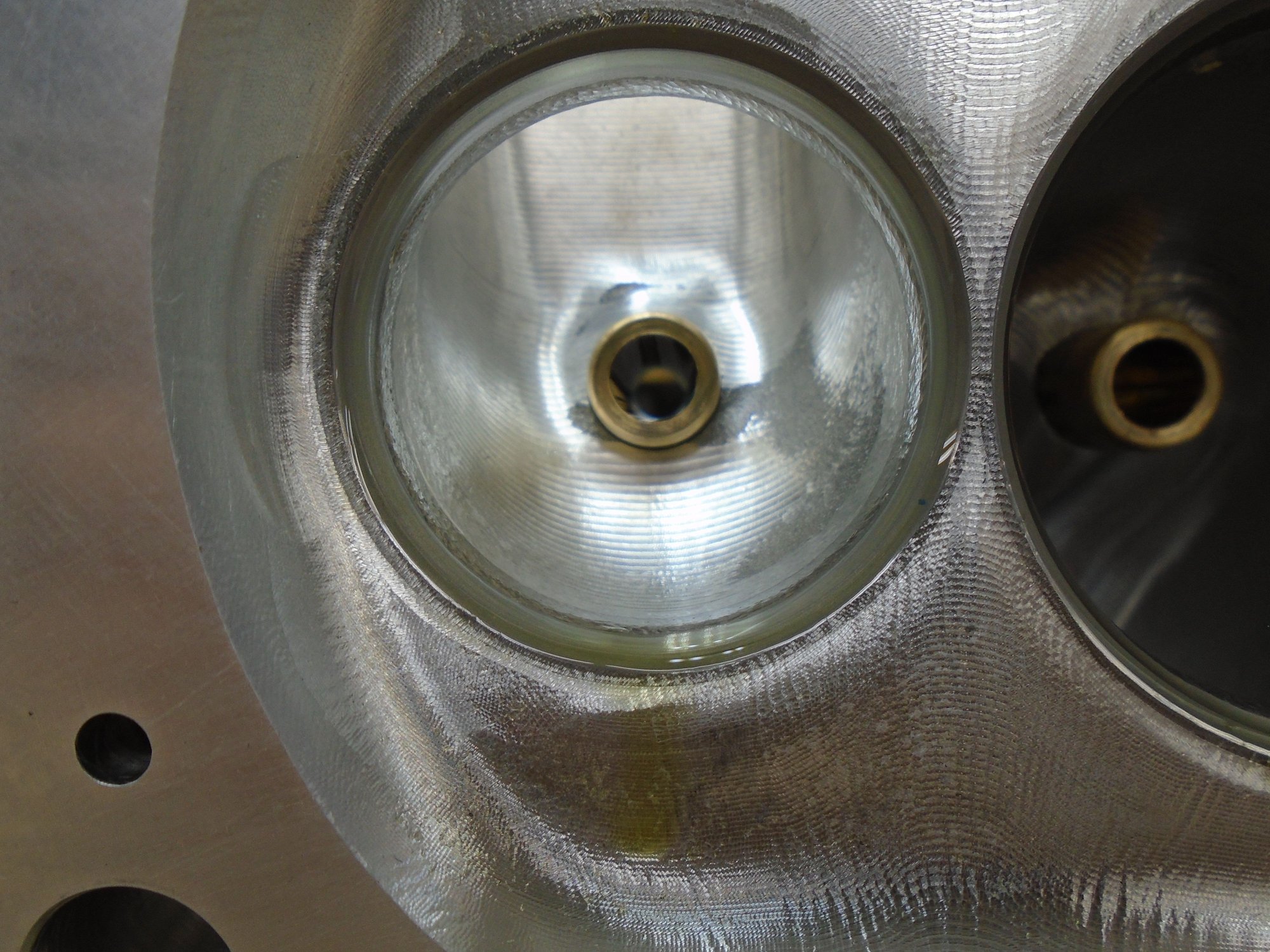

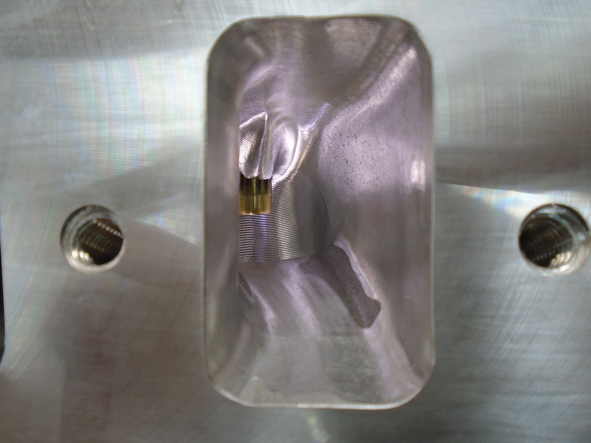

Competition Components in Michigan
Not too shabby, with pushrod tubes that you just about can't get away from on the Olds

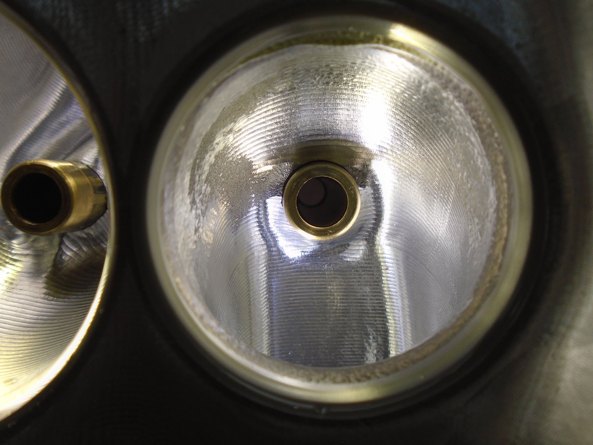

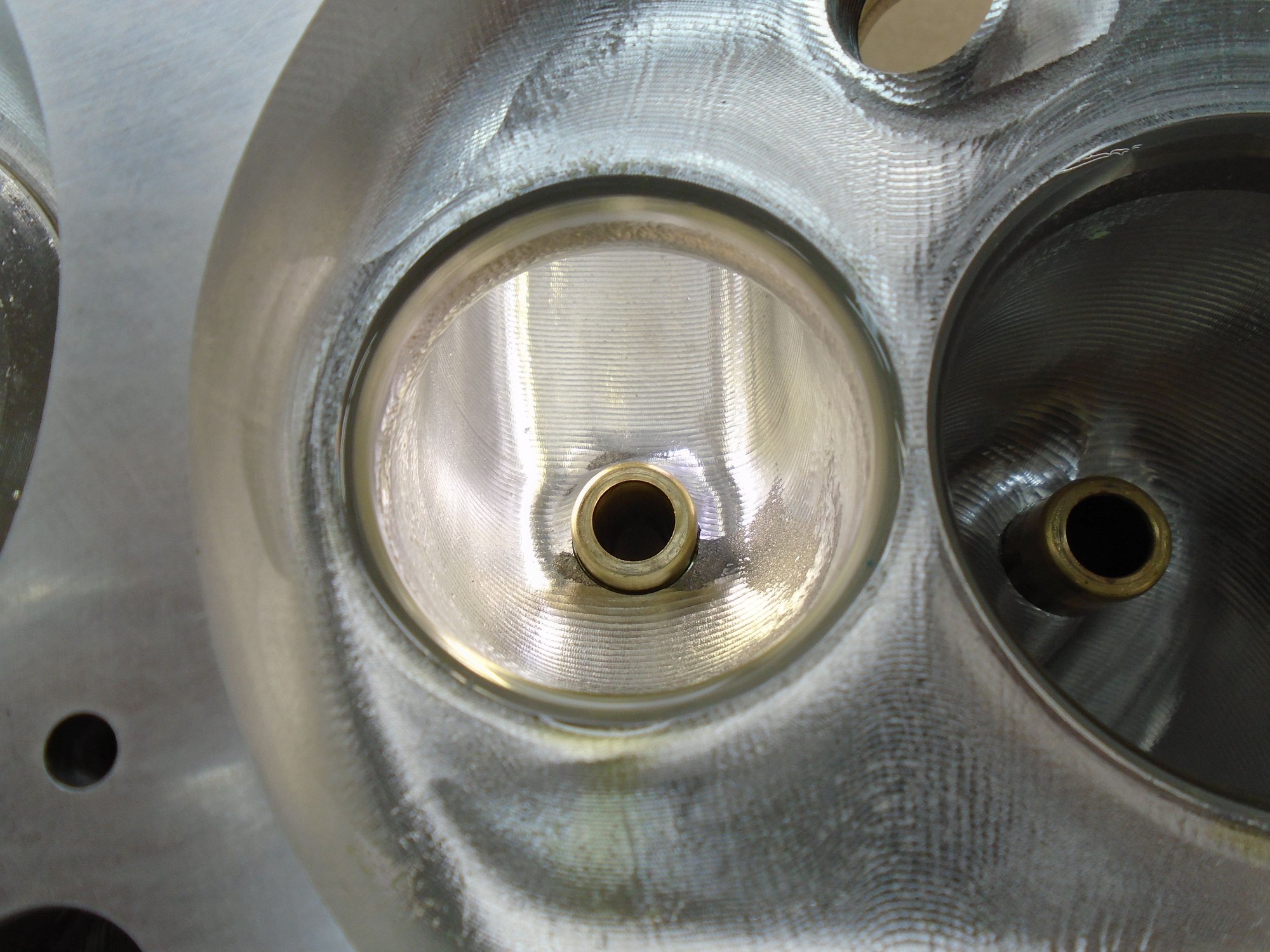

Decent seats and bowls
Exhaust looks decent - too bad there is a head bolt that exists between the two ports, but wonder what raising the roof on the ports may show on a flow bench? Looks like there is still a pretty good amount of casting thickness there to still work with.

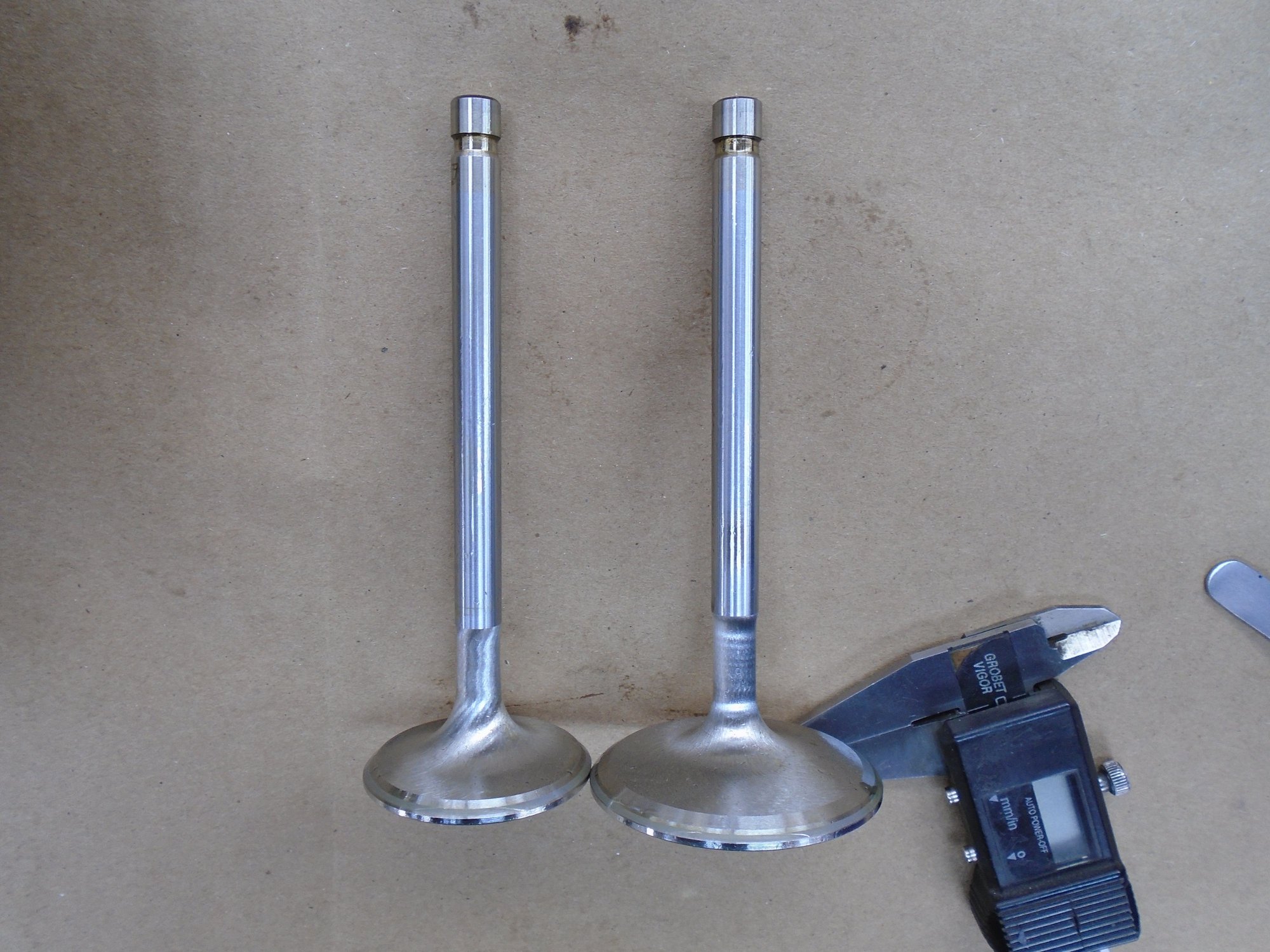

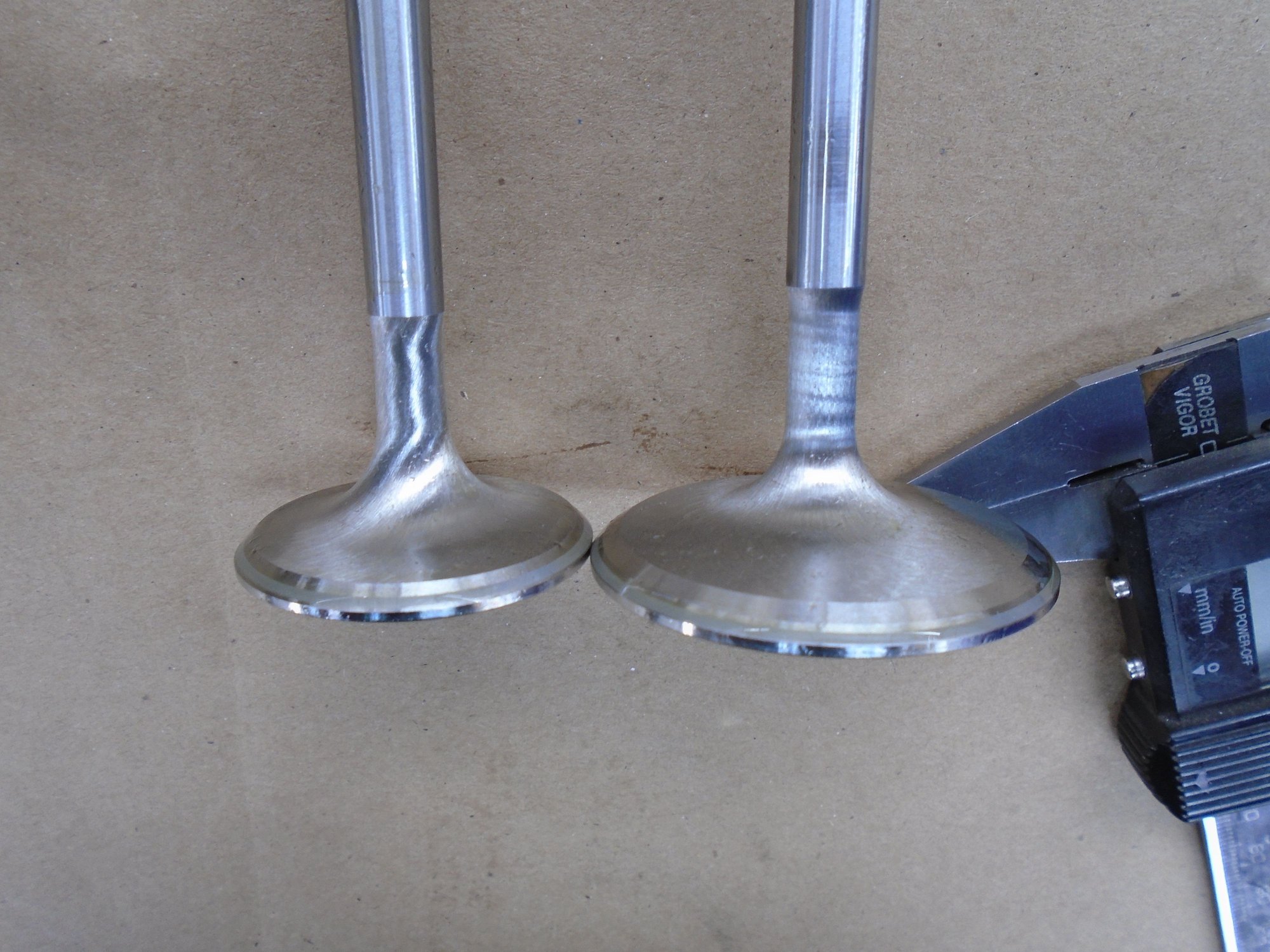

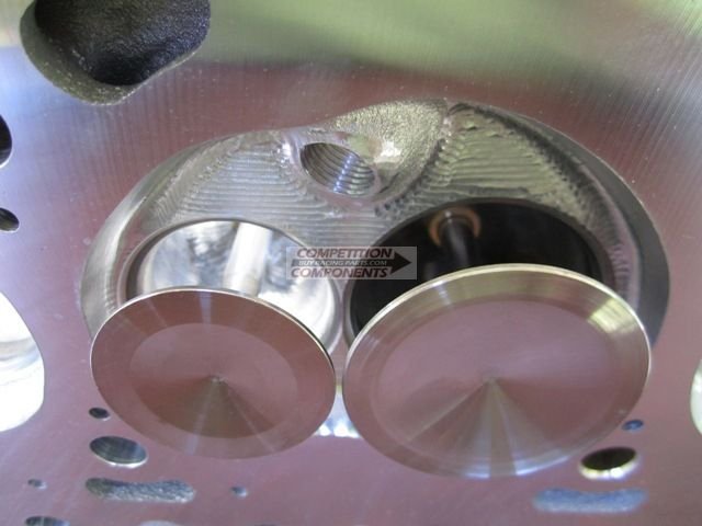

Good sized valves 2.125 Intakes, 1.710 Exhausts

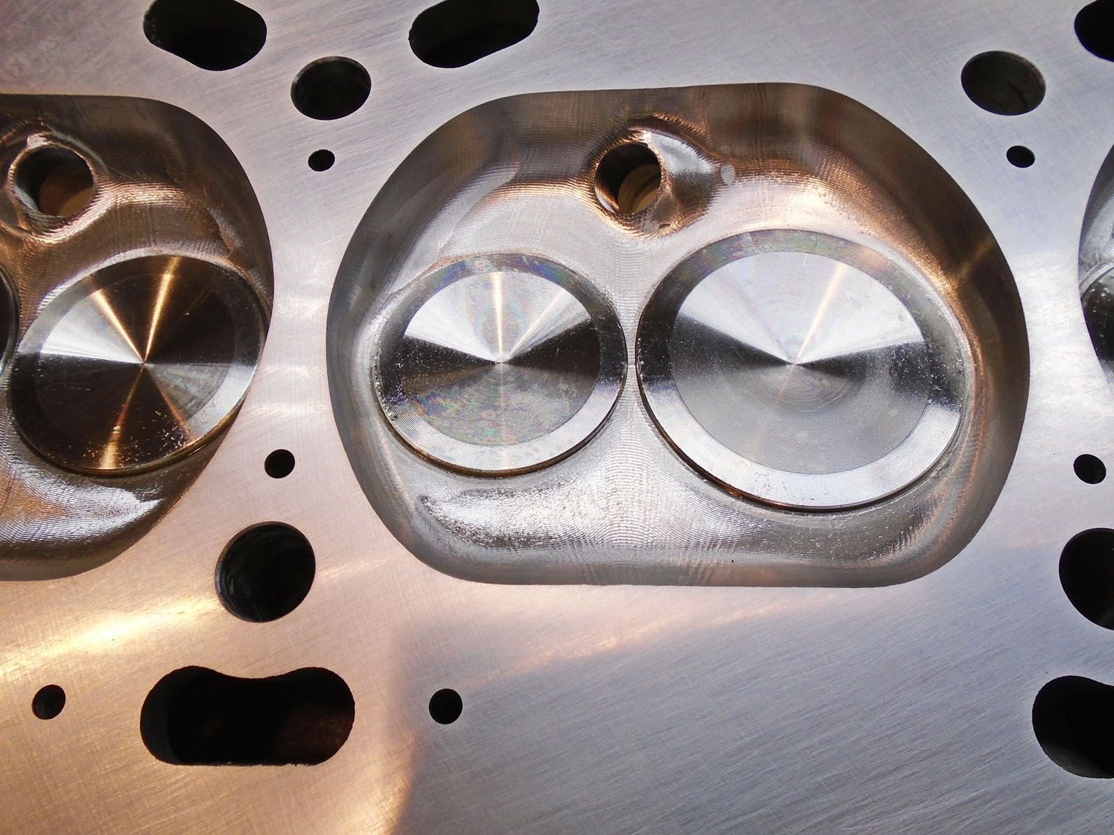

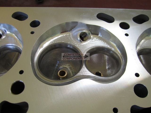

But why leave the chambers with such a coarse seemingly partial finish? It's just a matter of programming, so why not have it make a few more finish passes to smooth the chambers out to help eliminate any possible hot spots?

I don't recognize their work - suppose these are being done in house? Or does anybody recognize them? It's like a fingerprint, you can always tell if you have seen it before elsewhere.
I recently had a set of Speedmasters CNC ported for the Twin TorqStorm build, though they ended up falling short on the exhaust side, so will use them on my 488 instead - they will run very well on that engine. So just digging around looking at other head options for getting the most exhaust out of the cylinders as possible. Intake is no problem, as it's going to be shoved in at 15 +/- pounds of boost - getting it out the exhaust side is the challenge. The heads I had done ended up only managing 180 CFM at .600", while these Edelbrocks are at least coming in at 209 CFM at .600" - almost 30 CFM better. If I can't get the exhaust out, I can throw all the boost I want at it, but it will be directly limited to what it can exhale.
Yeah, just me thinking out loud. Anybody know of a conventional Olds head that can do better on the exhaust side? That's where I need to focus my attention, so let me know who's been able to accomplish the best work on the exhaust side that you may be aware of. I did see that Chadmans exhaust hit 240 CFM on his highly worked Wensler / RR heads with very high lift. Thanks!

Wonder why the exhaust valve is so big?

Chamber finish might be a matter of having the right tool to make a nicer finish on that surface. It's not particularly easy because you're mostly cutting on the end of the tool but also hitting the sides due to the contours.
Intake flow seems pretty high to me. Not impossible, but definitely impressive. There's not enough exhaust roof room to do much of anything worthwhile. The entire port needs to be moved like in a Batten. I got nearly identical exhaust numbers with just Dumbass Home Porting..
"Conventional", meaning OEM cast iron head doing better? No. Battens would do better, but then you're in the world of Batten stuff. Or for those that are real serious, custom billet heads like what the Hunts are teasing everyone with.

That larger exhaust valve is right up my alley, 209 CFM at .600"

Still finalizing it but I’m not using the stock 2.150 intake or 1.68 exhaust valves for a variety of reasons.

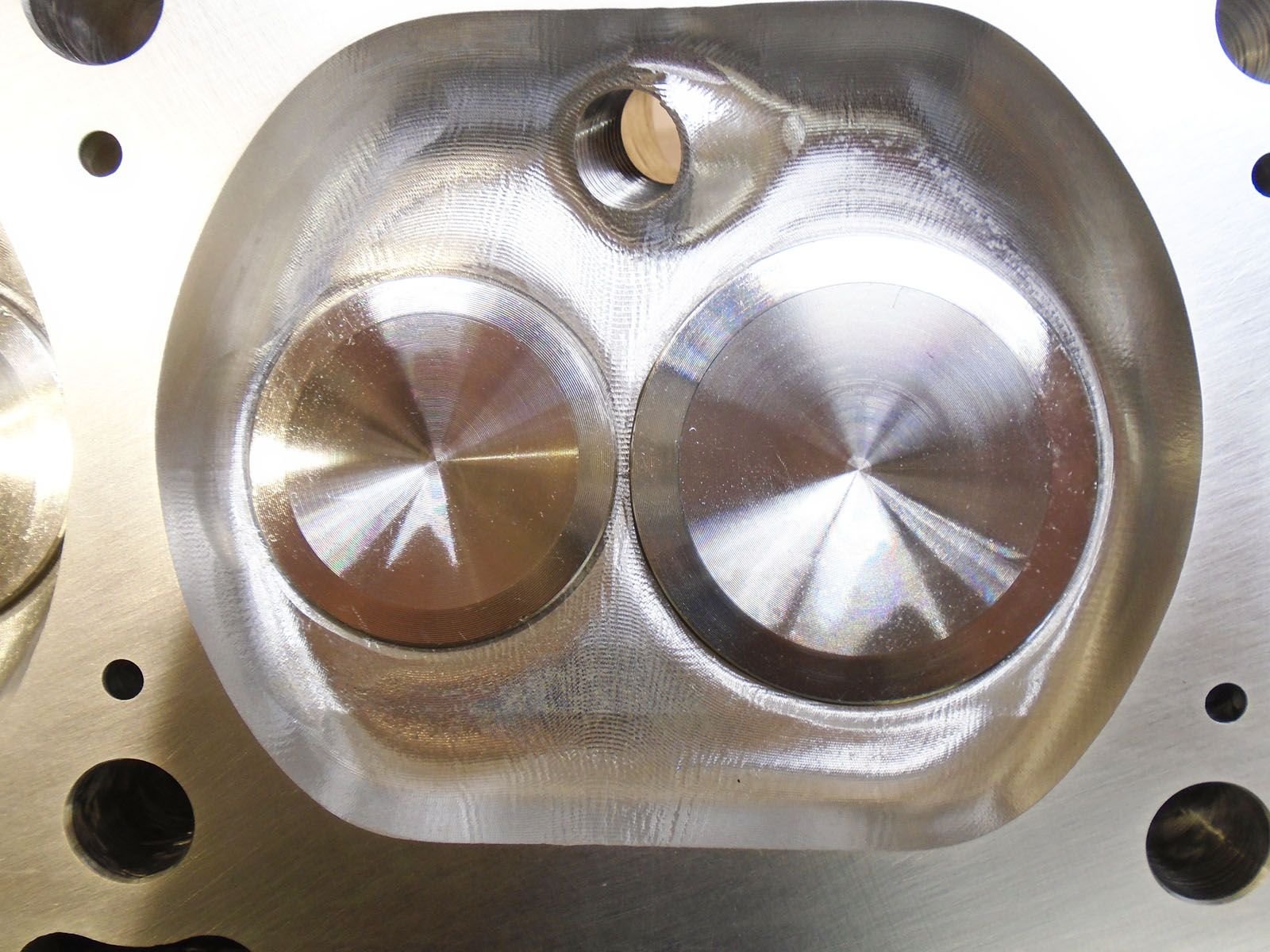

As a point of information here from a retired machinist, I can see differences between the heads in this thread and the ones Mark Remmel does. I haven't seen a close up off Travato's CNC work,
I can tell you the heads shown in this thread he was using a Ball End, End Mill. The spacing between machining passes shows its a wider pass than Mark's heads. I also wonder if he is using a 2 Flute End mill or he is pushing the feed rate and thats giving the coarse texture in the combustion chamber. And also notice the cutting tool "Chatter" in the radius between combustion chamber roof and the sides.
.....Just my two cents worth.

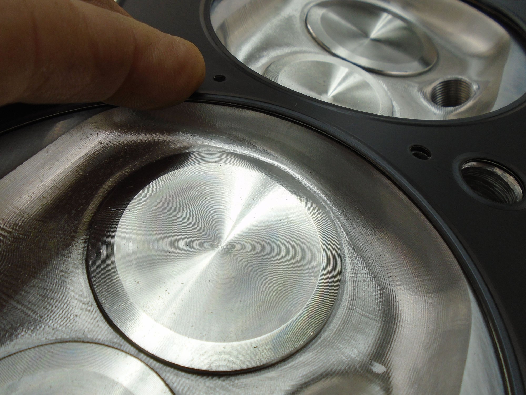

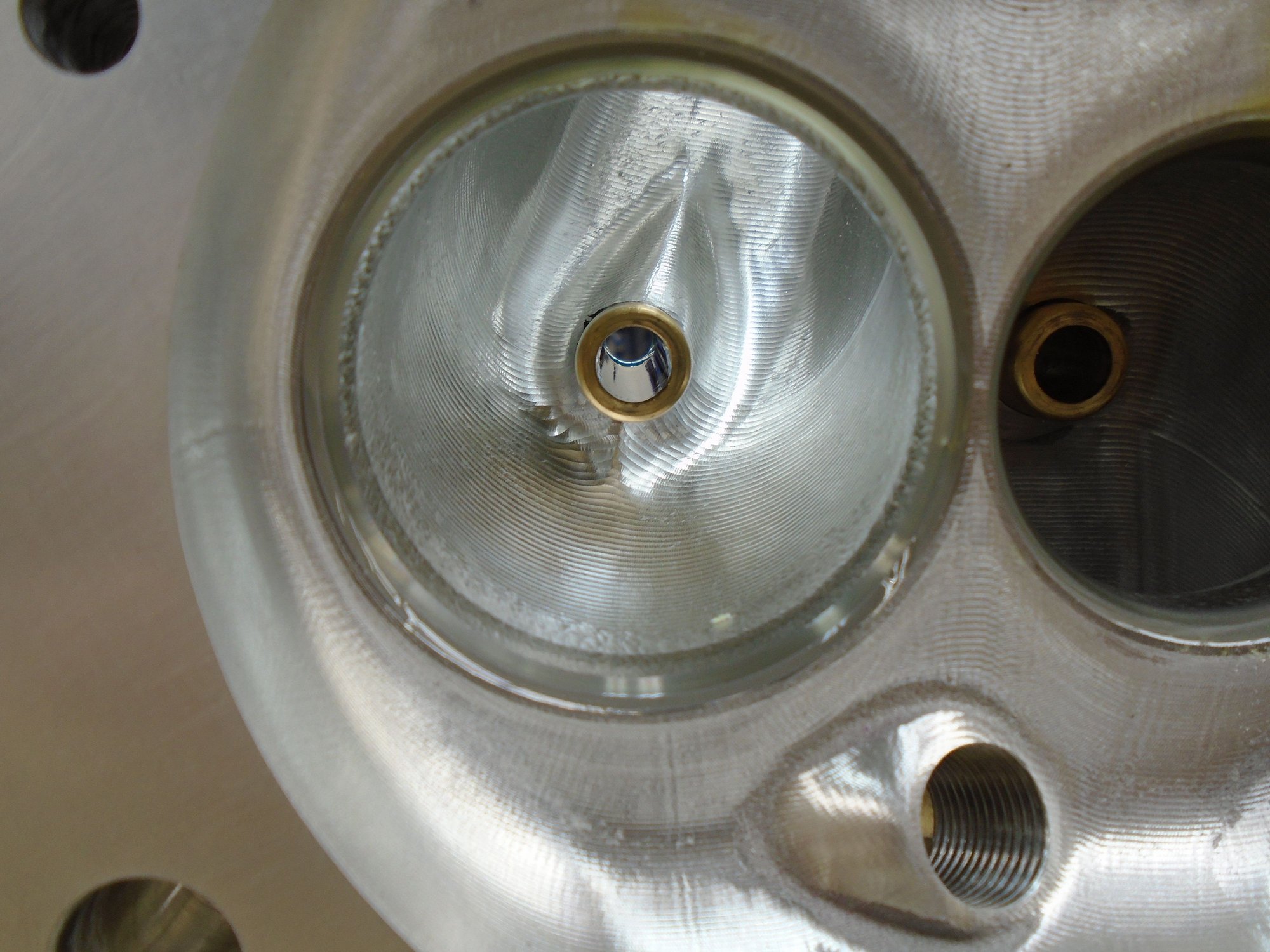

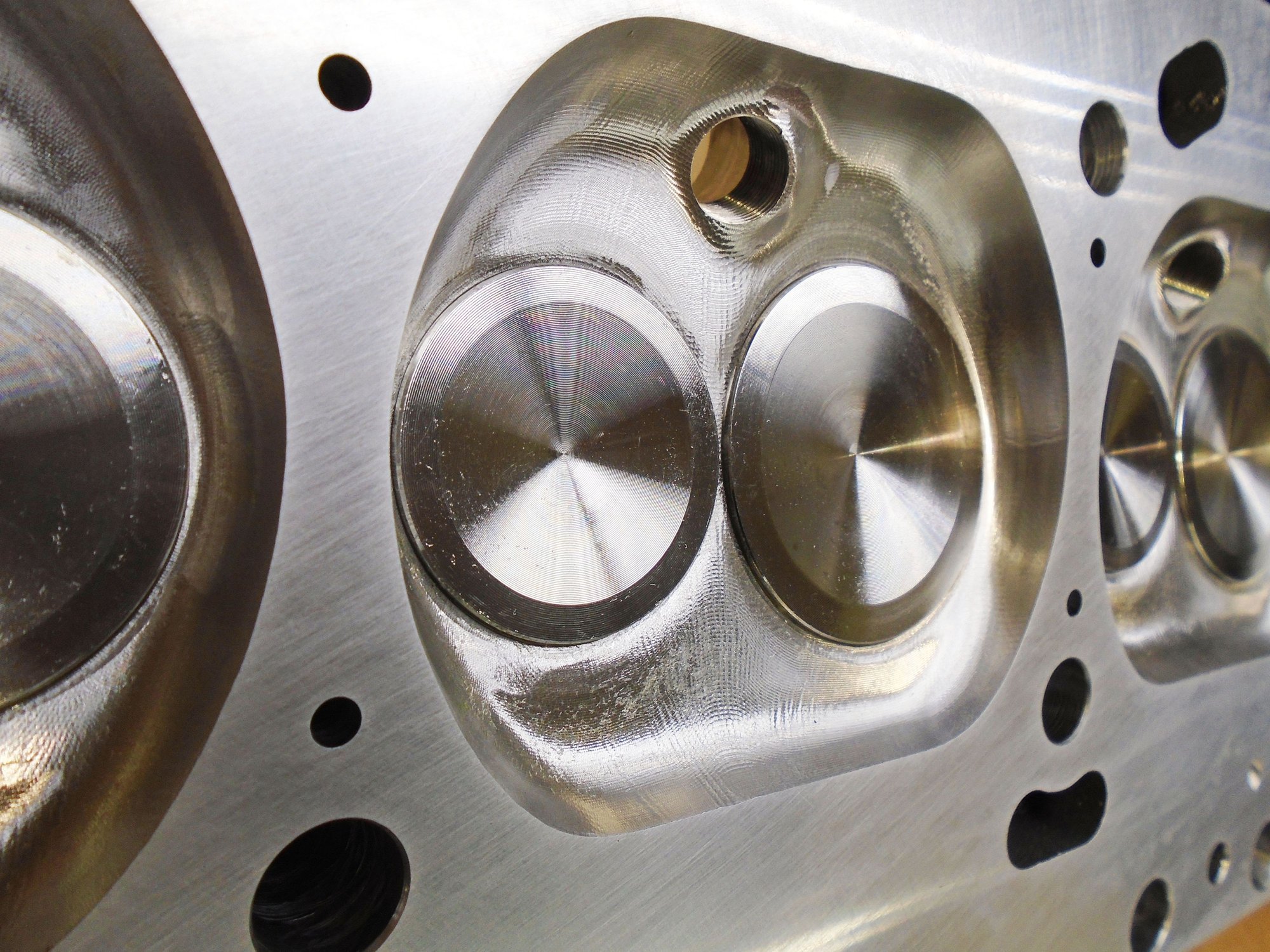

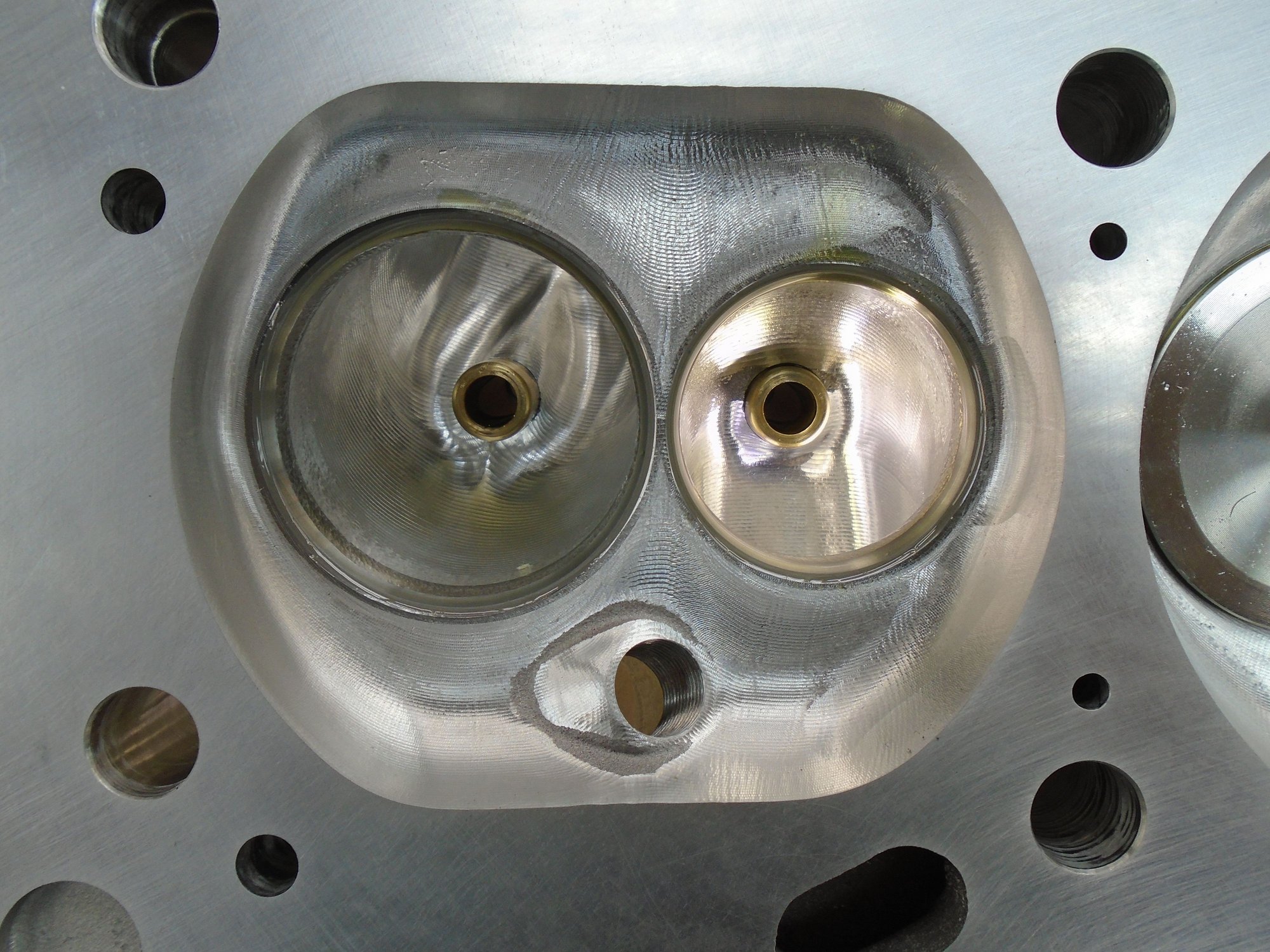

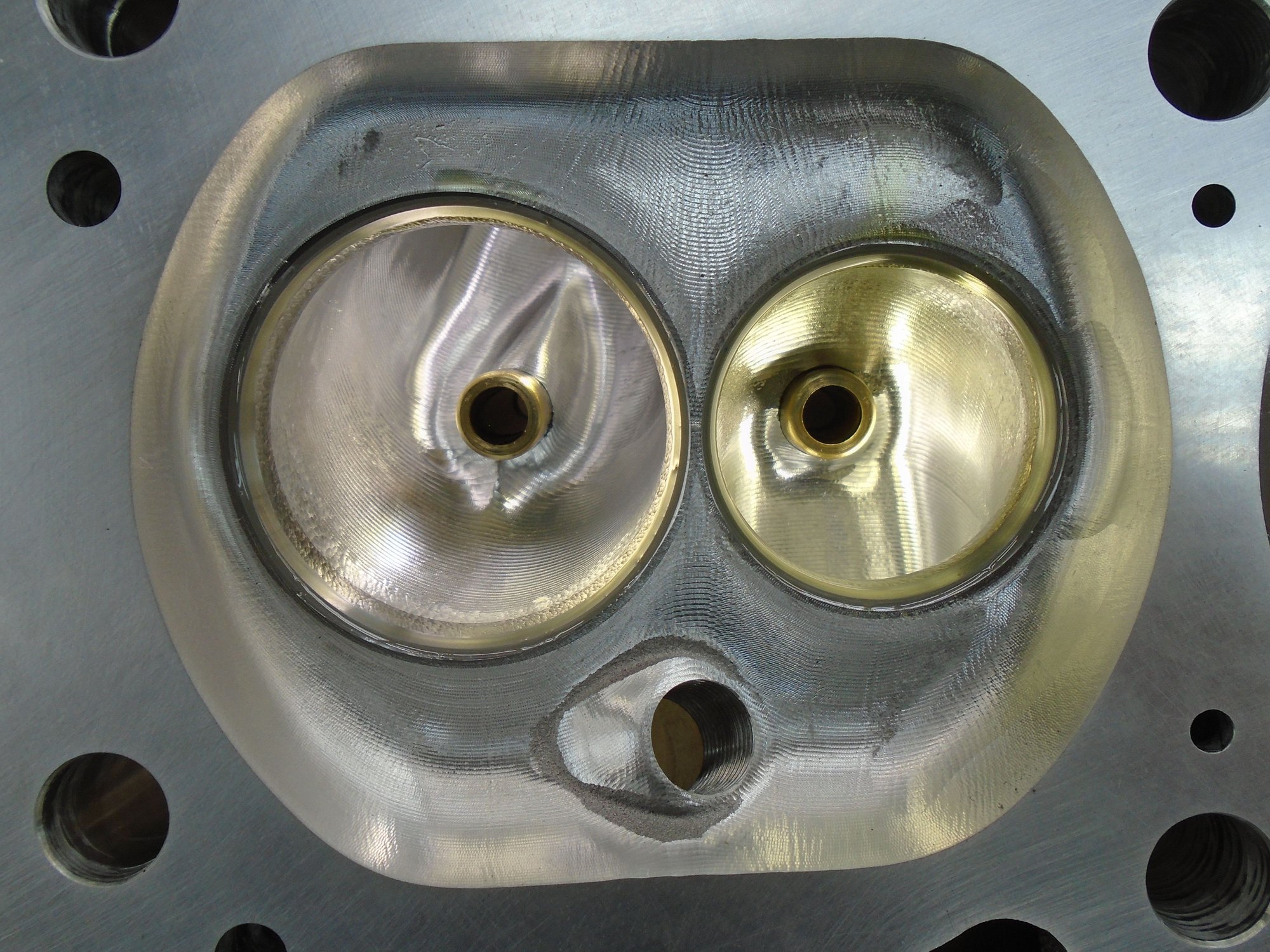

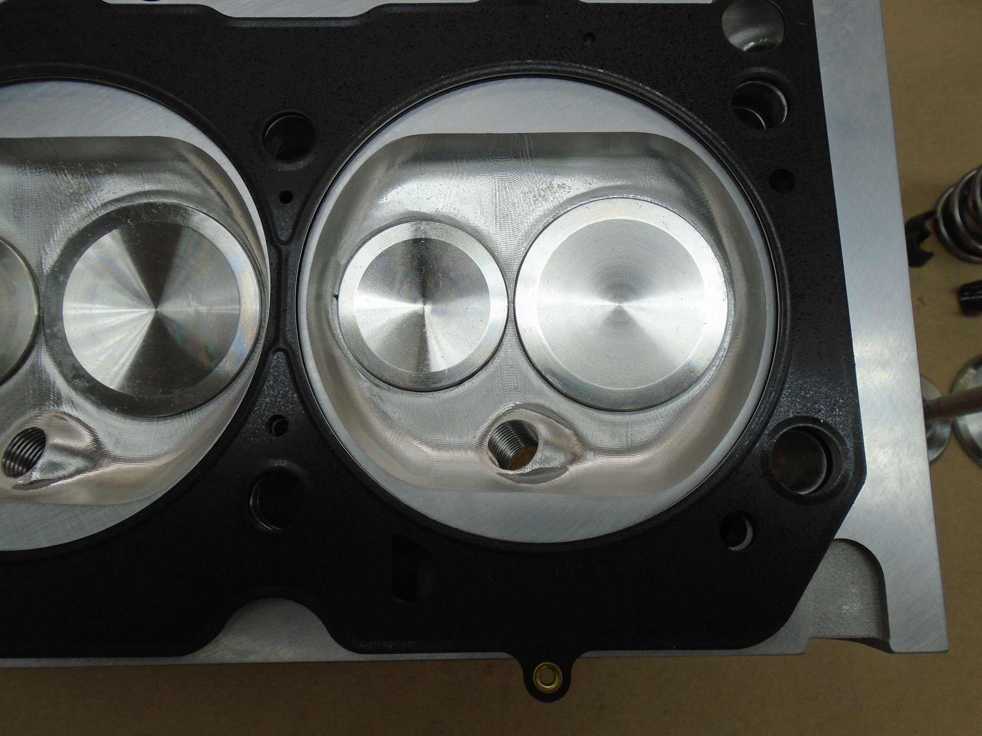

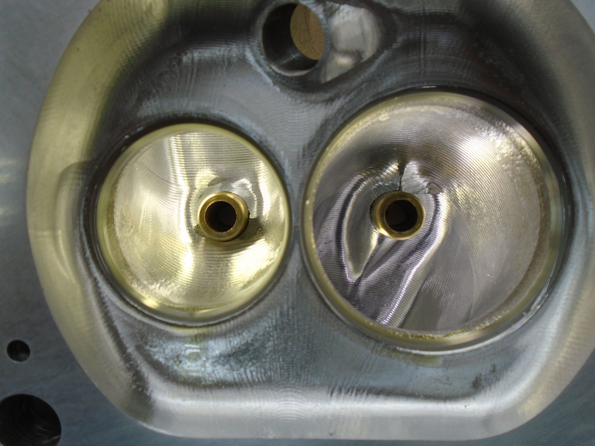

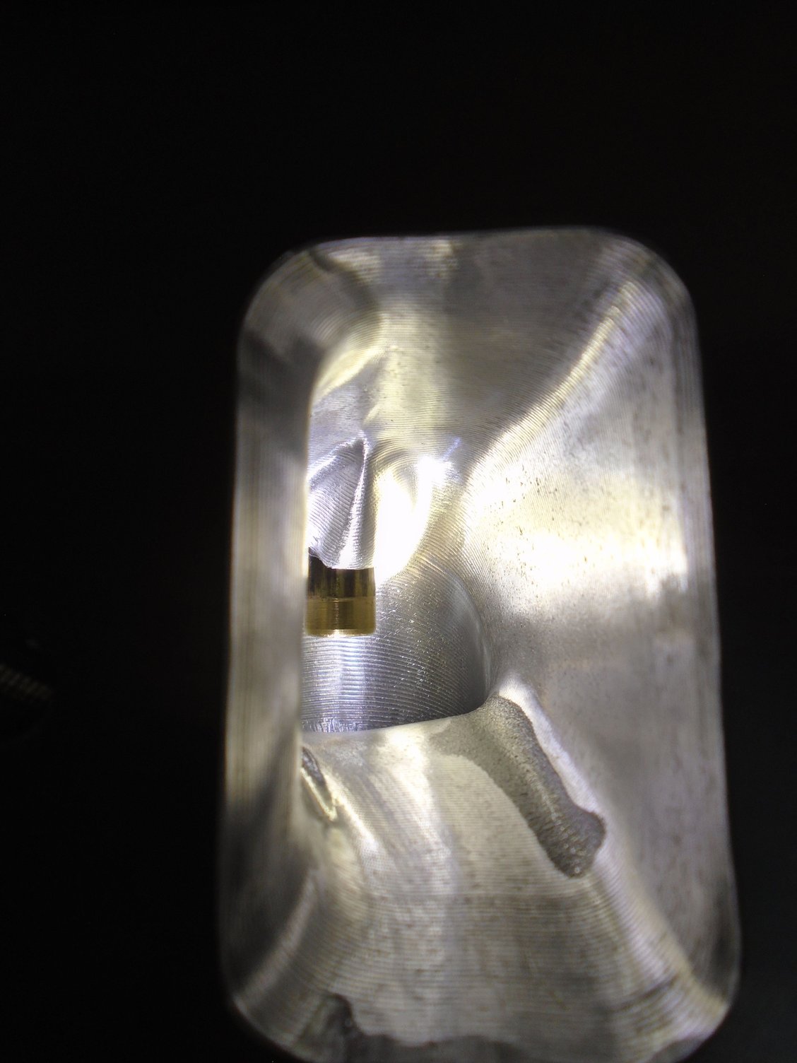

Talking Machining
The spacing between machining passes shows its wider pass than Mark's heads.
That's what I meant when I said it was a matter of programming, as you can change the amount, direction, and depth of the passes when plotting what the chamber is going to machine like. Of course the cutter being used is a factor, but you program around that based upon its actual cut patterns. Touch down with the cutter, rough in, then make a series of finer passes even in multiple directions to achieve a finer end result.
I know I could make those Competiton Components heads "happier" with an afternoon spent with the air motors, but having to take the heads completely apart and put them back together asks the question of why not nail in the first place in the CNC machining process? Yes, it may end up taking up to twice as long per head, and I get it, trying to keep costs down as time is money... A heavier coolant flow, faster feed rates, different cutters. I have put my hand and nose prints all over the booth glass at Grant Racing watching a Brodix monster BBC Chevy going through the motions - very cool to watch right there in front of you. Reed Grant has an awesome programming that initially rough cuts quickly, chips flying out of the ports with everything dancing around rather quickly, then the same cutter comes back and finely finishes the ports - you can hear the major difference when it finishes with the rough cut than doubles back for the finer cut. The RPM's increase dramatically for the finish passes, leaving an almost polished surface. I should have shot some video. I have tried to coax him into some Olds head work, but he is soooooo heavily buried that he can't keep up as it is. Fun to walk around his shop watching how much automation he uses in so many various processes. He says that's how he can be in three to four places at the same time

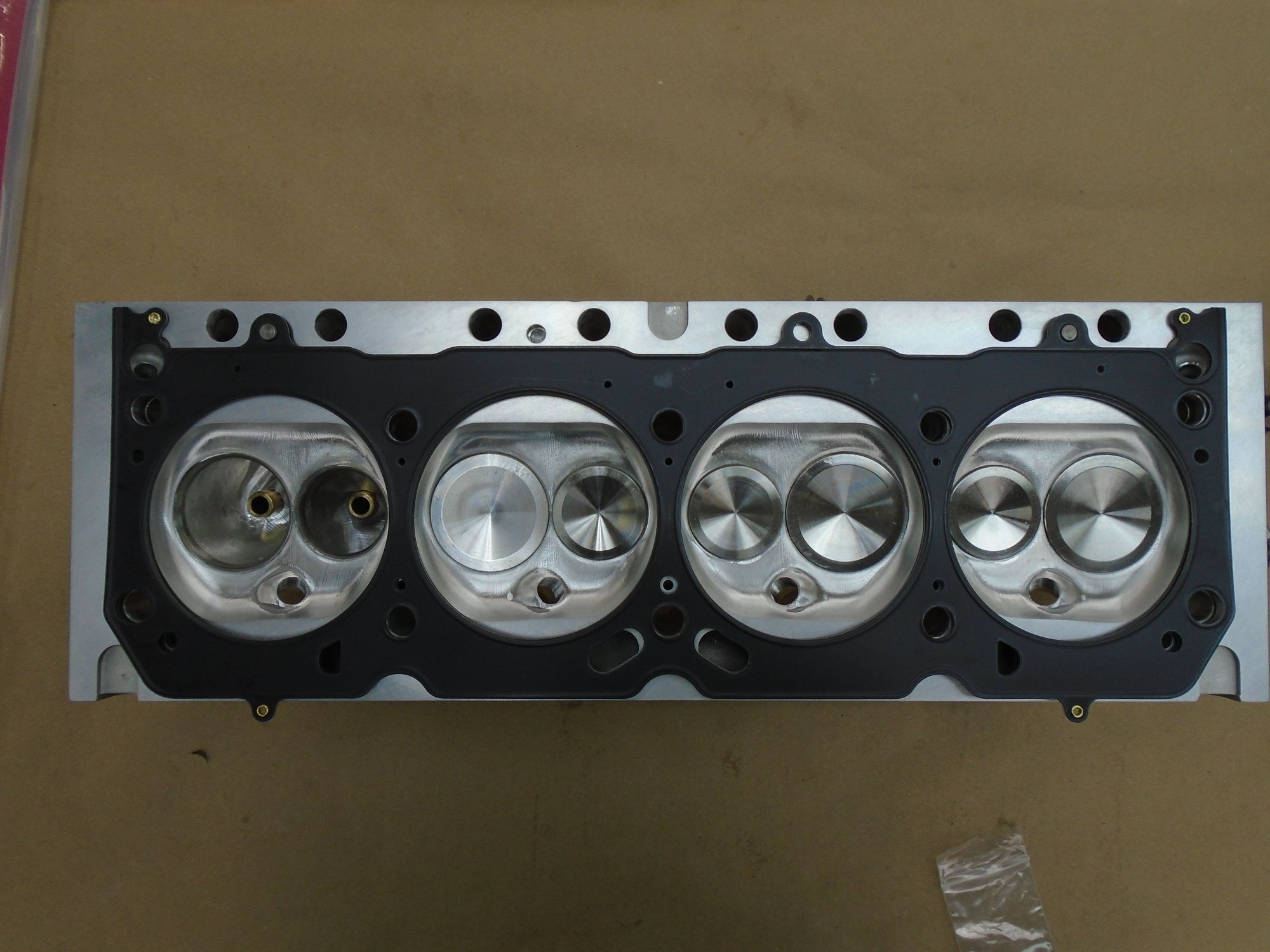

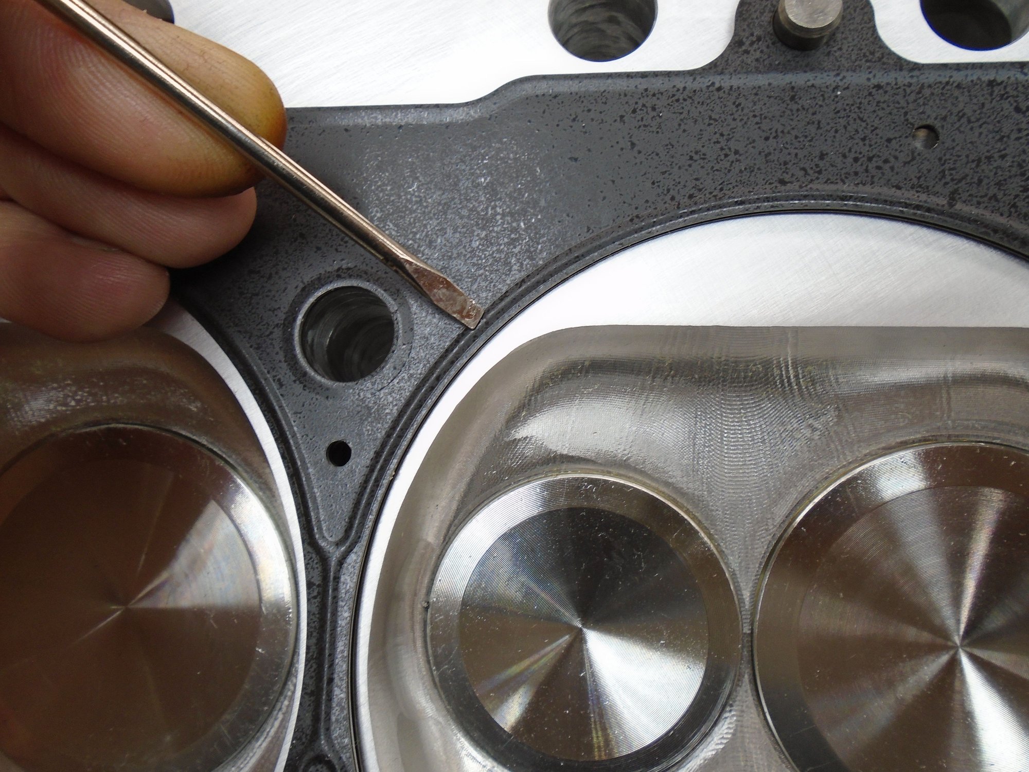

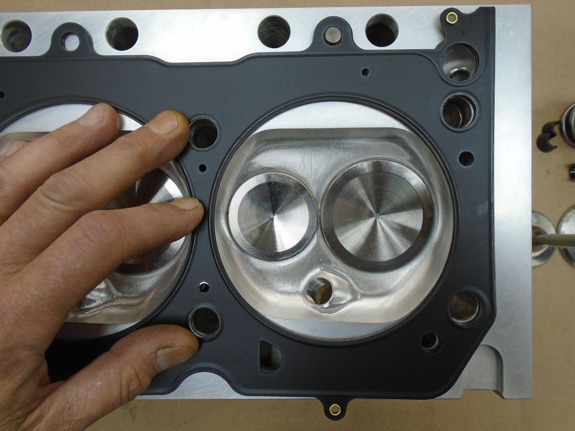

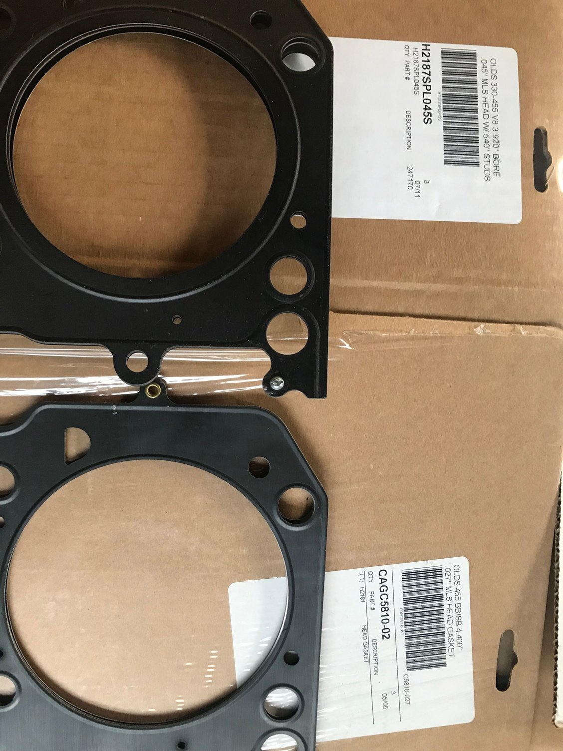

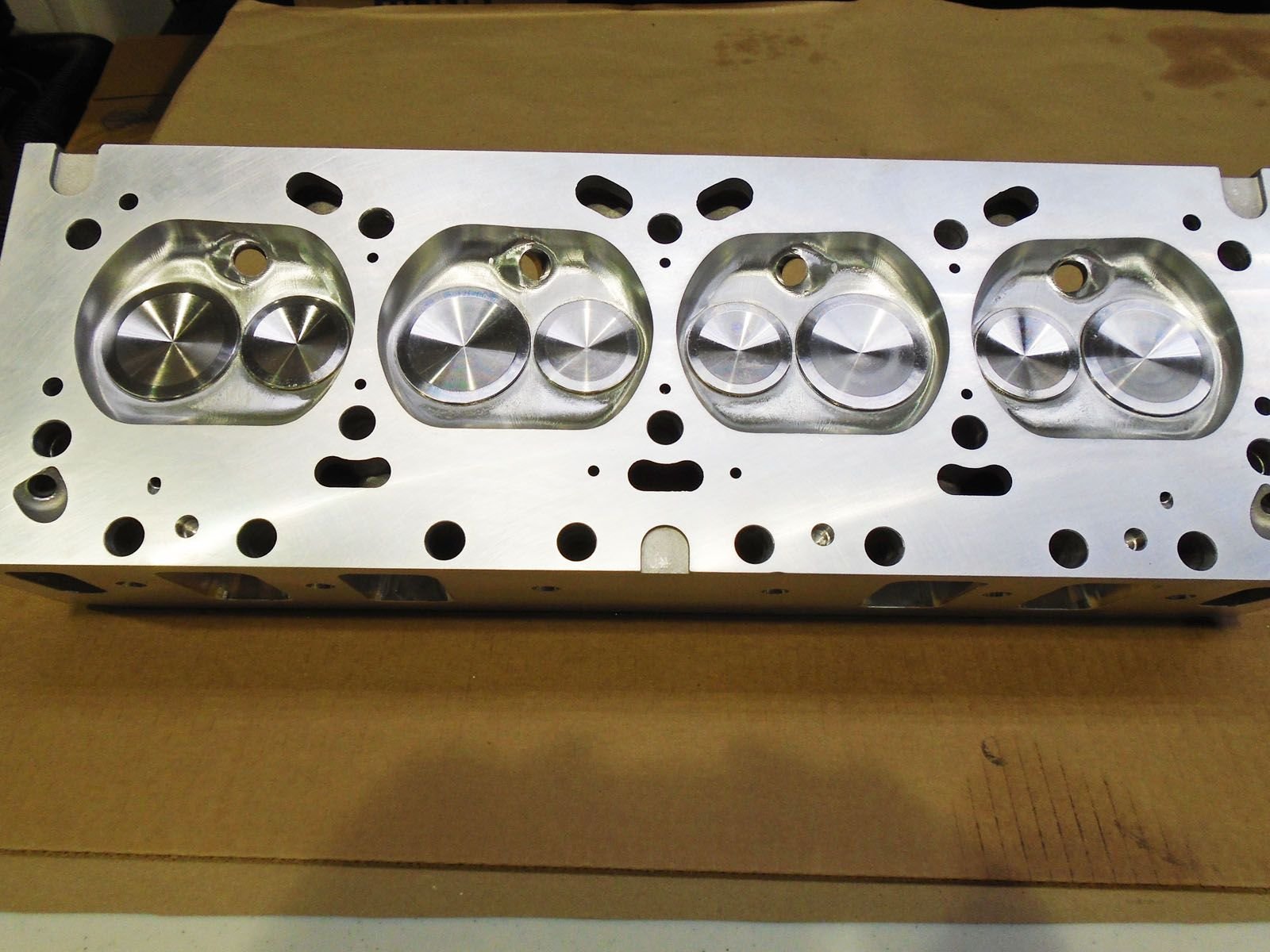

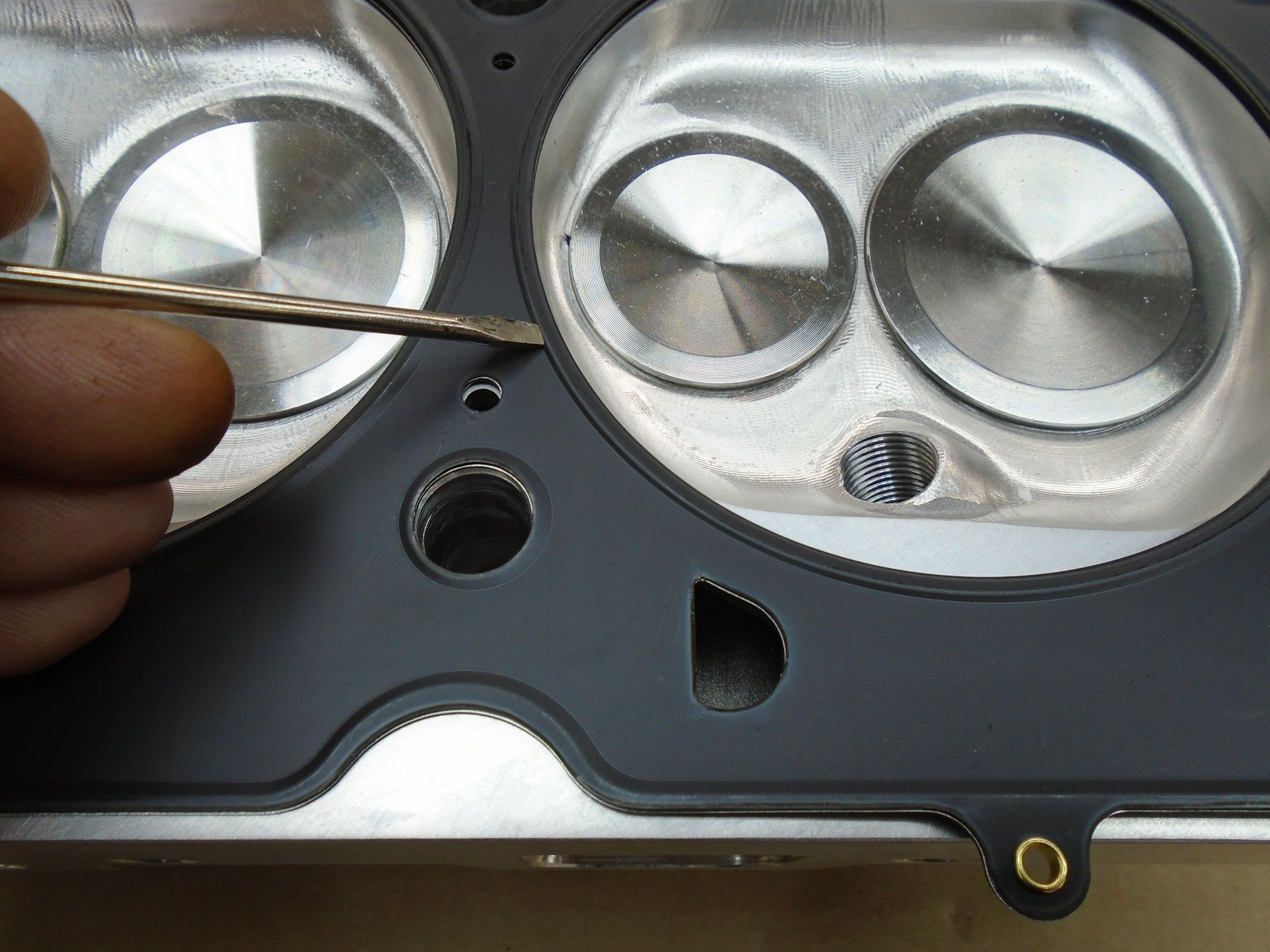

By way of comparison, here are the chambers of the work Mark (cutlassefi) did for me:
VERY IMPORTANT: Please note that I requested that the chambers be opened up to help unshroud the valves. These ended up at 85cc for use on a 4.350" bore size. My target compression ratio was 9:1 when these heads were done, as I am supercharging the 535. If I instead choose to use these heads on the 488, I will have to have them milled further to bring the chamber volumes back down smaller to better facilitate the 488 (that run the Mahle 22cc dish pistons in the Eagle stroker package). Good thing these Speedmasters have a reasonably thick deck - not sure how much they're going to have to be milled to get the chambers back down to 75cc to get back up into a 10:1 area - don't feel like switching pistons in the 488 as they are perfect, already fully broken into their respective bores.
Uh oh, I just realized that I may have painted myself into a corner though. While I had the heads out for photography, it occurred to me to grab a 455 head gasket and compare it against the chambers. Requesting to have the combustion chambers opened up means they are a bit wider now, so it looks like I would have to obtain some head gaskets that can provide a 4.250" to 4.275" combustion chamber fire ring, as the standard 455 Cometic 4.200" gaskets I have on hand now checked against the heads have a small amount of the fire ring overhanging into the chambers = won't seal properly. I will have to study this further, as running a 4.250" - 4.275" ID fire ring on a 4.155" bore may not yield optimum results. It will seal to the block properly, but the chambers being just a twinch wider than the bore on each side (left and right or fore and aft depending upon how you want to look at it) may present a problem. Running a standard 455 4.200" ID Cometic on a 4.155" bore yields a .075" area divided by two = an area of .0375" between the cylinder and the head. Running a custom 4.275" ID head gasket changes that to .120" difference divided by two = and area of .060" circumferentially between the head and the block, with the chambers possibly being .020" +/- wider on each side in relation to the bore. Oh how I drive myself nuts with this stuff!
Or? Hmmm... maybe I run these initially on the 535, not getting hung up on the 30 CFM exhaust difference for now. Looks like I have got some further thinking to do. I'd rather overbuild the 535 now with some really good flowing exhaust ports and detune for use in the G body (knowing the exhaust port flow will accommodate enough flow for any possible future uptuning) (possibly in a different chassis). At the current 180 CFM at .600" lift, I have a wall / limit requiring a future cylinder head change to uptune the engine. Things that make you go hmmmm....
I'm not on Fakebook either. Being the apparent dinosaur that I am, I want nothing to do with social media.
Laughing at myself now - you may as well go ahead and pile it on!
Paul

If you want to get them down to 75cc then you’ll need to take about .055-.060 off.
But you’ll need to measure along the way because the side walls of the chambers don’t go straight up and down, they’re flared a bit just like they are at the squish pads. In order to make them straight, that would’ve required a third CNC revision.
Just an fyi.

"Of course the cutter being used is a factor, but you program around that based upon its actual cut patterns. Touch down with the cutter, rough in, then make a series of finer passes even in multiple directions to achieve a finer end result."
You DON'T "touch down with the cutter, rough in, then make a series of finer passes. You set a "Z" as your reference point on the head gasket surface. This is called "Z zero" and establishes the depths for all combustion chambers......otherwise you could have different CC's in each of the combustion chambers.
"Rough machining followed by a lighter "Finish cut" is basic "Machining 101" taught to machinists for 70 years or more. You just "discovered" a basic machining principle.
"I know I could make those Competiton Components heads "happier" with an afternoon spent with the air motors,"
It would be a "very long afternoon" because you have EIGHT combustion chambers to do. But hey, you can clean the heads one more time before you reassemble them.
In the end, I would not buy the first set of heads you showed pictures of, based simply on the workmanship (tool chatter marks, ridges). The idea behind CNC machining was to make identical combustion chambers and ports.
.....Just my two cents work.

Mark, yes - thank you for your input, was thinking .065" - .075" cut on the head decks, which may also bring the combustion chamber perimeters back into the 4.200" Cometic head gasket ID, then working well on the 488. Curious - what about a "round two" on my Speedmasters? Do you feel you could put a larger exhaust valve in and open the exhaust ports up any to gain some further CFM ? Can the existing seats handle being opened up to accommodate a larger exhaust valve? Set the CNC program on the exhaust ports to remove 15% more material in key areas of the exhaust ports, essentially hogging them open larger where needed? For what I have into them, maybe I just need to have you go at them one more time to squeeze 30 more CFM out of them? Your thoughts please. The intakes are fine, the chambers are great, just need more exhaust flow.

Post Unshrouding the valves
I can see at least 5 to 10 cfm just by looking at the valve face
Right. That, and widening the chambers to unshroud the valves further, along with running in a larger 4.350" cylinder bore also helps flow immensely as compared to a stock shaped / sized chamber and the constraints of the small bore 4.155 +/- usual big block with cylinder walls right close to the valves that impeded port flow. Just taking the same head off a standard big block 4.155" bore and putting on a 403 with a 4.350" bore increases port flow considerably because the cylinder walls are further away from the valves / combustion chambers.
I will grab the camera later tonight and take some pics of the Cometic 4.200 bore head gasket against the cylinder heads to illustrate and may even have time to spank the valves out of one cylinder to provide views of the ports.
Heck, maybe the flow bench results were just skewed? There are a LOT of variations when running a flow bench - you can cheat to artificially swell the flow rates, or not have it set up just right and the readings come up short.

Valves are SI Stainless SEV Series
Valve Sizes are Intake 2.125 / Exhaust 1.68

the 5 to 10 cfm im talking about is from adding a good radius to the ex valve face at the margin. Nothing to do with pounding anything..yours don’t have that. It’ll add some cfm from lifts just off the seat to mid range ,then diminishes.
are the ex stems undercut?

Post Pics and pics and more pics
I am not the world's greatest photographer, so here is an overabundance from a whole bunch of different angles and lighting, each seemingly highlighting at least something different than the prior so as to get the "full picture"

Post And now the head gaskets
I think you’re confused on where the fire ring is on the cometics. Aren’t they all 4.400”?
the bore diameter is whatever you ordered but the fire ring is the same on all Cometics
And more, illustrating the head gaskets, dowel pinned into place for accuracy:
4.200" MLS
4.200" ID MLS head gasket overhanging into the right and left side of the enlarged combustion chambers
4.200" MLS
4.200" ID MLS head gasket for 4.125" bore Screwdriver indicating the fire ring / combustion chamber seal
Above are the 455 head gaskets - below are the 403 head gaskets
4.400" ID MLS head gasket for 4.350" Bore Screwdriver indicating the fire ring / combustion chamber seal
4.400" ID MLS
4.400" ID MLS
So see the fire rings? aka combustion chamber seals? They are indeed sized accordingly - they are not all 4.400" unless you've been using the wrong part numbers for the 455's with the smaller bores (!?) The 4.400" are for the 403's, and the 4.200" are for the 455's
Study away and give me your thoughts. I'm thinking hog the exhaust bowl open for a larger exhaust valve, mow some more material out of some key places in the exhaust ports = should be able to get some more CFM out of these exhaust ports. I am not sure how much more the exhaust seats can be opened up before they could become a possible liability. Under boost, there are going to be some pretty high exhaust temps (EGT) - HOT / FIRE !!!
I welcome all thoughts and suggestions! What would you do to feed a twin supercharged 535 Olds build?
(yes, of course the exotic PDD billet super heads would unleash the full potential, but again, costs aside, would require different exhaust and induction which I prefer to stay away from as per the very low hood lines of a G body where my goal is to hide all of this under the stock hood)
Paul...

Post Undercut valves
YES - The valves are undercut

who’s gasket is that and the part #’s ?

Gasket Brands and P/N's
The 4.200" bore MLS head gasket shown is the Cometic MLS Head Gaskets C5809-027
The 4.400" bore MLS gasket shown is the Mr. Gasket MLS Head Gasket 3247G
Note: HOLLEY IS STILL GIVING AWAY THESE MR GASKET 403 MLS HEAD GASKETS AT A STUNNING $18.90 EACH AS OF THIS WRITING. I bought 10 of these just stocking up due to the price point. 10 at $18.95 = $189.95 - STILL cheaper than just buying 2 Cometics (!)
STEAL OF THE CENTURY
These head gaskets BELOW are the ones I intend to run on the 535 to handle any and all boost I may throw at it without worry - not much more than the Cometics at $139.92 apiece:
SCE Titan
SCE ICS Titan S793843 Olds 4.380 ID - NOT the proper size for a 455.
NOTE: These have a very solid built in combustion chamber stainless o-ring and will Brinell the engine block and cylinder heads. This means it will leave a pronounced circular indention into the softer aluminum of the cylinder head and also somewhat into the deck surface of the engine block. Great for sealing very high cylinder pressure, and "happy" when replaced with the same exact gasket, but these are permanent indentions that would take milling of the head and block decks to remove. For the sake of clarity, once you go to these and they leave their pronounced witness marks into the heads and block, you should not risk switching to a different head gasket design without milling the heads and block to ensure a proper seal with a different design head gasket. You don't run these and then just swap them out for any other head gasket. Once you go to these, you stay with these, which is not a bad thing, but some need to know that there is no turning back without milling the heads and block.

I have about 10 sets of Cometics here..all have the same 4.400” fire ring. All different bore sizes
here’s a pic of the smallest bore, 3.920” for a late 400 and the biggest , 4.400” for a 403

The date on yours seem to indicate a production of 07/11 - old designs?
3.920" bore isn't correct for the 455 with the 4.125" stock bore size either...
The H2187SPL045S number doesn't come up on the Cometic website or an internet search. The "SPL" suffix may be an indicator of "special" one offs, or these are in indeed an older discontinued design. I did have to rub my eyes there for a minute when I first saw them, as they struck me as rather odd. The silver rivets holding the sections together are also something I haven't seen before in a Cometic, as compared to the one you have lower down for the 4.400" bore that I am used to seeing.
I get a kick out of seeing "Olds 455 BB/SB 4.400" as that can cause some serious customer confusion. Your 4.400" bore versions show a date of 05/05 - not sure what gives.
Definitely "trippy like a Mississippi hippie"

i never said the 3.920” was for a 455, I said it’s for the late 400, which is why it’s 3.920”. It is special order.
the silver rivets aren’t rivets..they are machine screw and nuts so I can can take them apart for easy cleaning when reusing them or to change the middle shim to a different thickness
you don’t think you’ll need O rings? How much boost?
You know, as your eyes get older... I thought those may have looked like screw heads, but couldn't tell for certain in the pics.. Are you Loctiting the little screws and nuts to make sure the ones inside of the engine valley won't come apart? Or removing them counting on the dowel pins in the block decks to maintain proper placement? I'd sure hate to have those little screws come apart inside of the engine.
Aha, so these ARE indeed a special order, which explains the fire rings being so far away from the actual cylinder. That had me really scratching my head. Well, actually still has me scratching my head as to having the fire rings so far away from the cylinder...
The way you were speaking about them ALL having the fire rings at 4.400" is what ran me off in the notion that you may have also been speaking of 455 head gaskets. At least that's what I got out of reading your statement...
I am not sure how much boost the Twin TorqStorm package is going to tolerate with methanol injection and E85 air charge cooling (non intercooled). My off the cuff target is 15 PSI, but I don't want to risk tossing a head gasket if it ends up being able to take more. During the first 100 miles, I won't even have the supercharger belt on. After that, I'll put the belt on, setting the BOV's (blow off valves aka waste gates) at 3-5 PSI until about the 500 mile mark. Once the 500 mile mark has been achieved, I should have the majority of the tuning ball parked in. That's when I intend to slowly start creeping up on the boost a couple of PSI at a time adjusting the tune as I go towards the 1000 mile mark. Once at that point, it will be a graduation of 2-3 PSI at a time until I hit the point where the engine starts complaining OR the chassis is complaining constantly up against the traction control. If it will take 20 - 22 pounds of boost on E85 (while fire hosing methanol down the throats of the superchargers) without rattling under boost setting off the knock sensors (doubt it), well then by golly I will certainly not want to be worried about tossing a head gasket (!) These SCE Titans are o-ringing the package without the absolute permanence of actually machining for o-rings.
Can the cometics be reused? or are they done after there compressed?
Depends upon who you ask... Dale seems to imply that he is re-using them. I know some split the rivets, clean them up, spray them down with Permatex copper spray-a-gasket or Hylomar, stuff them back in and have no problems. BUT, you couldn't pay me to do that as it becomes a choice of a "coupla hundred bux" versus possible head gasket problems = no thank you, I will replace the head gaskets instead of rolling the dice. If you are in a scenario where you are constantly yanking the heads, such as dyno testing or drag strip class specified tear downs, then it starts adding up quickly, definitely looking at re-using them. If you are in a build where you want to build it once, build it right, and not look over your shoulder concerned about popping a head gasket, then do not re-use. Absolutely no no to use on one engine then attempt use on a different engine in my opinion. If you are re-using on the same engine, the same basic crush points / patterns will be there as per the machining and how the decks on the heads and block have settled. Guys that re-use make sure that the block side stays to the block side, head side stays to the head side, and do not mix up passenger to driver's side during re-assembly. The middle is a thicker flat steel shim without embossments, so its not particularly subject to losing any of its properties if / when re-used.
