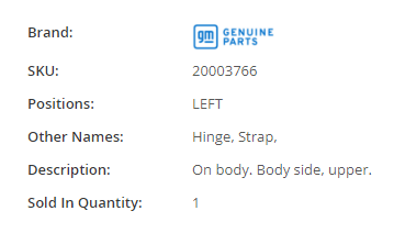

I guess the bigger question is...what's the p/n for the RH upper on your car??? GM p/n's 20095426 and 20095424 don't exist that I can find, so if you blow the upper right one you're in for a search.
Old Jun 30, 2024 | 11:24 AM
69HO43's Avatar
Posts: 2,539

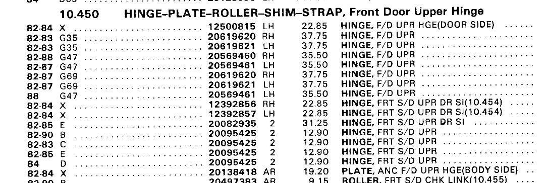

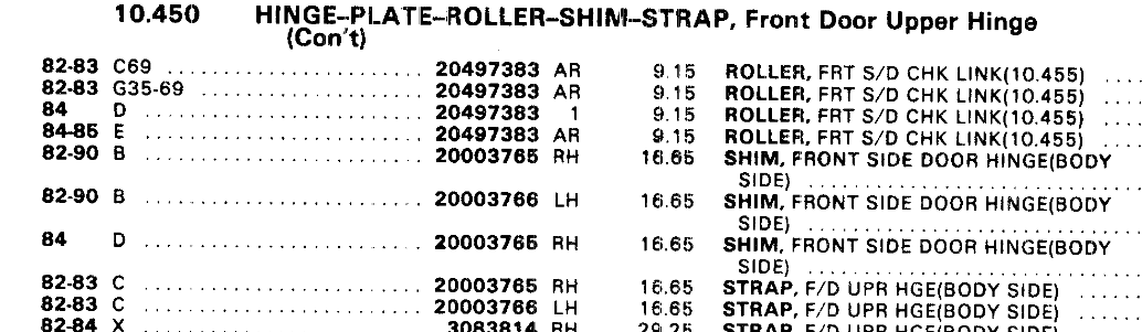

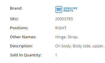

Figured it out. Yeah, TWO pieces per upper hinge. Door side uses that single part number for either side, 20095425
Driver door body side uses this one.
Called SHIM or STRAP in the book. What a PITA.
Passenger side body side uses this part.

The parts book is a missprint. Visual inspection, of the hinges confirms, the door side is not the same for both sides.
