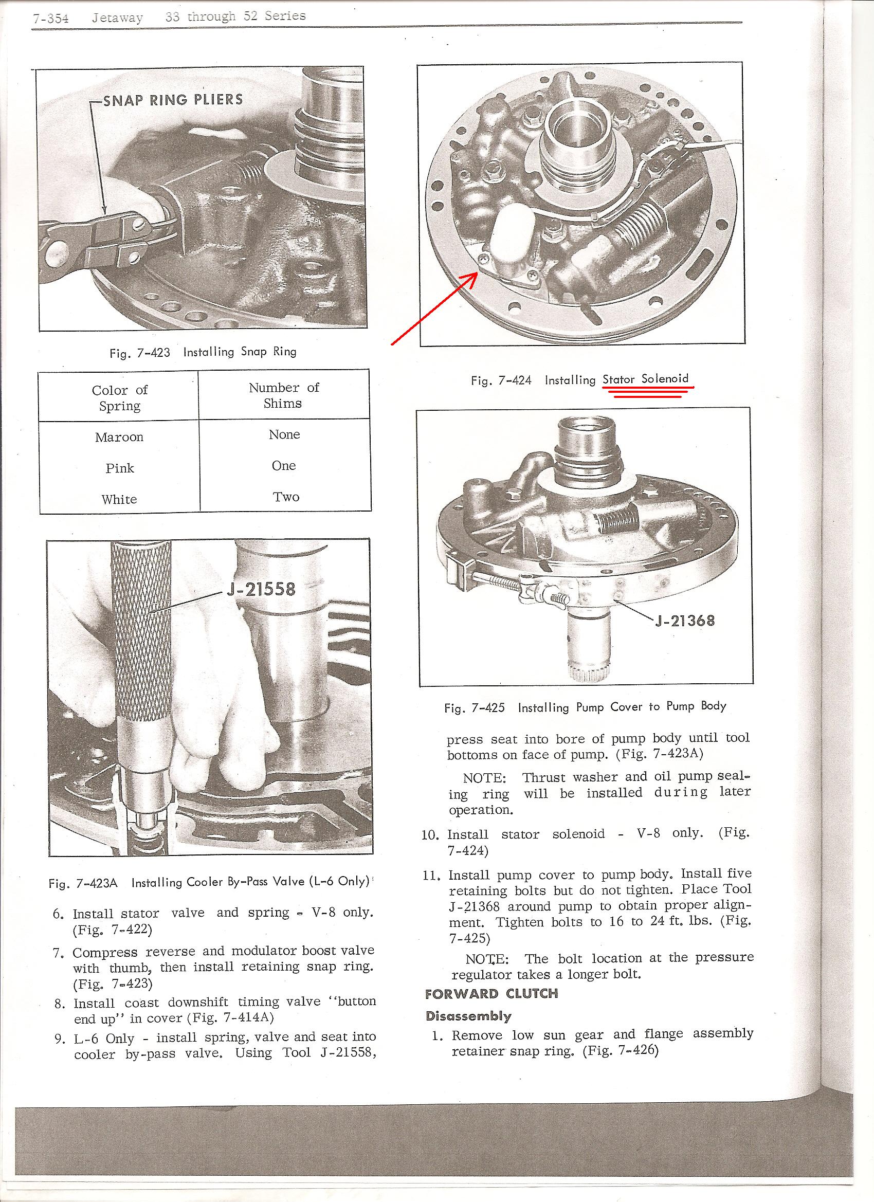

not find the parts for my TH400, I no longer know where to look, you can help me?

Well, not sure how much this helps, but I found a part number for a stator solenoid of a TH400 listed on a Buick forum: #1993690
Also it these guys sell a kit to convert a tranny to switch pitch. Seems like they would have access the part you need since I believe its included in their kits. Prolly will need to call em.

I asked but they say he did not have years.
just is not there, but all have the detent solenoid,stator solenoid no.
