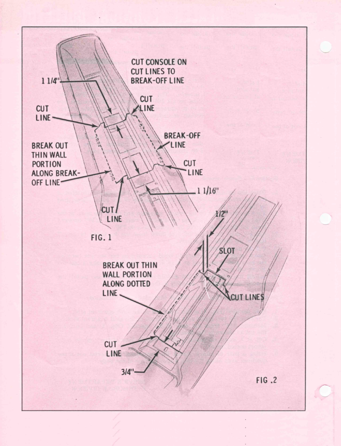

Be aware that you can open the top of a regular shifter version to fit the Dual Gate. There are cut lines molded into the bottom of the plastic. If you do this, cut with a slow moving tool to prevent the plastic from melting.
