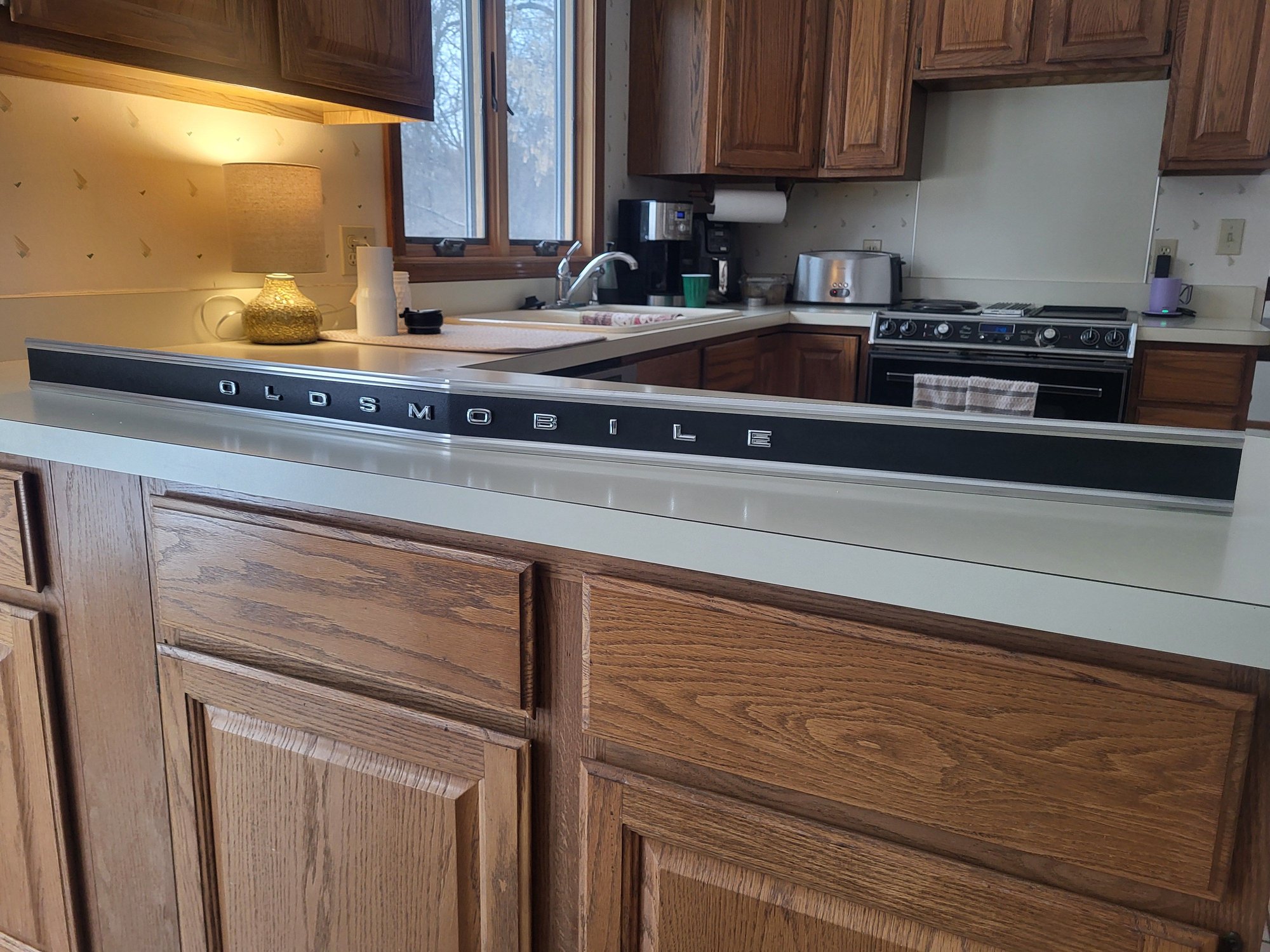

I have reproduced this trim piece from billet if you are interested let me know.

Can you post a picture of the back of the backside?
Old Today | 05:10 AM
tiogatwister's Avatar
Posts: 161
From: Hartland Michigan
Unfortunately I don't not have any pics of the back side, and the trim is already on the car. I assume you want to see the mounting studs? I drill and tap the trim and bevel the front side and epoxy the stud in from the front side then level the surface, epoxy primer and wrinkle finish to match the original finish. If you look close in this pic you can see the stud locations and the epoxy.
