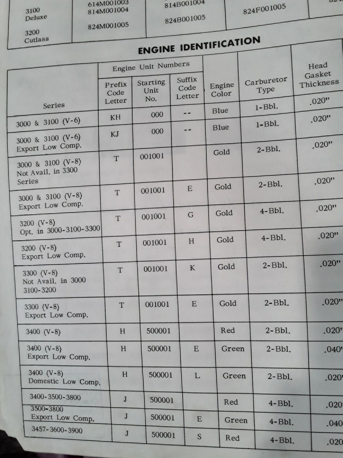

If the heads were in fact changed, look at the engine ID number above the center exhaust port on the DRIVER SIDE head. If the heads are original to the car, there will be a "J" prefix (4bbl engine) with a "S" suffix (Starfire engine) after the engine ID number. If the number is on the passenger head, heads have been off the car and reversed. If head has any other prefix and suffix combination, the heads or possibly the whole engine has been replaced.
I guess there's a remote possibility the heads were pulled and reconditioned, and a thick head gasket was installed to drop compression some to tolerate low octane fuel. But changing heads? That premise doesn't hold water.
