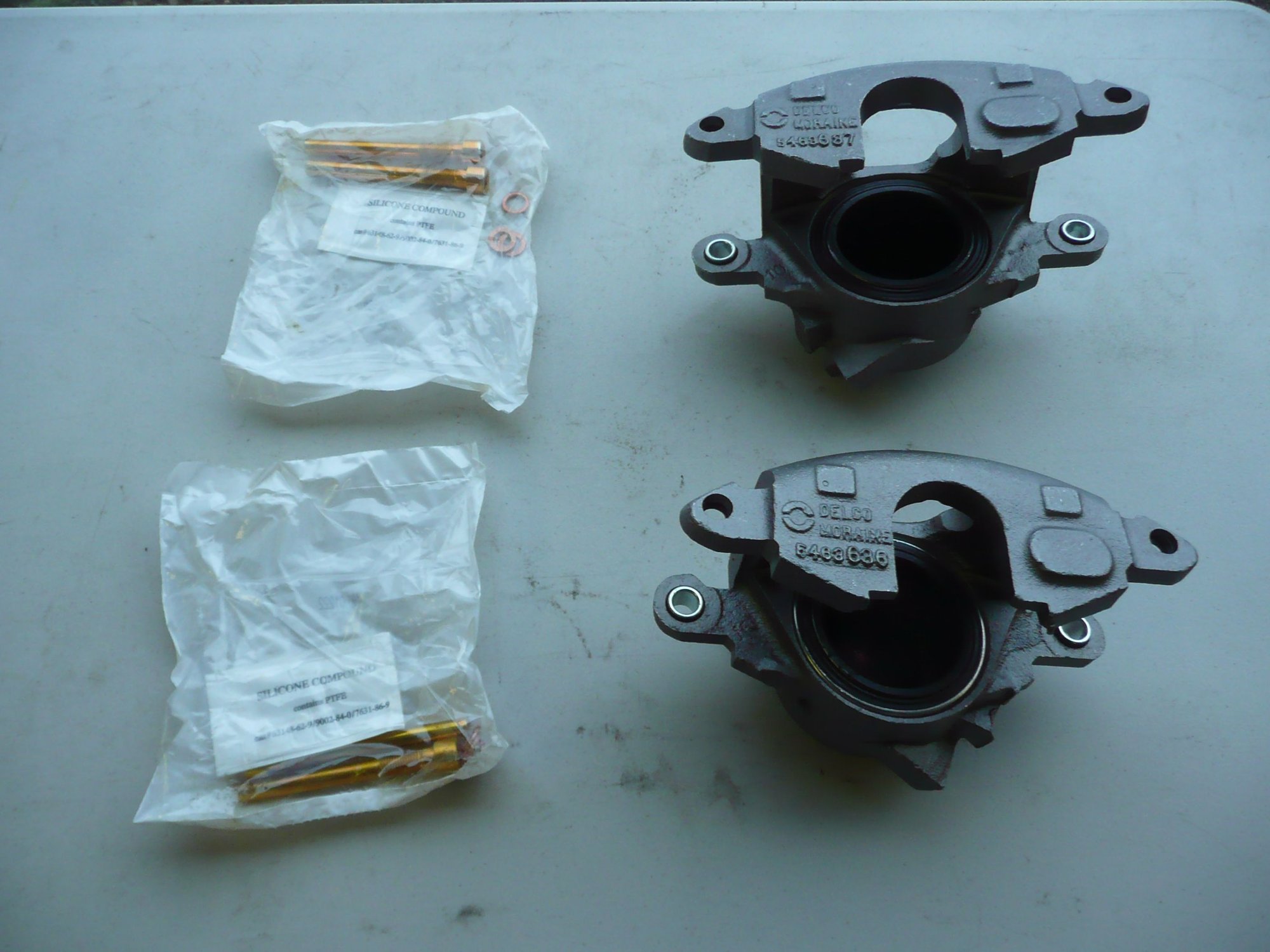

Old May 2, 2019 | 12:48 AM
RocketDevo's Avatar
Joined: May 2012
Posts: 486
From: New Westminster B.C.
I had all my cores rebuilt, have many original rebuilt sets ready to go.
If that works.
By the way, 636, 637 suffix part numbers are for the 1970 "A" body.
Thanks.
