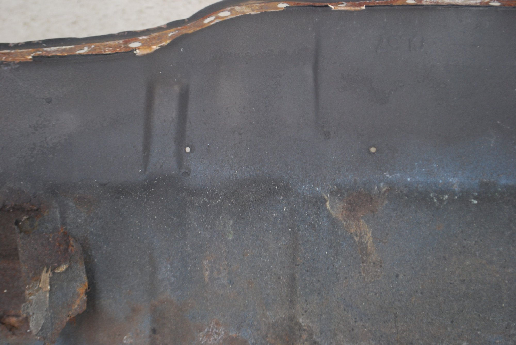

I have the original clips and trunk floor from Lansing built car that I can verify type and location for you if needed?

Hi scrappie - if you could post a few photos, like to to see if mine are in the right location. Thanks

Here is a shot, maybe this helps?

Yes it does thank you, helps me to confirm location.

Thanks scrappie … huge help!

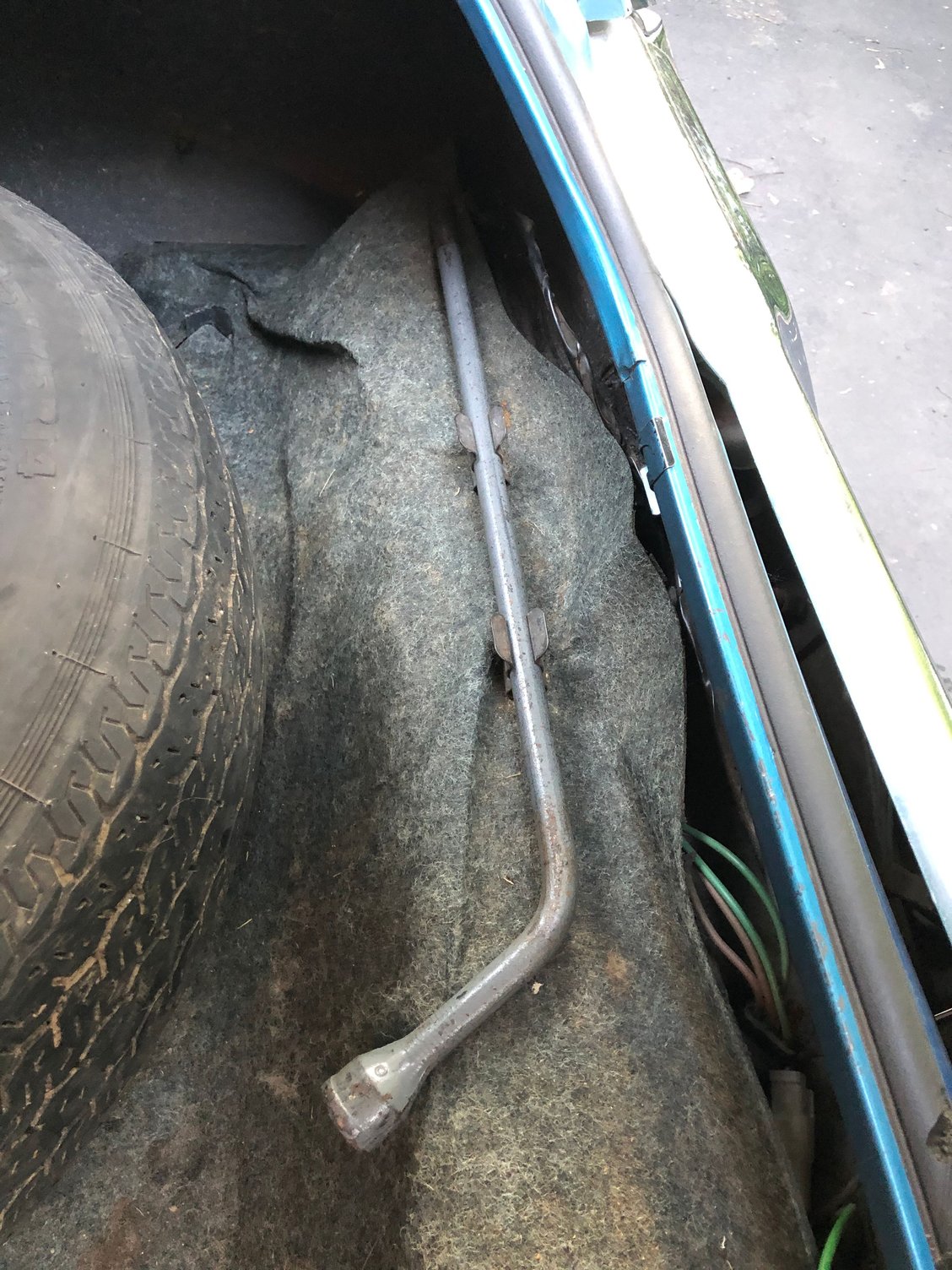

100% factory original setup. Can get you the hole locations/distance apart for the mounting screws if you need them.

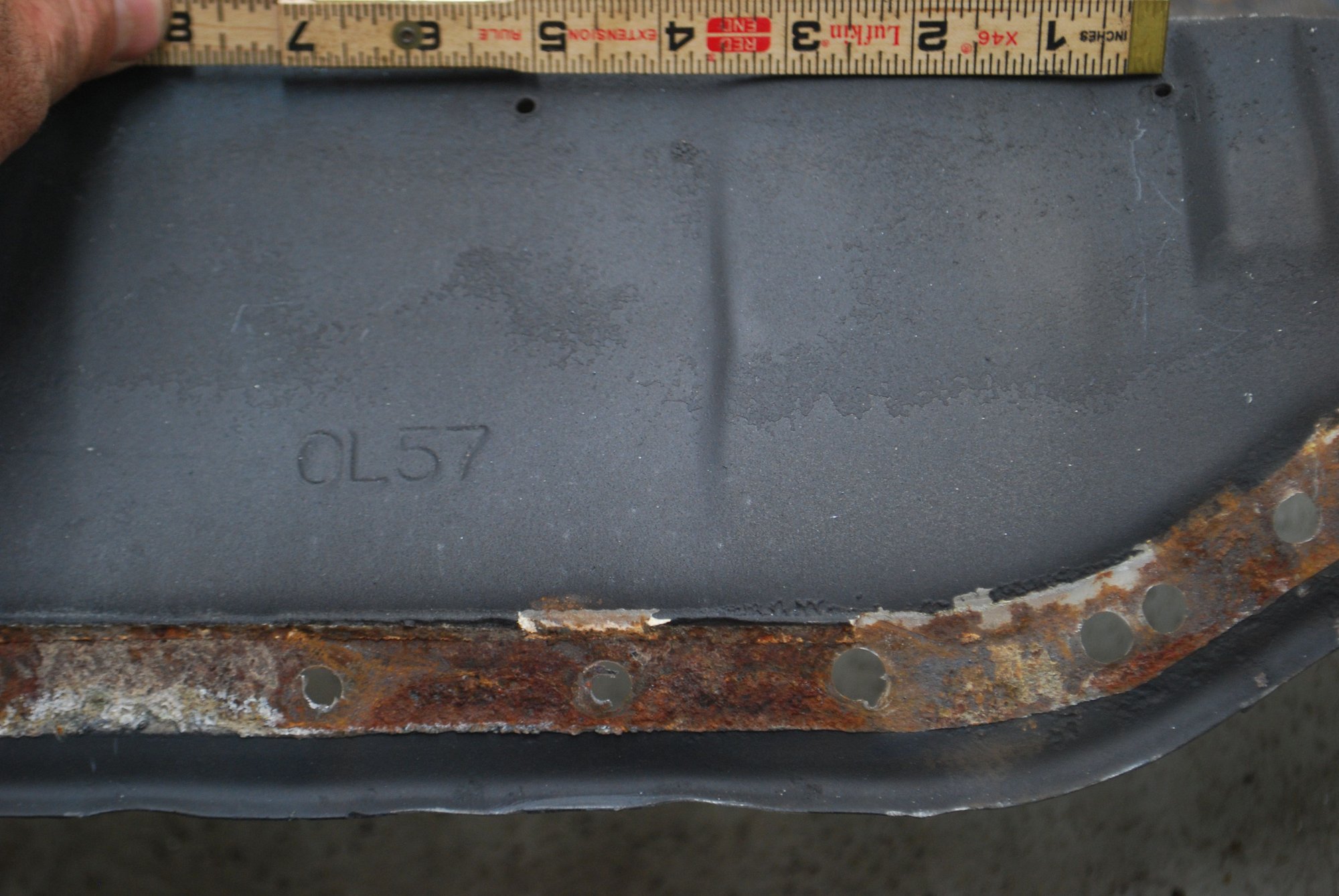

Just another shot of trunk after I replaced. Holes look to be 5" apart. No secondary holes for tabs. And pretty sure my original clips dont have tabs but I'll check next time I think about it.

Thanks so much for taking the time to provide this … big help!
