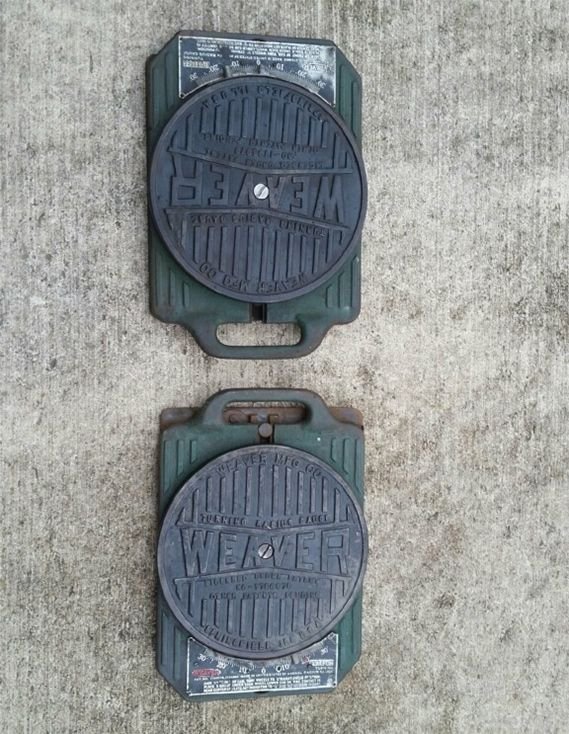

The basic problem with a DIY alignment set-up is you can't take the "runout" of your wheels. In other words, if one/both of your front wheel outer lips are slightly out of true with the center, where it attaches to the hub or the drum/rotor surface isn't true or has dirt between the wheel and mounting surface, you can't get an accurate reading. The set-up that I have, while being portable, also allows me to compensate for an out of true situation. When doing an alignment, you're actually aligning the spindles, not the wheels. The first thing that I do when checking alignment, after checking for worn ball joints and loose wheel bearings, is to attach my alignment heads and slowly rotate the wheel, while watching a bubble level. By adjusting three thumb screws that hold the head to the mounting fixture, I get the alignment head in a true vertical plane. Then any readings that I get are true to the spindle.
Old Apr 9, 2022 | 06:57 AM
I also do my own alignments. The biggest investment is a set of turn plates so you can turn the wheels to set camber. I was fortunate to find a used set relatively inexpensively at Carlisle. I know some people use layers of wax paper or greased masonite to facilitate turning the wheels, but that seems squirrrelly to me. I've tried several different types of toe gauges. These two aluminum plates with tape measures have been the easiest to use and most accurate. There are a variety of magnetic bubble gauges for caster and camber.
Old Apr 9, 2022 | 07:04 AM
The magnetic gauge I posted above mounts to the hub, not the wheel, but that requires you to remove the center cap which can be a PITA. Frankly, if your wheels are that far off, you'll probably feel it as vibration at speed. And if you really care, just check alignment with the wheels clocked a couple of different ways to check.

With very few shops willing to align older automobiles like ours this is great information. You can probably buy all the tools for about the same price as an alignment job.

Truth be told the turn plates are not cheap but worth searching for. It is refreshing to know that one can actually do their own front end alignment providing they have all the necessery tools and knowledge on how to go about it. I have seen Snap On, Hunter and Weaver turn plates average used price of $500.00 and not sure which brand as more longevity and accuracy than the others. The search for knowledge and tools will go on.
Old Apr 10, 2022 | 09:35 AM
  #32
There's nothing magic about the turn plates - just bearings and sliders that avoid preloading the suspension when you turn. Frankly the Chinesium ones are fine when you do one alignment a year or less. Also, mine are ancient and I got them at Carlisle for like $50. Keep your eyes peeled.

I should probably point out that my turn plates live in Loudoun County. Just sayin'
