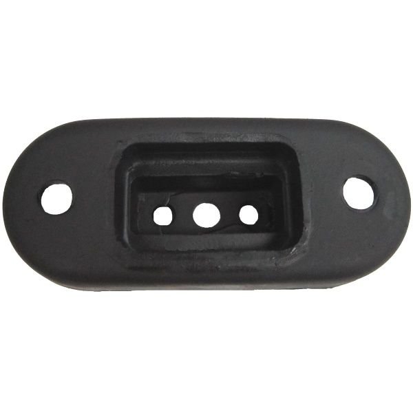

looking for an automatic transmission motor mount, fits 61-63

The mount is P/N 1361633, and it is the same on all 1961-63 F85 and Special/Skylark with any trans. No one sells new ones, only the revulcanization service, so either you need a good used one or search for an N.O.S. one on ebay. Eric Jensen might have a usable one.

thanks joe, already tried him. he thought someone modified their crossmember to make an early 70's mount to work .

If the newer mount is the same height, drilling holes in the crossmember is pretty easy.

joe, do you have any used mounts for dimensions????

I have one in the shop. Let me dig it out.

Is this the same as the GM one bolt type or the two bolt, like a Muncie four speed?

2 bolt

hey joe, if you could get me center to center bolt holes and height , i might be able to get something to work. thanks ( you should see what this pair of hands did to this car, i should have taken picture )

The two threaded holes for the bolts to the crossmember are 1.25" apart. The two holes that bolt to the trans tailhousing are 3.75" apart. The mount is 1.75" tall.

awesome, thanks joe!!! so i can use an anchor 2378 if i slot holes in crossmember and possibly mount also. it's 1.8" tall 1.5" at crossmember and not sure at trans 3.75-4". thanks for your help!!!!
