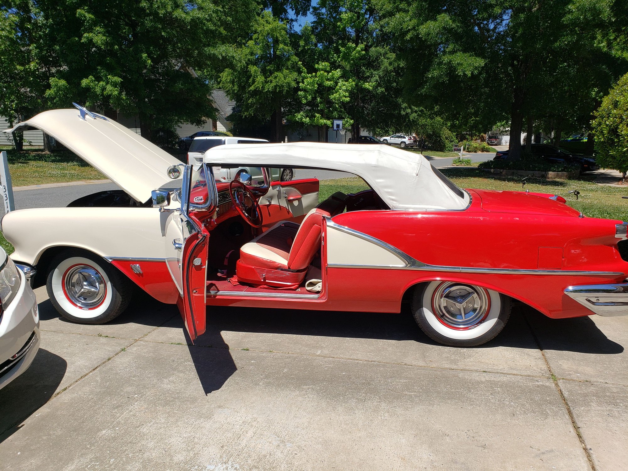

Looking for a 56 324 motor and jetaway tranny. Recently bought the car site unseen. Appears to have a 55 motor and transmission with miss matched heads. Im looking to restore her to a nice correct driver. Any help would be greatly appreciated

Nice, very nice. You have a bunch of guys on here from the "darksiders" that will chime in. They have an extraordinary amount of knowledge on these older Olds"

Thanks! I've wanted one since I was a child. Bought it for a family cruiser and to slowly bring back. Was a bummer about motor. But will fix or put the correct one in. Body has a few minor issues and needs new interior. Will eventually make a great driver. .

Nice looking car! I will be removing the 324 and Jetaway from my 56 to swap in a 394 and th400.

Welcome to the rare convertible group, looks like it has good bones. What are the numbers on the heads? I have a couple heads to a 55 I would sell but freight would be a killer. Should you find a block from a 55 be sure you use the 56 valley cover with the 56 heads they will not seat on a 55 valley cover with out a message with a hammer... Tedd

Welcome! Looks like you have a great start.

Welcome. That is a very nice looking car. Now we have guys on here with 54 thru 56 Super 88 convertibles. My 54 has a 55 engine and transmission in it but that is an upgrade from a 54. Tedd knows the most but I have picked up a little knowledge just by hanging out on this site. It is a good place to be. Lots of knowledge here.

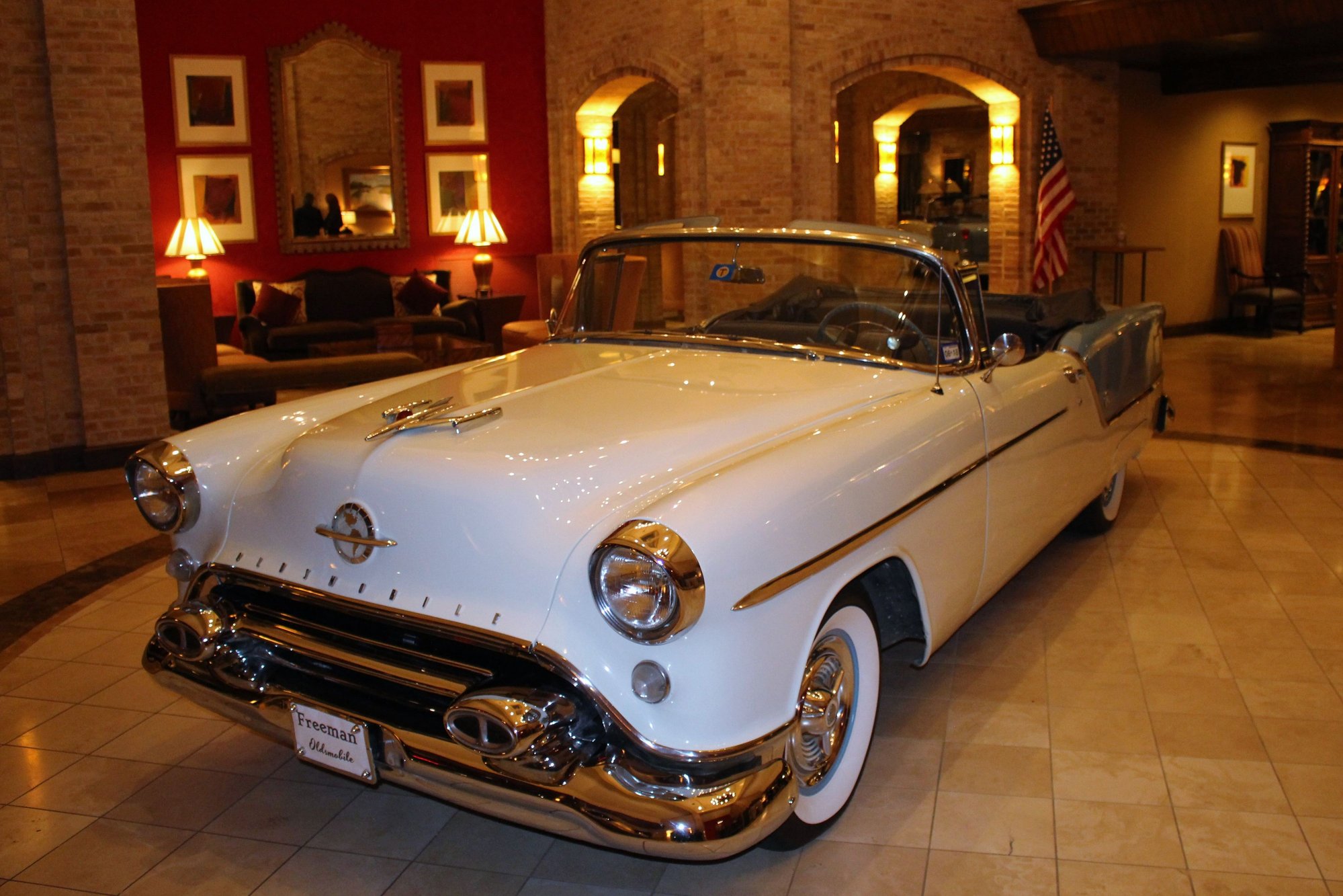

The 56 Super 88's and 98's came with the Jetaway (it had a Park position) while the regular 88 still had the hydra-matic which was a much better transmission. If you have a 55 transmission it would be a hydra-matic and I would keep it. Here are a couple pictures of my 54.

man thats a beautiful 54!

Red keeps his '54 in his living room.

🤣🤣 perfect place for it!

You guys are funny about my living room. Those pictures were actually taken in the lobby of the Bent Tree Country Club. I have shown them to people before and told them that is my living room. Nobody has ever taken me seriously and then of course I fess up and tell them the truth.

I would go with the living room story, keep'm guessing. No room up scales that gorges convertible.... ....Tedd

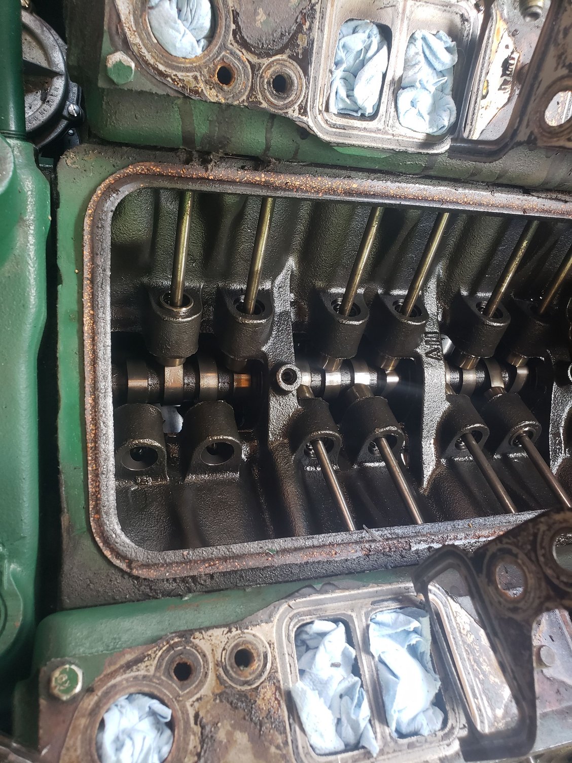

55 engine block?
Spoke to Tedd on phone. Any help in determining if this is a 55 block would be appreciated. From what I've read online it is. Also has the 55 distributor and appears to be 55 trans. V 831O49 I believe.
