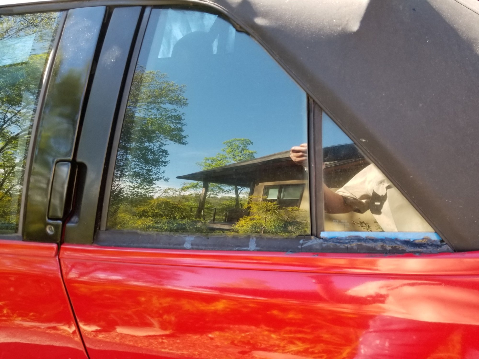

I recently picked up a 94 Supreme convertible for cheap to do a few repairs and sell. The weather stripping for both rear windows is pretty shot resulting with leaks when raining. Any suggestions as to where it can be located or an alternative? I haven't seen anything online.

Pics needed for location I have some or I can give you some one else to contact. Interior or exterior weather strips?

Both rear window outer weather stripping are dry rotted leaving gaps along the glass. I used some black sealant to try and fill the gaps, not sure how that will work out. Any idea how difficult it is to replace them?

door weather stripsI replaced mine on my 93 convertible. you have to take off the outside trim pieces from inside the trunk, 4 nuts and screw by the door jam
[ and the weather strips are pop rivited in, and, Weather strips to be drilled out, Check out ebay or maybe some else may have the alternative
weather strips off 2000-2004 Camaro . Try Don Ouvry has many convertibles for parts. 989-225-7443. He is in Wisconsin. tell him Hello for me.
