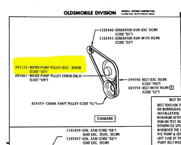

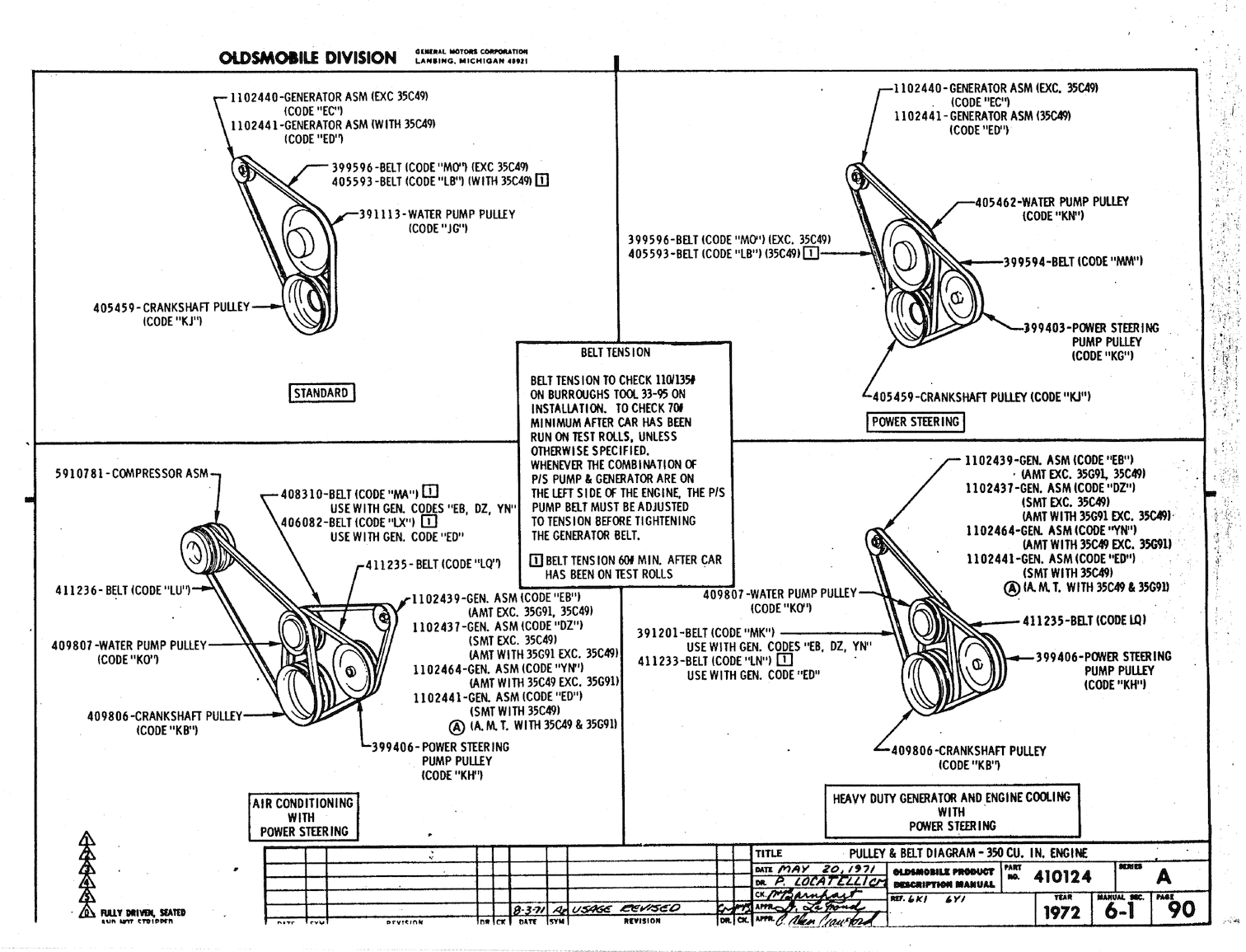

ok Im doing time travel w this post…is this diagram for 1972, bottom is cutoff, thanks if it can be verified 😎
Old Jan 3, 2026 | 02:45 PM
cdrod's Avatar
Rodney
Posts: 2,589
From: Houston, TX

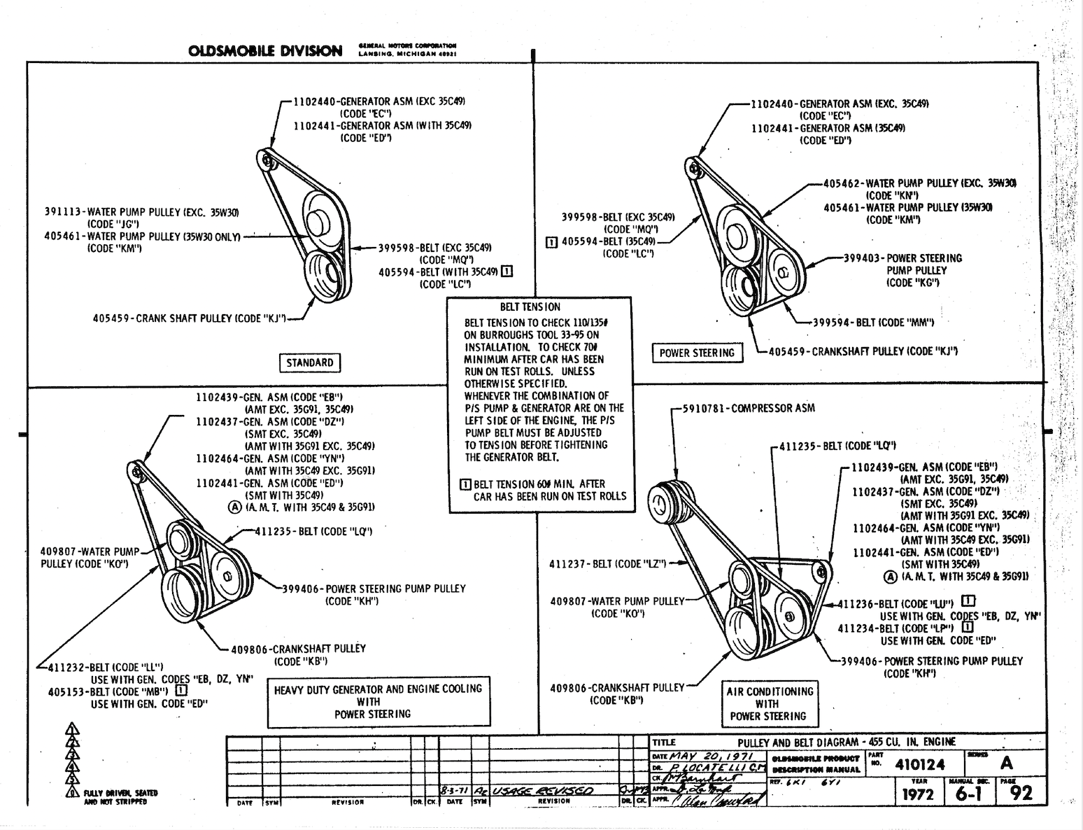

1972 Cutlass Pulley Diagrams
Here are the pages your looking for.
Rodney

Instead of a new thread,ill ask here, im looking for the single groove water pump pulley PN 391113
