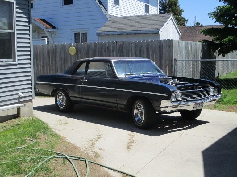

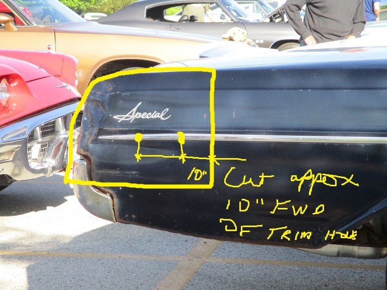

Hey Joe... I hafta agree with you 100% with one caveat; if the lengths and profile are the same (or close) Id be able to use them as "material stock". We used to say, "grind to fit and paint to match" LOL. General Motor interchangeability was a bit more forgiving back then. Think Model T Ford haha. Im new here, but if you ever read any of my project stuff from 65GS.com or V8Buick, youd see that I tend to make odd stuff work.
The Bujik stuff is a one year only part, and I am by no means doing a restoration. I could very easily change the whole trim system to Olds, and no one would be the wiser. Half of what I have is pretty nice, and some is a bit corroded from poor storage. Its all anodized bright, and once its polished then that becomes and ongoing issue.
Even Pat (my wife) says to keep grammas car in its patina. If you take a really nice A body, and a boneyard parts car from Zero to 100, this one is holding its own at about 60.
The panel placement is a non issue. Up or down an inch with a tad of a curve here and there and it looks pretty close.If the profile is close, even the spear ends would probably interchange. Thats pure conjecture, but whats to lose? If I could find a NOS 6 piece set (barring $$$) I'd change over tomorrow. Keep yer GM car all GM. I could go with a roll of self adhesive chinajunk, but that would take the element of artistic license outa the job. Theres something about the tin harmonics of one of the old guys going down the road sounding like a snare drum. Call me Gene Krupa haha.
Any input is always welcomed. Im always game to listen to ideas. Below are pics of mine and a stock pic from barnfinders. Also is the quarter panel patch job and trunk floor Im starting next week, and the young kid and his older sister. Thats my 72 XGS 455. This stuff will all be done in a few months WITH paint. Thats one advantage of being retired; stay BUSY! Thanks again, Bill

I'm no stranger to "making stuff work", but since the ends of the doors are curved, the length of the trim changes as you move it up and down the car. Also, are you SURE the cross section is the same? I'm not familiar with the Buick trim, but given the limited resolution of these photos, I don't know that they are. And obviously the Olds trim doesn't have the tapered ends of the Buick trim. Have you looked into having your old trim repaired? I recently sent the unobtanium wheel opening stainless for my 67 Delta to Dell Metal Polishing in PA. Not only are mine mashed, but a previous owner decided to drill holes for sheet metal screws rather than try to find the correct mounting clips. The quote for the fix was very reasonable.

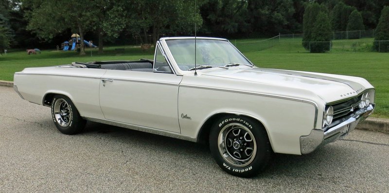

Well, as I suspected, the cross section of the Buick and Olds trim is completely different. The Buick trim is raised in the center, the Olds trim is depressed. Not even close.

Yeah... the profile/cross section is what really concerned me. Thanks for the close up on that Olds! That tells the story. Just as an FYI, the Buick stuff has an insertable "spear tip" at each end for a nice finish; you can hardly see it. I am thinking that when GM made this kinda stuff it came off a 20 foot long stick and was cut to fit, production wise. I do have a station wagon rear stick with a 20" long spear on the end.

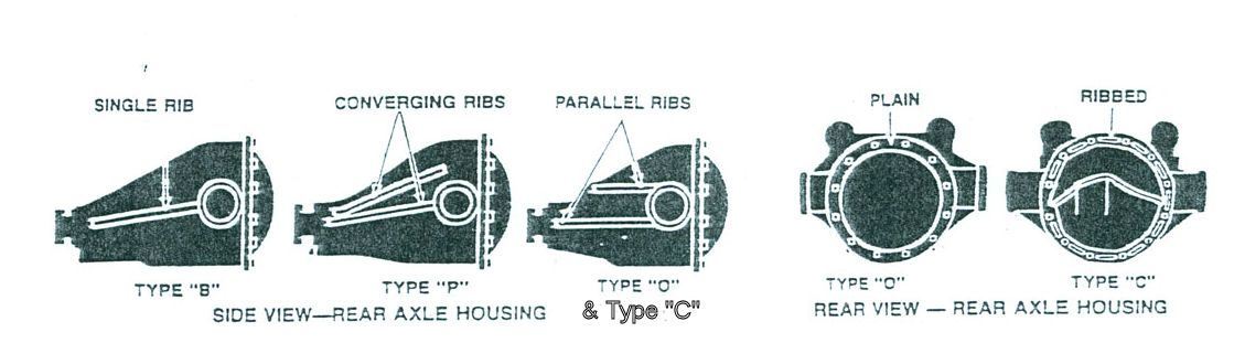

I always thought the wider trim was a '65 thing. Hmmm The standardization plan (since about 1938 ish) was like a steering gear box, differentials, wheel bearings, brakes, suspension, and a myriad of other stuff not related to body design. There's tons of stuff that interchanges, and me being the dummy I am, thought maybe I could make the trim work. Heck, I blew up a '70 GS rear end and put a 71 Monte Carlo 3:23 posi in it bolt for bolt.
Just sayin'. Bill

And yet, there were all these different rear axles that only shared mounting points and nothing else...
Of course, this is just the A-body cars. The full size used the 8.875" Chevy, the totally different 8.875" Pontiac, or the 9.3" Oldsmobile axle. The Impala used a three link rear suspension with Panhard rod, the Delta used a four link. The Impala used 9.5" brakes, the Delta used 11". The Impala used a 4.75" bolt circle, the Olds used a 5". Should I go on? If you think all this stuff is the same, knock yourself out.

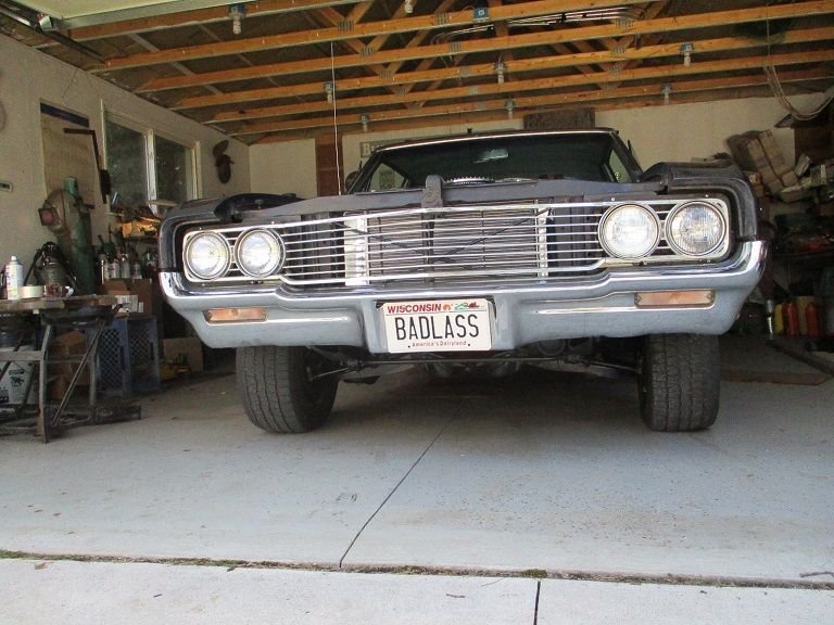

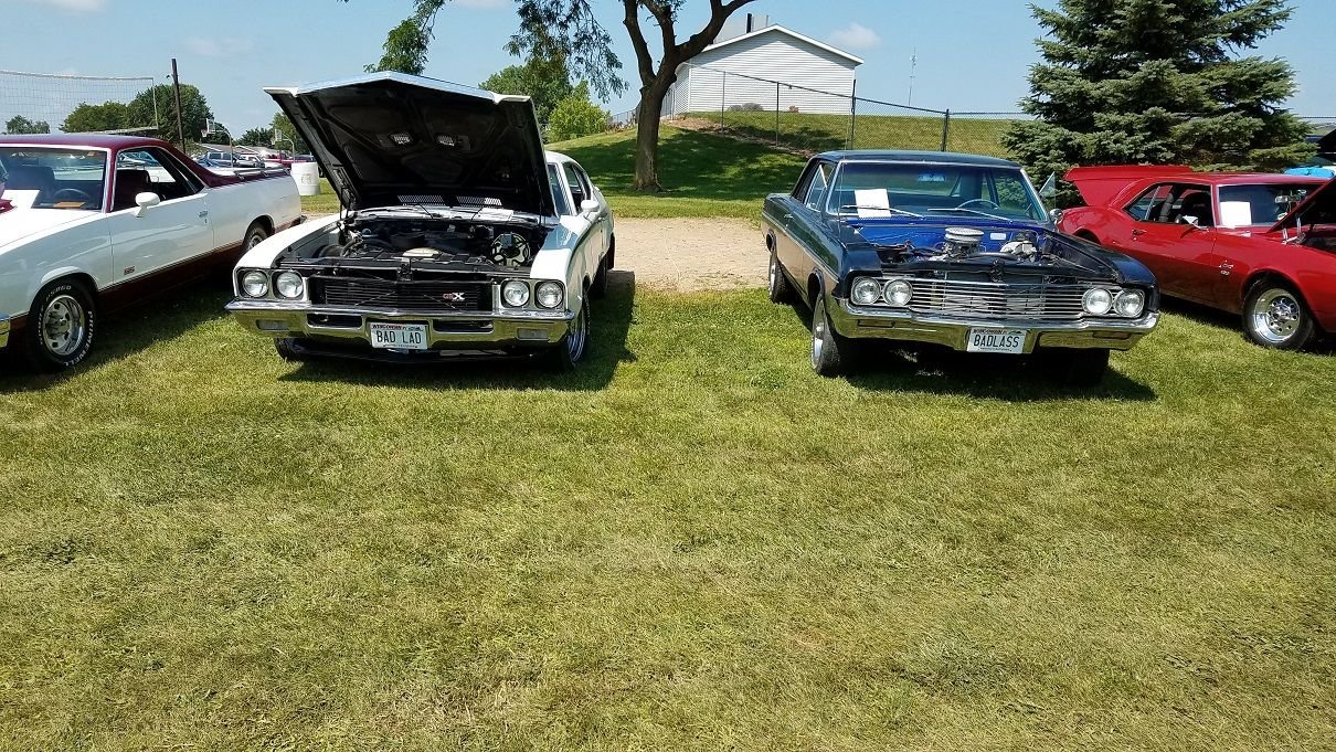

DANG Trent! What a comparison. That really explained the difference that I knew existed, but wasnt sure exactly what it was. I have a pal locally here thats in need of that fender. Still available? He's building an 8 second street 'Lark with an all aluminum 568 (?) Tomahawk motor. . His '70 white GSX was in the low 9's. Ill be happy to pass that along if youd like. How much??
Heres the front end of the BADLASS. I see the difference now! Im gonna take a quick look for his latest Lark pic... gimme a second... Bill

Hey Bill: That is one fast Buick! Yes, it took me a while to figure out the difference in the front fenders. It is such a small difference you have to line them up to see it. Once you see the difference in the bumpers, the fender difference makes sense. So to make a style change for Buick Skylark in 65, they had to make a new tooling for the bumper and the fender to make it happen which required a big investment for the presses for the new parts. Amazing. Then add all the other models and GM Divisions. Keep in mind that the full size GM wide got a new body redesign for 65, go they had a lot going on at the time. GM did a lot to make style changes. GM took the full size wagon body for 1970 and made Buick exterior panels (front clip and sides) for the wagon which was used only one year. Chevy and BOP all got a totally new wagon for 1971 with the clam shell - disappearing tailgate and rear window. Olds did not get a full size wagon for 1970 and waited till 1971 for their Custom Cruiser. Olds had the Vista Crusier called a bigger wagon and the flat top for a smaller wagon. Buick cancelled the Sport Wagon glass roof wagon for 70 and just had the Special wagon. Buick and Olds did not have a full size wagon from 65-69. Did Buick make that full size to just make up for cancelling the Sport Wagon? I am not sure, but it was more expensive than to keep the glass roof one more year. Amazing the money and effort spent for style like the small change in the 64/65 Skylark fenders.
