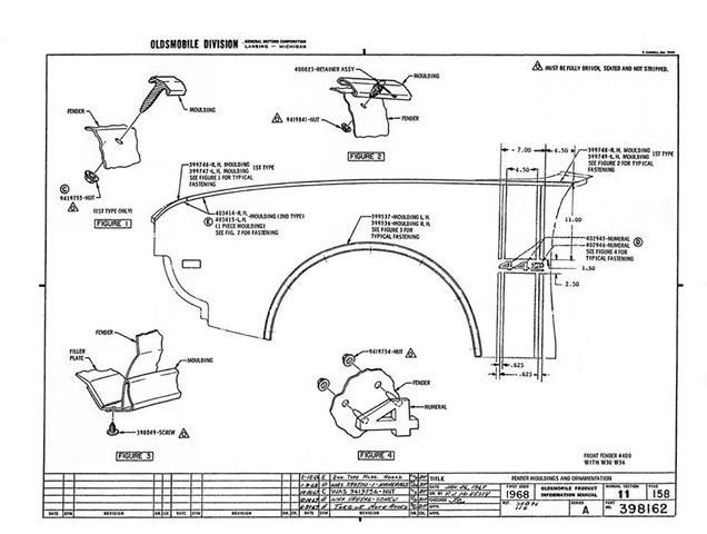

I'm getting ready to paint my 68 Cutlass convertible. The painter suggested that I could save some money by doing some of the work that could be done by me rather than at the shop rates. Stuff like removing bumpers trim and badges. Most of that stuff is straight forward and requires no special techniques, but other things require a little tutoring from someone who has done it before. First is the molding that spans across the back of the hood. I see no fasteners and it appears to be either pressed on or glued on. How can it be safely removed without destroying it. Next is the long molding that goes full length of the car on top of the fenders, doors and quarter panels. There are fasteners on the ends and clips for the rest. I have a couple of molding removal tools both metal and plastic. Is there a technique to popping those off the clips without damage? If there is some kind of video around, a link would be appreciated. Finally, although I really haven't looked at the way it is attached yet, how is the long curved molding behind the convertible top fastened and are there any surprises back there. All of these parts are in excellent condition and this all original survivor deserves to keep as much as of it original bling. Of course, any help or advice is greatly appreciated.

Do you have the cast chrome ends on the front fender trim? Remove that first. Or at least remove the nuts. Work the trim off starting at the front by the cast piece. Dont let it hit the floor. That will bust off studs and obviously damage the finish

Do you have the cast chrome ends on the front fender trim? Remove that first. Or at least remove the nuts. Work the trim off, starting at the front by the cast piece. Don't let it hit the floor. That will bust off studs and obviously damage the finish. Like Joe said, the nuts are hard to reach with the fenders on the car. In fact, you may want to start the trim removal operation with the fender on a table.

As Joe said, the front fenders are better done with the fender off the car, especially the nose trim. The rear of fender windshield trim pretty much can't be removed without the fender off the car. Fender emblems can't be removed unless the fender is off the car
