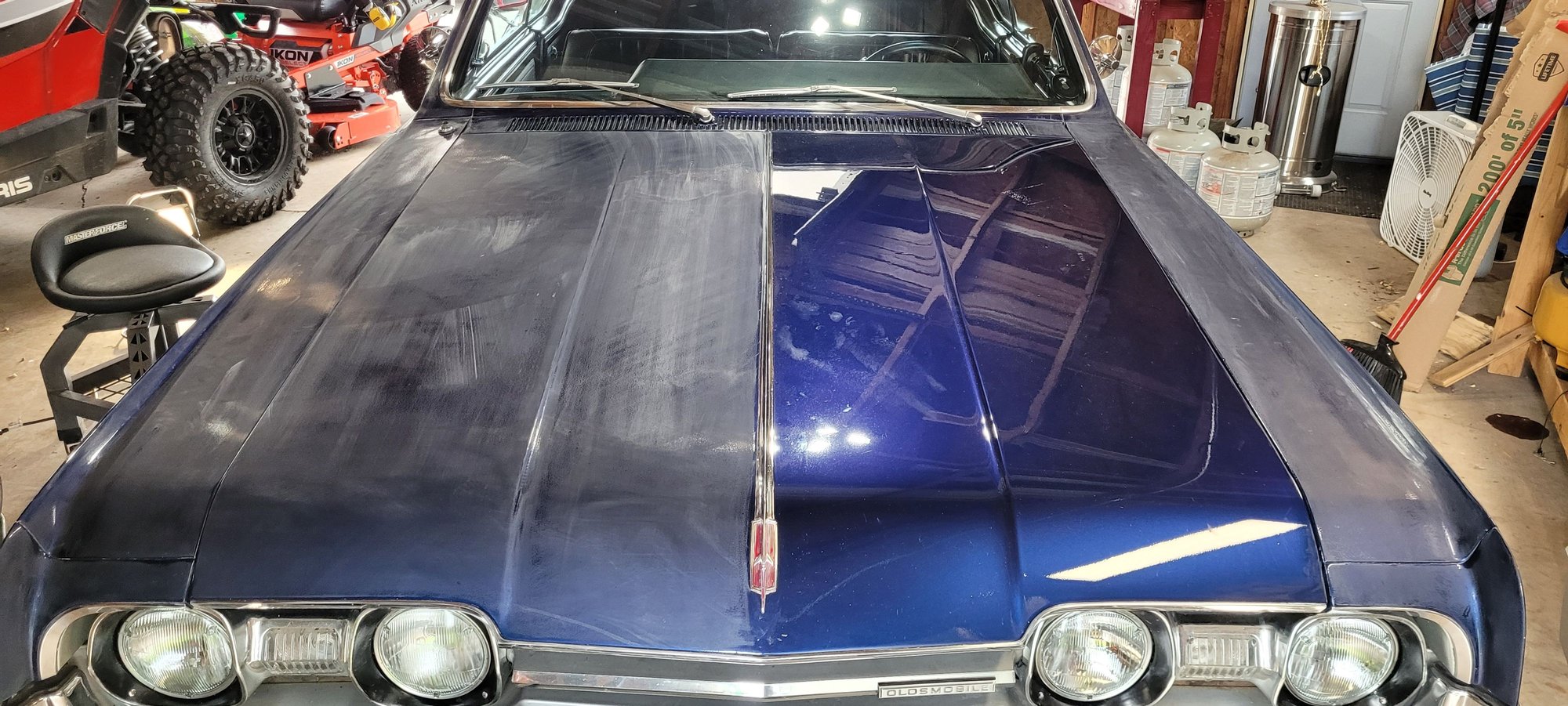

As some of you may know, I purchased my 67 in Jan 2024. A previous owner made it a flip - slapped some "cool" parts on it, threw on a back yard base/clear coat, etc. Needless to say, my first priority was to go through all of the systems first to make sure it was safe and reliable.
At some point last summer, I thought it would be a good idea of touching up some of the chips (mind you, I freaking HATE doing paint and body work. LOL). Then I got "carried away" and decided to use that 1,000 grit (wet) sand paper and smooth out part of the hood. Which resulted in me going "what the hell did I just do!?!?" LOL
This photo shows (on the left) how the paint job looked when I bought the car and on the right was my first attempt and blocking the clear. I am learning on the fly and am getting better at it and learning to know what to look for. I know I'm not going to get it perfect because the metal/surface prep was not done right. Just trying to make it a better looking daily driver than it was when I bought it.

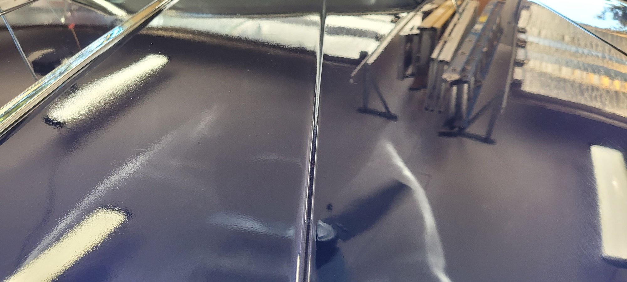

These two photos show how the right side of the hood looked about a month ago when, after an off season of reading and watching "how-to'" videos. I applied what I learned and fixed what I had attempted the Summer before. The top photo shows what it looked like after I used Meguiar's Pro Speed Compound. The bottom photo shows how it looked after the compound, then Mirror Glaze Swirl Remover and then Deep Crystal Carnauba Wax.

Next up was a stop to Menard's to get a 7" polisher and (another) trip to Amazon to buy a couple of Meguiar's Soft Buff Rotary Foam Cutting Pads (which were recommended on the bottle of Pro Speed Compound).
Then last night I tackled the hood and the trunk lid. So this is using the polisher (instead of the DA) and using the cutting pads. This was the initial pass. The "shine" isn't the best because (1) I know I have to go over some spots again and (2) I just wiped off the residue, I didn't clean it before taking the photo. I'm 10.5 hours into the project/process. Now that I'm starting to see some results, it is giving me confidence and removing regret that I did this, especially since we are going to the Iola Car Show next week Thursday-Saturday.

24 hours total, not including wax.
Is it 100%? Nope. But it looks better than before. Now it's time to get out and enjoy it!

Thanks a lot! Unfortunately, the person that sprayed it didn't do it evenly. There are dry and thin spots here and there, that don't show in the photos. And because of that, there are spots that I wanted to get to look better but I couldn't because there wasn't enough material there and I was starting to burn through. But overall, it's now a nice looking car at 5 feet away instead of 20 feet away. LOL
