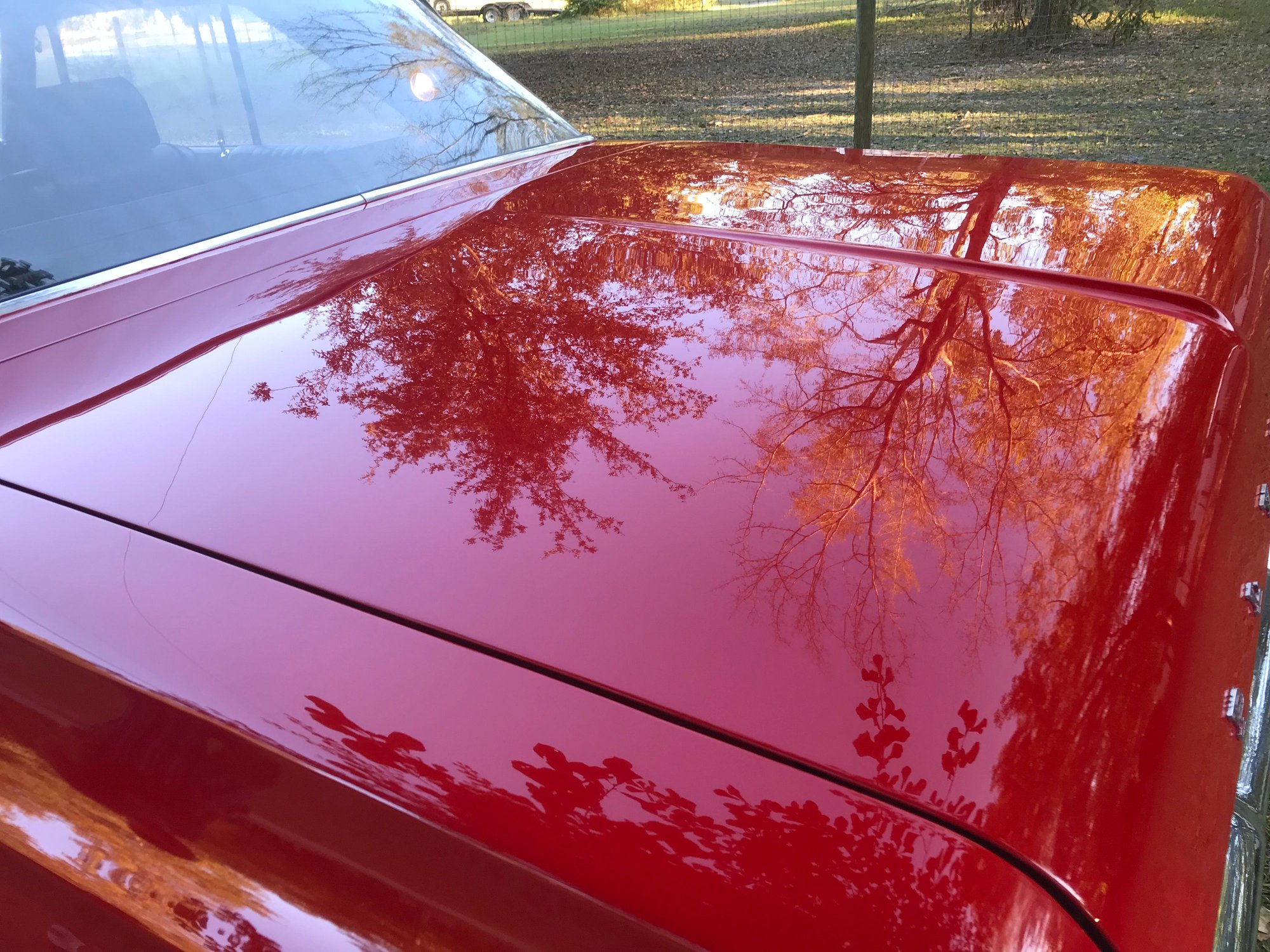

Five coats of lacquer, no clear, sprayed out in the yard, 50-50 mix paint and thinner. paint was over 500 a gallon and it took 2 gallons with just a bit left.
Looks really nice. Whuuut? Did you say $500. a gallon???
Yes 500, not cheap for sure and because its red it costs more than the Gold I got for the wagon.
