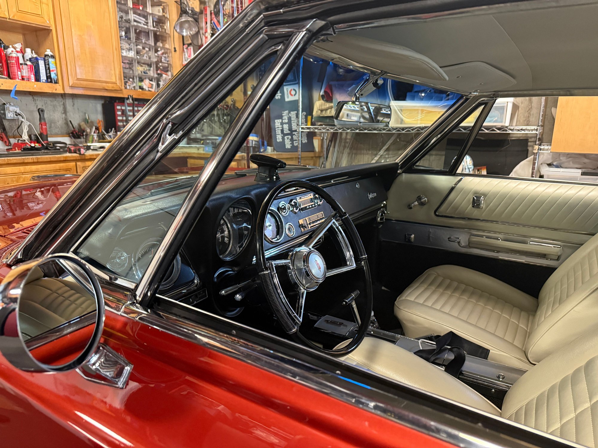

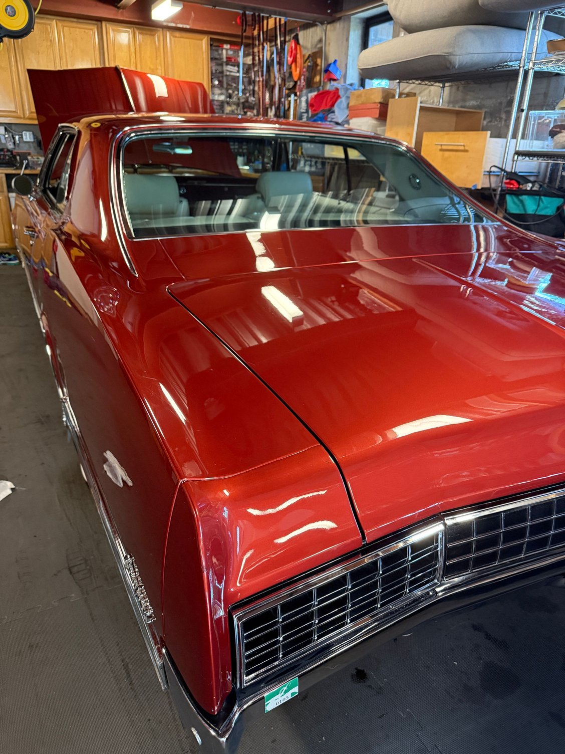

You guys and your pictures. Snapped a few before heading out of town.
Autumn Bronze '66 Starfire, just shined up.
No, those OAI pipes are not even close to factory. Covid-boredom project. Fun, but doesn't seem to make much performance or economy difference.
SMS in Oregon did the door & quarter panels. The sharp-eyed among will see the '69 Strato buckets installed for the safety of the seat back locks which the '66 seats didn't have.
'66 Starfire mostly stock factory autumn bronze redone in 1998. Neither my wife nor I liked the red interior so we went with parchment. It was supposed to be parchment pearl, but we didn't like that either. I got the car in the late '90's with a ~1970 455, so I'm not real worried about originality. I just wanted it to be fairly true to what Olds was building in 1966.
Well, except for HEI distributor, front disk brakes, 800 CFM qjet and internally regulated 10SI alternator. Oh, and the stereo. And oh, the glove box 02 sensor. And oh 15x8 wheels & tires with Ch*vy fake wire hubcaps.
Does that make this a mild custom? I don't think so, but maybe so.
