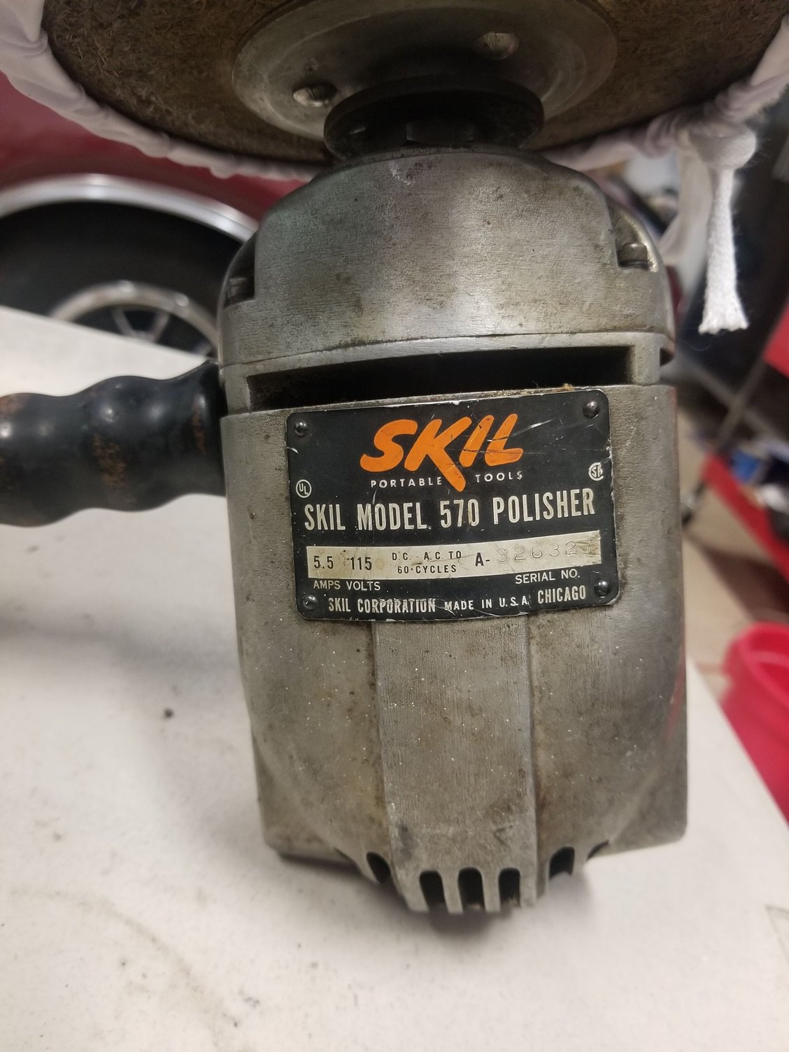

I got my car back from having the hood repainted (BC-CC) and blocked it out and polished. I had the B&D buffer for years and always used the foam pads but decided to dig out a really old Skill buffer a guy gave me, probably from the 50's, with a wool pad. The Skill buffer has only one speed which I assume is the best one for buffing. I looked online and there is no information that I could find. I was wondering what RPM it had. At any rate the wool pad worked really nicely, maybe better than the foam. So I began to wonder what others experience was. Also I was too aggressive on the sanding and had some scratches I just couldn't seem to get out for fear of going through the clear coat. I remembered I had a MCQuires scratch remover and tried it by hand with no results, so I went with the buffer and wow! What a great product, it took care of everything and looks great. I have been using 3m products but wonder what other products are folks really happy with?

you can't go wrong with either product really, they've both mastered the car polishing product line. what you have there is just foam pad polish in the 3m product B, it has no grit to heat up the surface fast enough, without burning through the clear. proper steps of buffing are to start with the wool pad first with compound 3m product A, not seen in this picture but is the same color bottle. the combination of friction between the wool pad, and the grit in the compound work together to heat the surface of the clear coat to remove surface scratches. then using what you have there, 3m polish B with the foam pad to get the swirls out. 1800 is the rpm i buff at with my dewalt.

I watched some youtube videos when I first got my car back from the shop two years ago and was thinking that 2500 was what to go with. That said, the old buffer seemed slower and I liked the job it did so thanks for saying the 1800. I'll stick with that. Also your comment about using the wool for compounding and foam for polish. That's good to know. I have gotten pretty damn good at this, but trial and error cost me a few pads as well as other products. I should have posted some questions long ago and saved myself some T & M.
