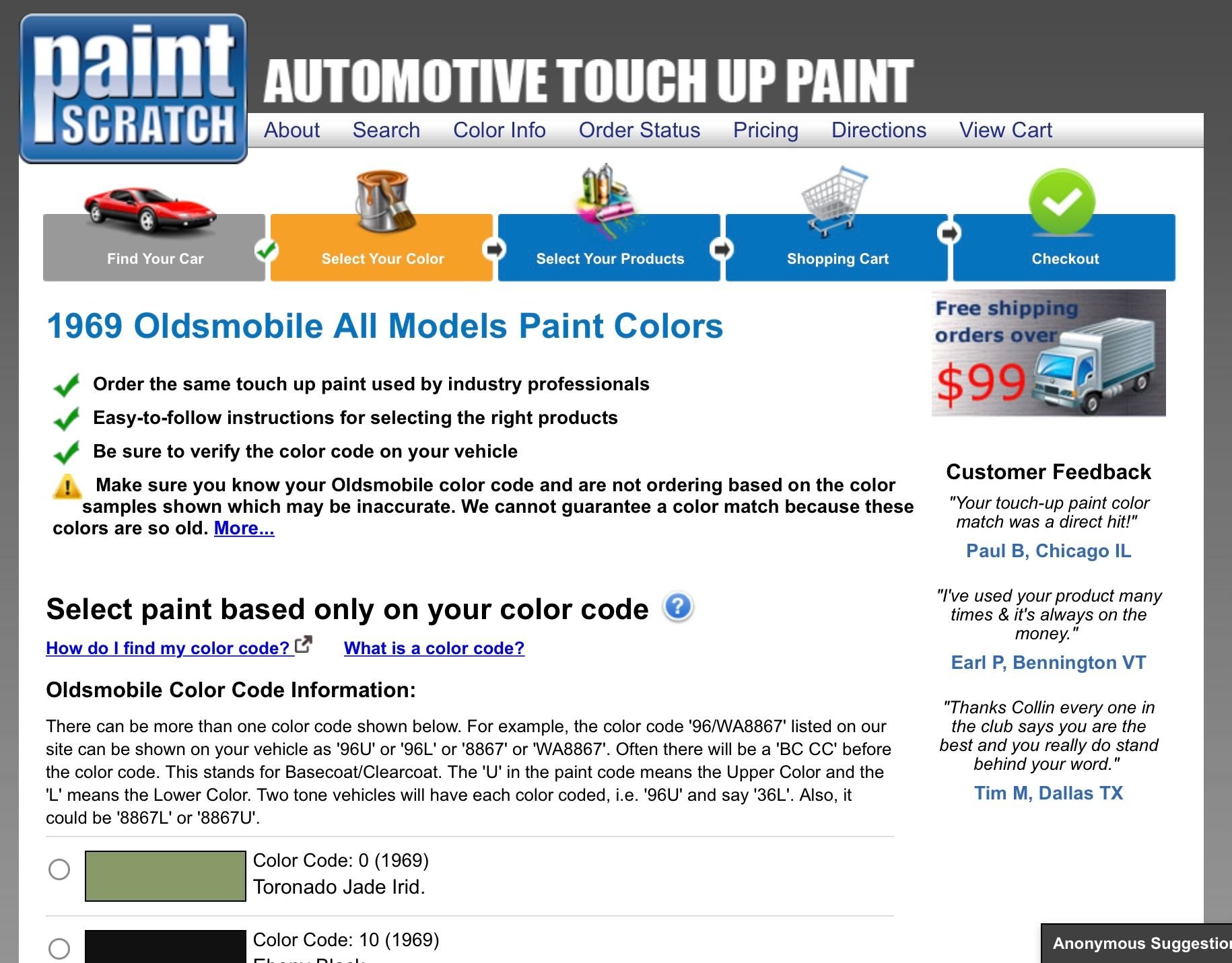

Maybe a place like could help if you dont have a local auto place that mixes paint…i have no experience w this place

Old Jan 25, 2022 | 04:50 AM
