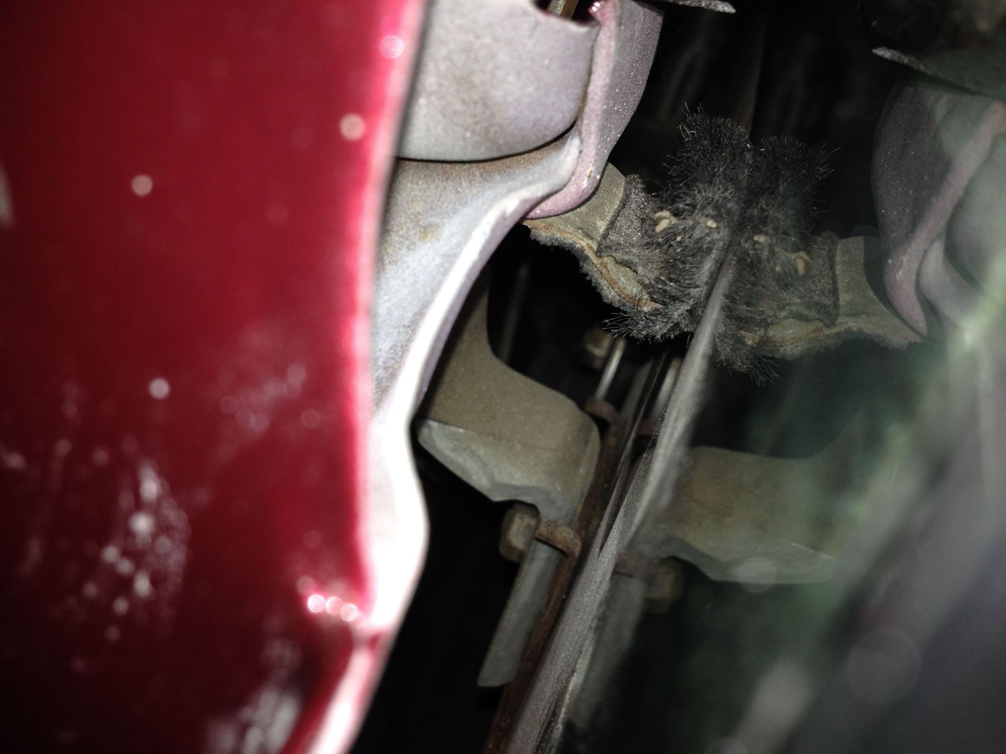

It's going to go back near the lock **** area and as you roll up the window you will see the part mounted on the window mechanism that hits your bracket. If you have not gotten it before tonight when I get home I will post a picture for you. Could not get to it yesterday.

It's not in my book but on my 72 it looks like they bolt to the window mechanism at the bottom and go up and down with the window. One in front one in back.

My weatherstrip is not installed so that's how I got this shot

I see. Thank u very much. My body guy already installed my weather strip. 😝He is in a hurry. Body panel is not installed so hopefully we can still install it with out taking the stripping off.

door panel off is fine. Weatherstrip will not be affected or in the way. Good luck.

You should have two extra bolts and washers too.

Yeah!!! Got it fixed. Thanks guys!!
